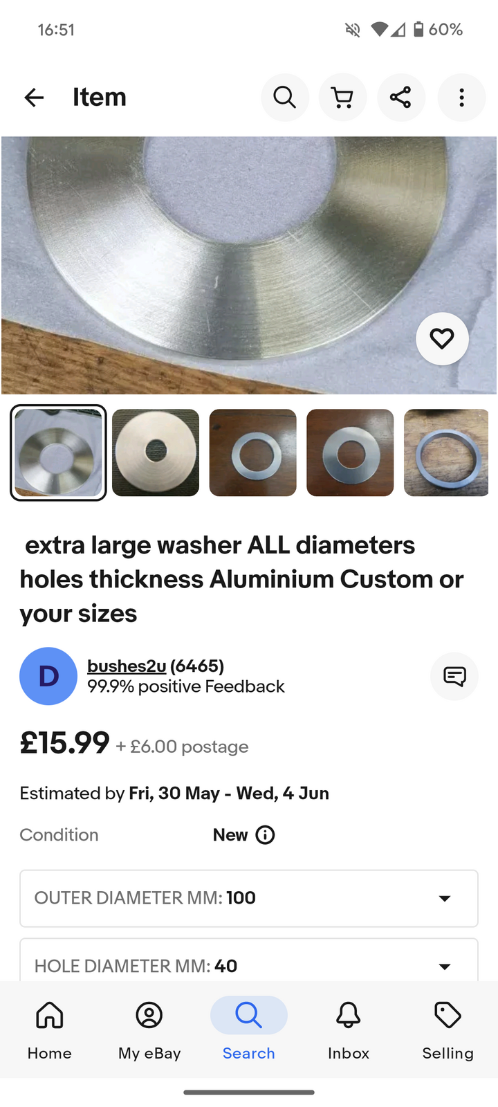

Any way to reduce hole on vanity unit for basin waste fitting?
Then you'll need a flange/washer to both cover the enlarged hole and act as a clamping down flange for the waste fitting assembly to grip upon.
Thats what I was thinking but struggling to find any products which would be able to fit the pipe (38mm) fairly snuggly so the back nut can tighten onto it whilst the rest of the plate/flange is wide enough so I can secure it to the vanity unit (hole size 75mm)

Came across this. Sizes should work. I was hoping to find a plate/flange which I can screw onto the underside of the vanity so wondering if this and using ct1 or the like to hold it in position could work?
