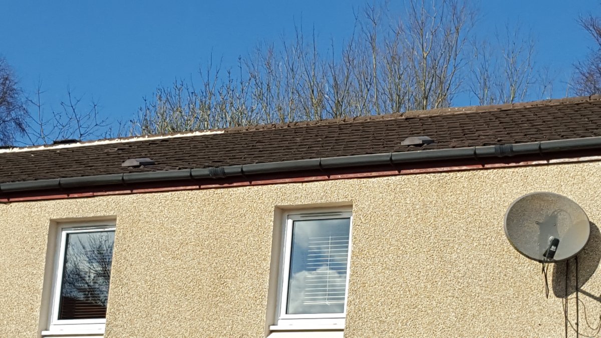

Anybody know what these vents (?) on the roof are for?
30 Sep 2013
304
6
Lanarkshire
Hi all
I have bought a new house, I don't get the keys for another few weeks though so haven't moved in. I'm just wondering what these vents (I assume they are vents) on the roof are for. It is a terraced house but none of the other houses in the row have them. Also, the home report mentioned some staining and condensation in the loft so I'm wondering if they are anything to do with that.
The vents let air into the loft to help prevent condensation.
Ideally you would have vents higher up also to let air out.
They may have been fitted when and if the loft was insulated ie switched from a warm to a cold roof. I take it there is not a loft room?

Hi graeme, thanks for the info. Excuse my ignorance but I take it the fascia boards is the board below the guttering? And the Ridge tiles are the tiles at the point of the roof? The home report didn't mention any of these, is there much involved in getting them done and is there any urgency in this?
All the home report mentioned was it is still the original roof ( house was built 1975) and that there is staining and condensation in the loft, which by the way I have not been in but I believe it is just a loft space (not a room).

Hi,
Yes the fascia is the board behind the guttering. It looks like wood which needs painted. Eventually it will fail and the guttering could come loose.
Yes the ridge tiles are the ones at the apex of the roof. They are held on by mortar that looks weathered. Eventually it will fail and the ridge tiles could blow off hitting something below and letting water into the loft.
Neither is a massive problem just a maintenance issue.
You might find that the vendor installed the vents due to condensation issues.
If it were my house I would just keep an eye on it and look to maintain the other bits when you have time/money.
