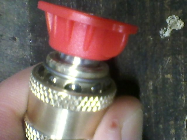

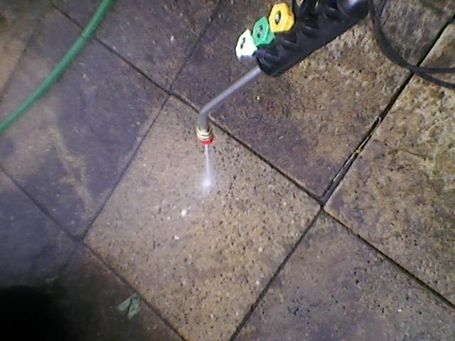

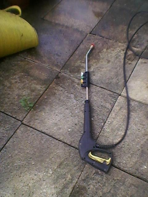

Thus far, I'm impressed with the lance. As soon as I pressed the trigger, the fine high pressure jet is exactly what I want for the paving gaps.
The jet nozzles are locked into the lance by a spring collar, the nozzles not in use fit in the pocketed sleeve on the lance's stem.
I'll see how it fairs after a few hours intense work and give feedback although in my current opinion, it out classes the lance supplied by Karcher.

Used the lance for 3 hours today and it worked perfectly. The needle jet nozzle does a fine job of cleaning out the paving gaps. Probably even better with a higher pressure washer. My Karcher 2.14 is 100 bar.
