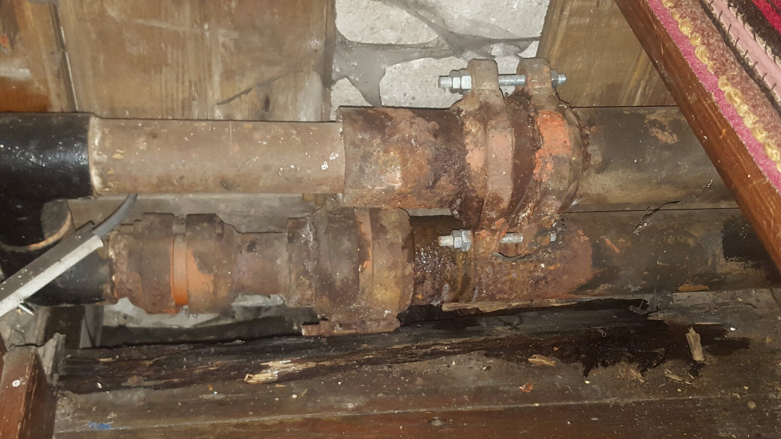

Anyone in S Cumbria want to tackle this little gem - ancient church heating system leak ?

On the upside, without the boiler running at all, I was able to determine that there is a leak. At one point there was a significant drip from the ballcock, but it did seem to reduce after a while. Had a good look round, including moving some carpentry for a better look, and found this gem
To the right is a pair of 3" (or thereabouts) pipes that run along the bottom of the wall. To the left, the 2" pipes join together - and since the fan-coils were fitted then converts to 22mm copper.
My thoughts would be to cut the 3" pipes back a bit to clean metal, find compression fittings a bit like the ones in the picture and go straight to copper, binning the short bit of 2" iron to the left. Not planning on trying it myself - apart from lack of time, my insurance doesn't cover any form of plumbing (would double the premium :eek:).
Anyone in the S Cumbria area fancy tackling it ?
