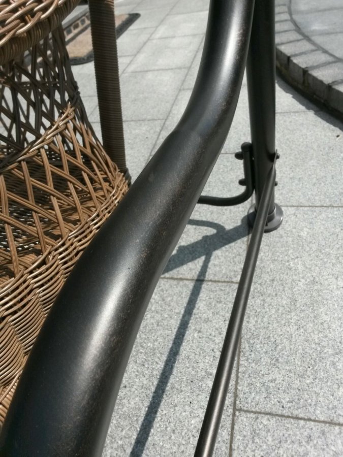

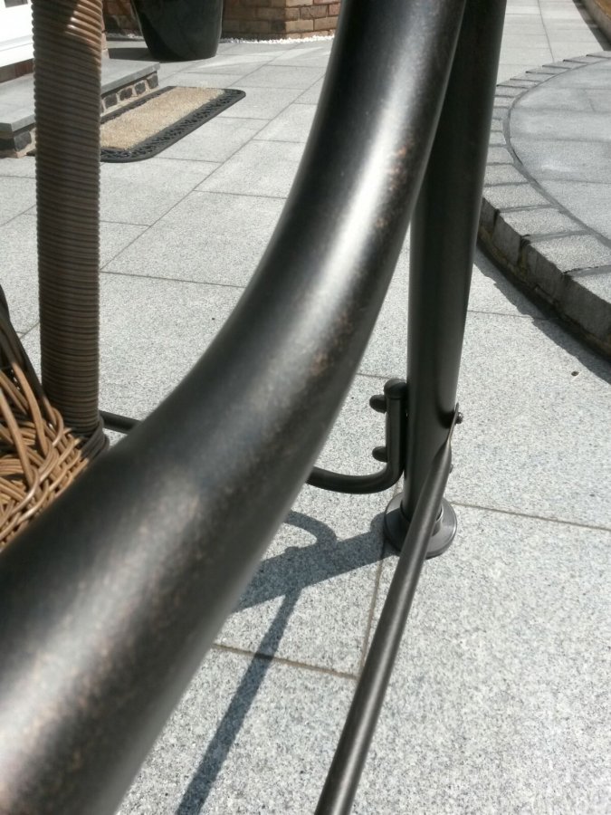

Hello,
I was wondering if anyone could help me with how to do the effect shown in the pics bellow?
Someone wanted me to paint their outdoor gate railings and I was going to use a Dulux Metal Shield paint system on them, but then today they showed me a swing that had the effect bellow and they wanted me to try and get the same effect on their railings.
It looks like copper and black. I was thinking that maybe it was achieved by first painting the metle with the copper and then maybe spraying the metal with black paint?
-Id rather not spray the gates though because Id need to buy a spray tent (I have a airless Wagner spray machine) and one of the gates at the house is about maybe 14ft tall so I wouldn't really want to take it of to try and spray something that big as I am new to spraying and there is a lot of nice masonry bricks and paving around the gates which I dont want to get paint on.
I was wondering if maybe I could achieve this effect by just using brush's and first prime the gates with the Dulux Trade Metalshield Zinc Phosphate Primer, then put a patchy cote of copper paint, and then maybe getting the black Metal shield gloss top cote paint mix it with lots of white spirit (30 % white spirit / 70% black gloss %??) to make a type of translucent glaze and then give the gate 1-2 cotes of this glaze mix so that the cooper could be seen through the finishing glaze cotes?
-I'm guessing that would possibly ruin the Metalshields durability though and it would maybe fail and clack and peal a lot sooner than normal? (the person whos house it is will prob get it redone after 3-4 years even if I were to just put on the Metalshield without mixing it with white spirit though anyways...)
The second way I was thinking to do it was to put on the primer, then 2 cotes of the black Metalshield (without mixing it) then put on the copper in a random patchy way, then put on a glaze cote (mixed white spirit with Metalshield) this way the gate would have the normal primer and two cotes for the normal protection, and at the same time have the effect the customer wanted?
anyone know if this would work or a better way to do it?
