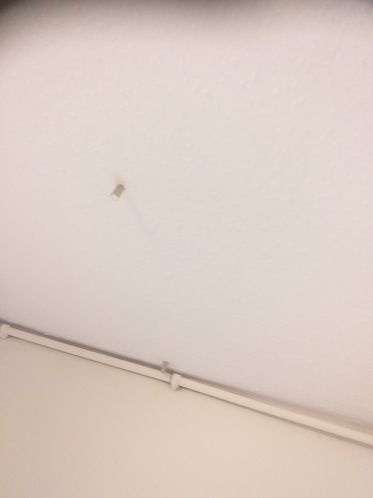

I ran the magnet along skirting until it stuck . It seems roughly 16 inches apart. I guess this is where the stud runs upwards? I was going to push the gimlet (in photo) into wall to see if there's wood.
I couldn't get the magnet to stick running it up the wall though, just on the skirting.
These two magnets are 16 inches apart on ceiling. Joists?

If you find say a nail in skirting would you then run the magnet up the wall to check for fixings directly upwards?
How do you know if a wall has studs or ceiling joists? I mean some are just plaster on brickwork arent they?
Yes, basically. When you are installing skirting it's generally a good idea to nail where the studs are. The difficulty is that some nails will inevitably be into the wall's sole plate as well and in the case of MF (metal) studwork the pins will often not indicate anything, being skewed in to hold the skirting in place only until the grip adhesive has gone off
All stud walls have studs (uprights). The issue is spacing. Many builds use 400mm (16in if older) centres for studwork, but 600mm centres aren't unknown. Ceilings, on the other hand, especially if they are just false ceilings, can be joisted out on 600mm centres. In modern builds, where composite timber joists are used, these can also be at 600mm centres. Older/more traditional builds with timber joists tend to be 400mm (or 16in if older) centres
What we have been discussing so far is stud walling. When you get into plasterboard applied to masonry directly there is no such thing as spacing because the boards are fixed to the masonry using dot and dab (a sort of mortar/glue material) or in recent years by an expanding plasterboard foam. That type of wall requires completely differing fixings and a different approach. Unlike stud walls these don't sound as hollow when tapped
If it's a wall with plasterboard attached to brick for a strong fixing do you need those long fixings which go through plaster board into brickwork.
I have a flat built on 1970s. I guess it's all plasterboard attached to brick. It's a top floor with flat roof so guess it has joists though
Plasterboard is rarely attached directly to brick (although it's not entirely unknown) - where it is used onto brick the two main ways are dot and dab (or these days sometimes plasterboard foam) and battens (generally 2 x 1 softwood battens packed off the masonry and fixed to it with plugs and screws) although sometimes you'll find full size stud walls instead. With directly fixed you just treat it like a plastered masonry wall (drill, brown or red plug, screw). With hollow walls if you can sometimes drill through the board, then into the masonry behind it and then insert a plug on the end of a longer screw - but this won't work if the dot and dab is extremely deep or the boards are onto full size studs rather than thin battening. If the void is sufficient you can always use some form of hollow wall anchor instead, depending on the weight to be carried
Some (interior) walls will almost certainly be timber stud with plasterboard (not metal frame as this didn't really take-off in the UK until the mid 1980s or later), others could be wet plastered straight onto the masonry and there might well be timber battens or studs onto masonry and plaster boarded as well. I didn't think that something built in the 1970s could be dot and dabbed (if original) - didn't dot and dab come-in the 1980s as well? The other wall type you can find are those gawd awful Paramount partitions - two layers of plasterboard with cardboard "egg box" core. They betray themselves by how thin they are - much thinner than stud or block walling can be. Your ciling could be directly fixed to the joists although cross battening or suspended timber frameworks are not unknown, either
