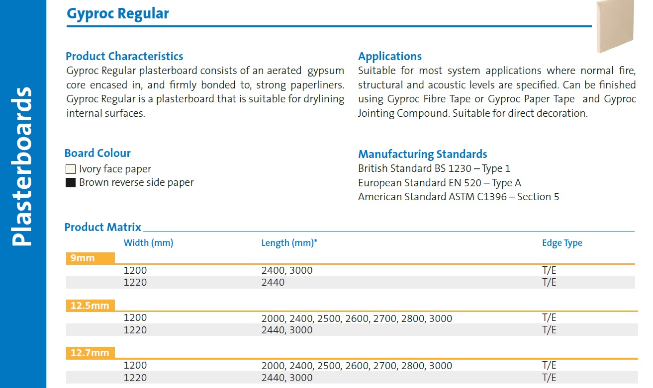

Plasterboard is usually 1220mm, so 610mm centres is also seen(because that's 2 feet in old money).
If you find 400mm centres, that could still also be 16inches instead(very close to 400).
Sorry mate, but plasterboard has been 1200 (not 1220) ever since we metricated in the 1970s (and did that every mess up the guys who used a folding, non-metric rule back then I can tell you!). Can make quite a difference to finding stuff (or not) over the distance of a wall
Gyproc still sell both...
I have many times seen plasterboarders trimming 10mm off each side of boards with a surform to match what the carpenters have built. Maybe it's a regional thing?
But, I did balls it up, yes:oops:. I guess "usually 1200, but can also be 1220" would be the right way round instead. The main point I was getting at is that it's nowhere near as "standard" as it ought to be!
More likely that it's a batch of export sized boards that had been dumped on the local market when an export order fell through. The problem is that Gyproc aren't the only game in town. For example there's Knauf (German)..... OK, granted that for the right quantity they'll make you any size you like, but the oddball sizes do tend to be used on more large scale buildings (hotels, conference halls, shopping centres, etc) than domestics
Agreed that it ought to be the standard, but TBH I cannot recall any wall I've framed-out (and in many cases clad with plasterboard) since the early 1980s being on 16in centres - it's pretty much all been 400mm. On the other hand I have more times than that had to add-in additional timbers to carry boards when some muppet has put-in framework on 16in centres (and the boards were 1200...). And that's all over the midlands and north. Hence my comments. Even my local builder's merchants (who were near incredulous at my request for taper edge boards and collated screws as recently as 1992 - they didn't stock them) were selling only metric boards as early as 1987
