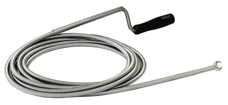

Had a bit of a blockage in 2 - 3 inch waste pipe run under wooden floor. Guess it's about 4 mtrs long with a couple of elbows.
Washing machine waste water backed up and spewed up water out top of pipe, have dismantled it down to floor where i plan to feed coiled wire and give it a good jiggle or whatever the term is.
Have been semi successful with scalding hot water and a plunger after about a very tiresome hour made some progress but not confident it will last.
The ones i've seen on ebay that i'm interested in are 5m x 9mm and are less than a tenner delivered. Anyone tried one and do they work or do they just fold up too easily? Any advice welcome peas. Maybe you've a better idea? Have tried to add pic of product but can be found here for full description. http://www.ebay.co.uk/itm/5m-x-9mm-...413831?hash=item3f6bda6287:g:3u4AAOSwLF1X6pPT

I've used that twisting style unblocked with some success on a shower waste, but the bends/elbows proved difficult to navigate. As suggested, a wet vac is better, and it has further uses.

If you can get a curtain track down the pipe, by all means give it a go. If you can rotate it at the same time, even better as this will scrape the crud off the walls of the pipe. Curtain wire may get along the pipe but if all it does is poke a hole through the obstruction, you wont achieve much. If accessible it may just be easier to either cut into the pipework and fit some cleaning eyes when you rejoin it, or replace the lot altogether. I'd also check where it joins the stack, and make sure the pipe hasn't been pushed too far in so it is abutting the far side of the stack inside.

I have a wet vac so would be giving that a go, but the old fashioned way of doing it was a curtain wire down the pipe. I remember my Gramp unblocking their kitchen sink with a piece of wire 40 years ago! My only concern is rather than just piercing the blockage, you really need to be digging as much out as you can, if the end of the wire can be made to fill as much of the bore of the pipe as possible then so much the better.
