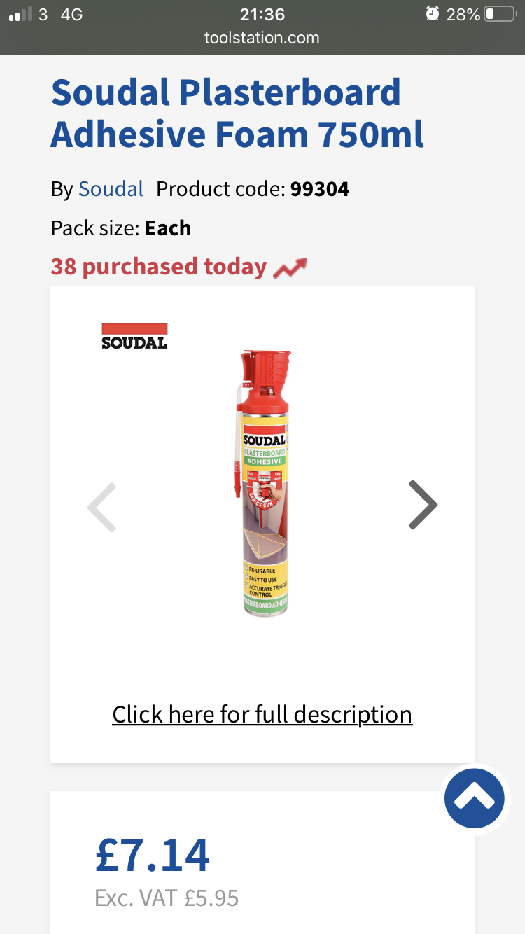

I think I’ll try the foam with the blue boards, sealed around the edges. Thanks very much (y)
Would you recommend a specific foam?
This stuff:
B&q sell foam gun for £10. It's metal and in the building section near plasterboard vs the decorating section..
Much more control with that.
A can of foam cleaner to..
Some just use those cans without the gun fine though especially with the board but just pointing out.
Dry fix from everbuild is one for board , I've used all sorts fine though. Not much much in it. Just foam
