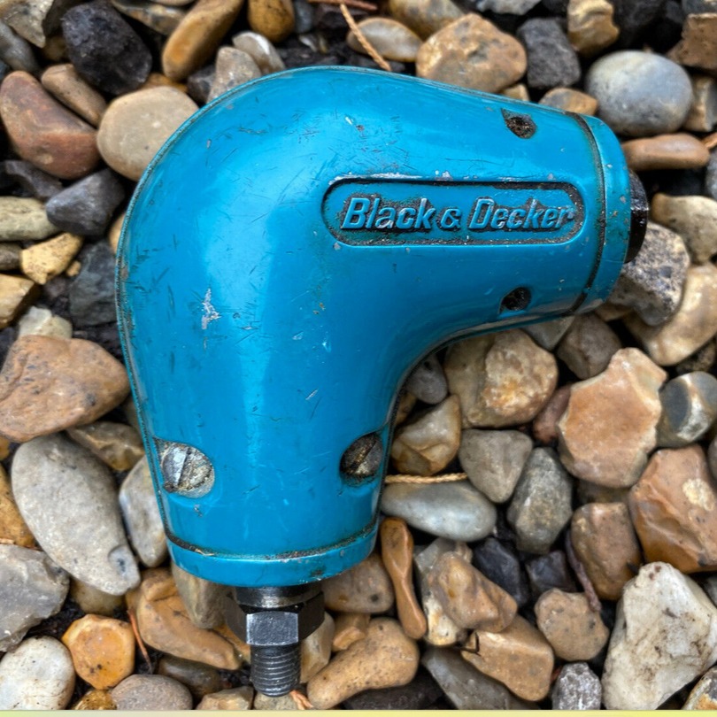

It's a rather tatty 1970s/1980s period B&D angle drilling adaptor. Metal gear teeth, cast metal housing. Somewhat overpriced at £35, IMHO - I saw a better one, still in it's box, on our local flea market last week, on offer for a tenner, The downside is that it needs to be mounted on a B&D drill (because of the odd-size threaded shanks), but they can often be picked up for £10 to £20 in working order, if you look around. The gears inside these are pretty small, so I wouldn't use it with a large 1/2in chuck, an auger bit or a spade bit with a threaded start, you'll possibly end up stripping the gear teeth. Rather go for a traditional plain start spade bit, such as the Irwin 4x:

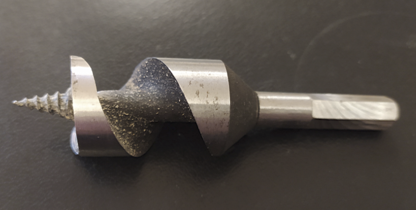

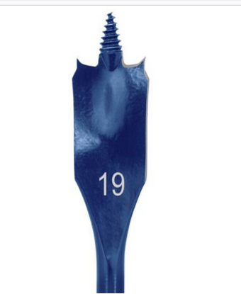

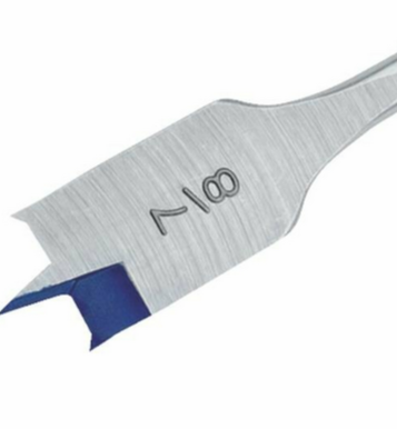

Above: Bosch threaded start spade bit - I avoid this type of bit
Below: Irwin plain start spade bit - can be steered into a cut
B&D did apparently try to cheapen those angle drives by making one with a plastic body in the 1980s. I believe the resulting product was withdrawn because the casing used to flex causing the gear teeth to disengage and slip.

That's why spade bits with a plain start (as opposed to a threaded one) can be a better option. A plain start drill can also be started off at 45 degrees or so to the joist and rapidly turned into the cut (i.e. perpendicular to the joist). Modern impact drivers are good for this because they are so short (my current 18 volt Makita is just 111mm nose to tail) - which means that with a 1/4in hex shank spade bit (about 150mm long) I can get a hole drilled through a 2in joist where the joist spacing is about 200 to 220mm (another reason there's little call for adaptors?). Another thing about auger bits is that people always seem to drive them too fast (rotational speed). They cut far better at low revs, especially the bigger sizes - far slower than many 2-speed drills have as a minimum (think about the speed a brace was used at and how well they cut).
Auger bits can't be steered into a cut anyway near as easily as plain point spade bits, even if you resort to grinding the threaded start down to being just a plain point

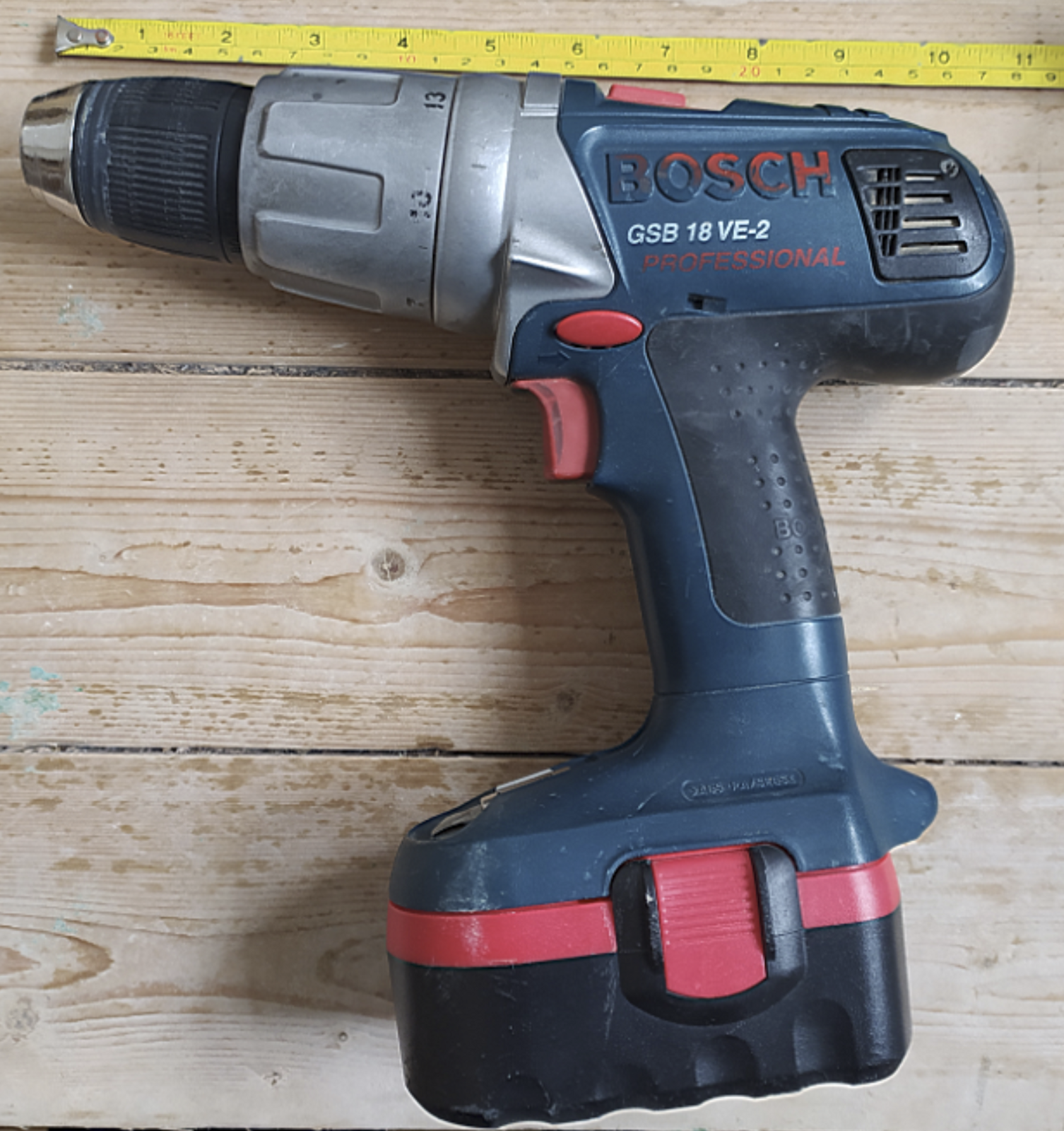

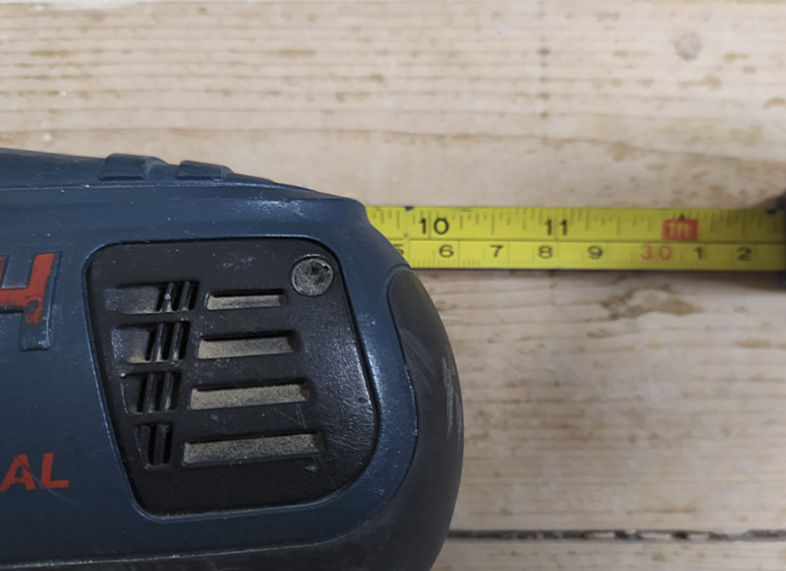

You say your Bosch is 250mm long - that's a ruddy big drill. Too big for joist drilling IMHO. My main drill is a Mak DHP481, and is about 205mm long, but that's srill too big for a 250mm joist spacing. The various impact drivers I've had were always a lot shorter - between 111mm (the current DTD173) and about 139mm (my original 18v BTGD145 from c. 2011). Chuck a 150mm plain start spade bit in that and rotate the bit into the cut and you can achieve your holes without the need for an angle drill. I see plumbers doing this sort of thing all the time

Thanks. Just remember that you'll need a plain start spade bit (e.g. Irwin X4 style) with a 1/4in hex shank (or under a tenner)

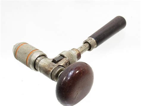

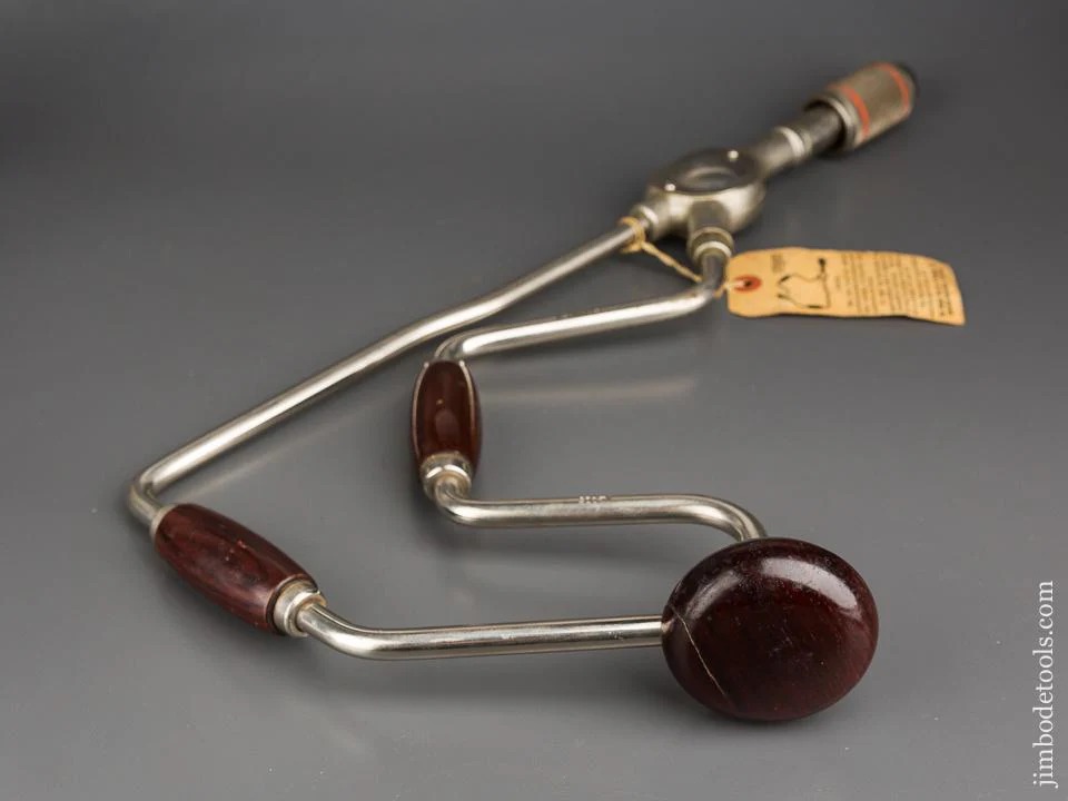

That's a corner brace, note the flat part of the pad so you can get them in tighter to a floor or ceiling. They were designed to be used with centre bits like these for drilling joists:

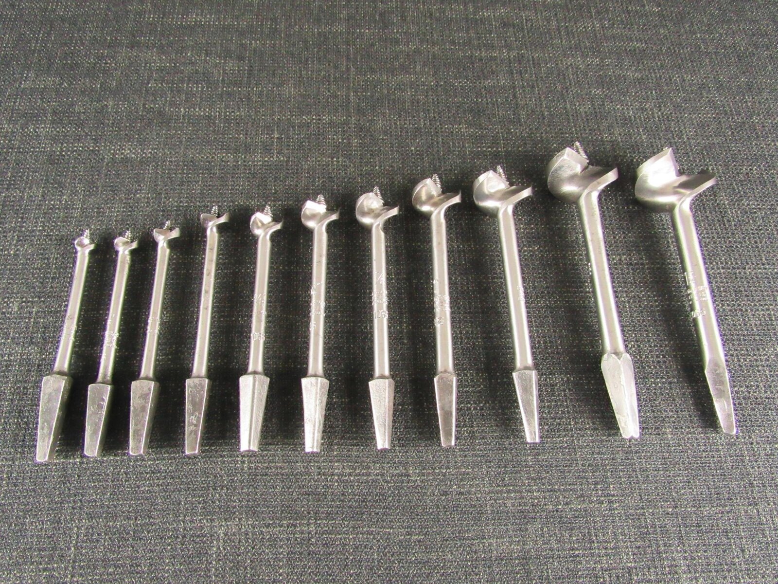

You sometimes see them on car booters and flea markets. I still have mine somewhere (a Chapman, I think), plus a roll of Ridgway centre bits. They were incredibly slow to use and if you were in a hurry you'd always end up barking your knuckles. There were even specialist braces for drilling tight to the wall at speed, called corner braces, although I never possessed one:

But we forget about hand tools.
I don't. I do a mixture of modern work (refurbs. rebuilds, new extensions, etc) and work on listed buildings - often both in the same site. Some of the on-site repairs I undertake require tools of the same era as the building, so I have an eclectic mixture of modern stuff (lasers, plunge saws, cordless tools, Domino jointers, etc) and historic tools such as these:
Just seemed drill sized when I bought it.
Actually it's 260

Actually it's 260
I put it down to shrinkflation - the way drills keep getting smaller every year whilst the price never goes down...
In the Makita universe the equivalent drill (18v NiMH) morphed into the Li-Ion BHP453 (250mm long, about the same size as the NiMH version), which was replaced by the DHP45 (225mm long), which in turn was supplanted by the brushless DHP481 (205mm long) which in turn has been replaced by the DHP486 (178mm long, about 82mm shorter than yours - a difference). That's a shrinkage of 72mm in 19/20 years. At 178mm you could chuck a 25mm spade bit and get the drill into a 300mm joist space. I'm beginning to think that at this rate it won't be long before Makita combi drills disappear completely
Some of my joist spaces are about 200mm..
Even the current 18V Bosch would be too big

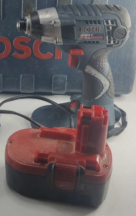

GDR 18 V
Which prompts a question.
Looking for a Bosch tool has taught me they've had a consistent naming convention for some time - my drill is a GSB 18 VE-2, and combis are still GSB <something>, with the <something> changing with voltage and generation etc.
The impact drivers are all GDS... (½" square) GDR... (¼" hex) and GDX... (2-in-1).
As I said I did want to stick with the same battery system I already have, but there aren't many GDR 18Vs about, and of course they're long in the tooth now, and yet surprisingly expensive compared to newer Li-Ion powered ones. Which might be because Bosch also subscribe to the "let's make each new generation of products worse than the previous one" strategy.
So even though it would be a nuisance to have another charger and more batteries knocking about, I'll look at those, in which case no reason to stick with or limit my search to Bosch.

GDR 18 V
Those letters all mean something. Being German the "G" probably stands for Gerate (tool). I know that "OF" in the routers stands for "OberFraese" (overhead router) - Elu used to be the same with their routers being prefixed "MOF" (for "Machine Ober Fraese"). No idea what the "P" prefix on the green Bosch DIY stuff stands for. Makita (my hobby horse of choice) has something similar with their tools - tools prefixed DHP are all combi drills, DTD are all straight impact drivers, DTL are angle (L-shaped?) impact drivers, DHR are SDS drills, and so on. The "D" is always the 18 volt LXT battery with electronic tool protection, older pre-protection tools (not made for more than 10 years) are prefixed "B" (so BTL061 vs. DTL061)
Your problem is that Bosch stopped manufacturing NiMH tools at least 9 or 10 years ago, so anything you see offered will be old stock and probably priced at whatever was the list price at the time. You will therefore struggle to find new NiMH tools and the prices will more than likely be all over the shop.

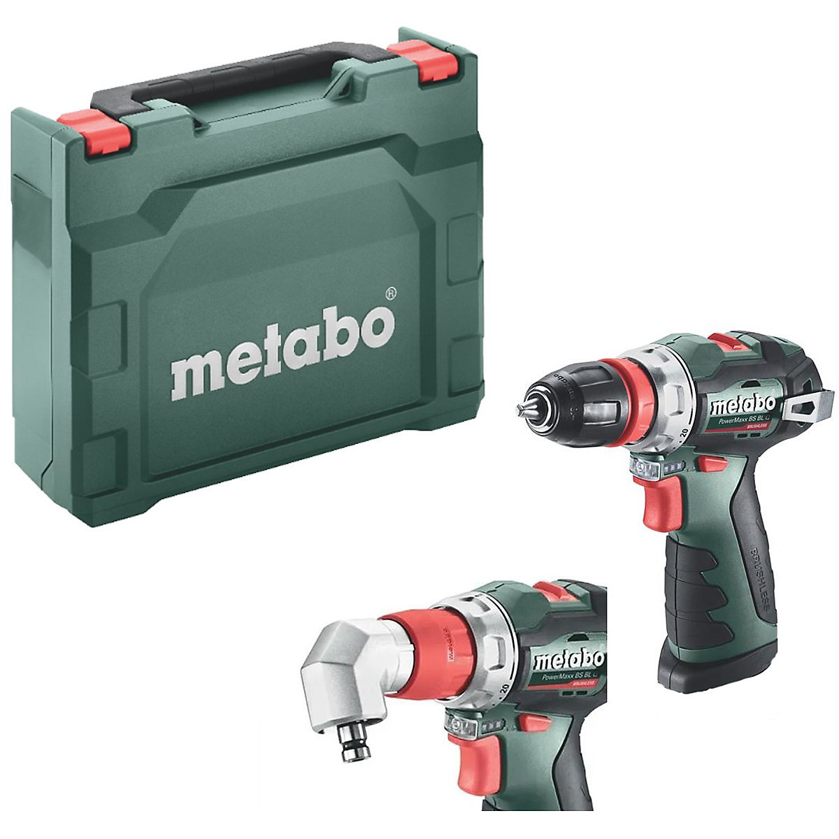

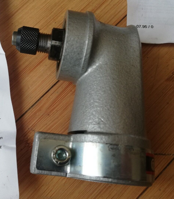

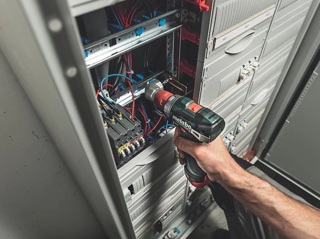

As you are talking about Metabo, did you know they make both a 12 volt drill with right angle adaptor:
A bit lightweight (Milwaukee have a similar system in their M12 range which I own, Festool also do a similar tool drill with an angle head - in each case the angle head is specific to the tool/range). Metabo also do a head (the DRILLATC head) which is designed for use with one specific model of cordless 18 volt drill:
I'm looking at used ones - you can tell from the photos how much of a hard life they've had, and so far I've always been OK (lucky?) with my purchases. I've got a 10.8/12V screwdriver and multitool, and a corded SDS, all bought used. Can't remember about the drill.
But that's what surprised me - used NiMH tools more expensive than used Li-Ion. as you say, possibly because of what they originally cost the seller.

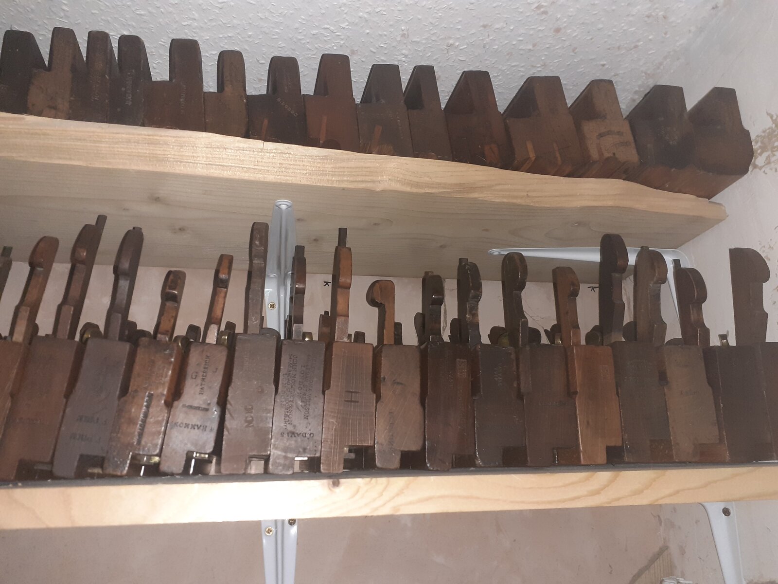

That's a lorra lorra rabbit planes. I never collected moulders, but I've got a filing cabinet full. Ollers and rahnds and so on. I keep them for the smell of the linseed oil.
