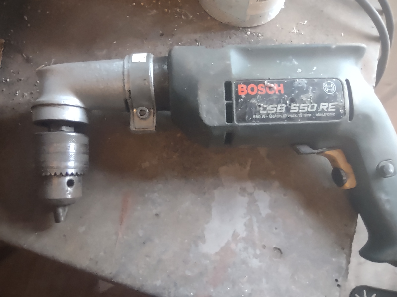

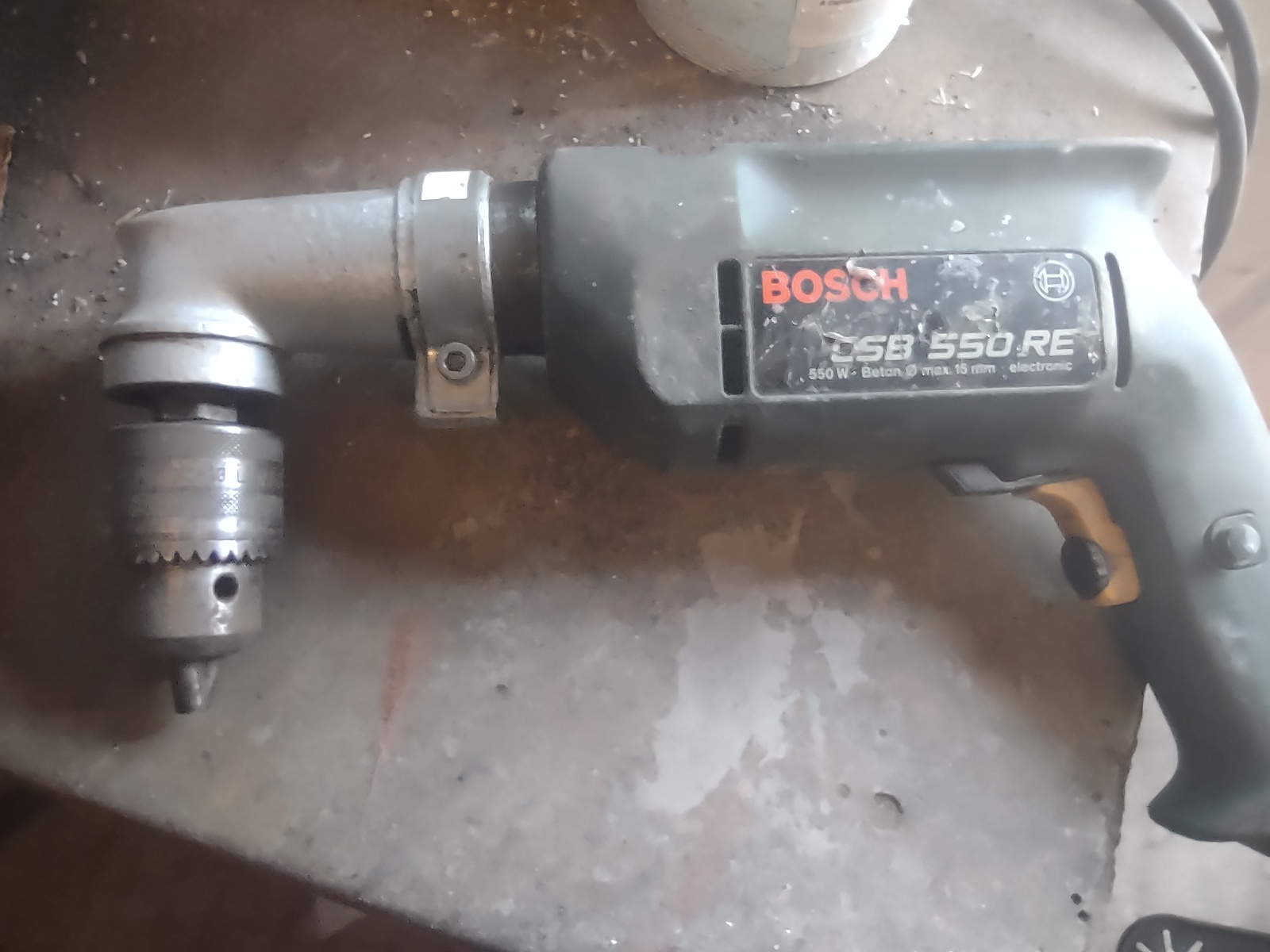

I have an older version of the second one, it fits, with a bit of tinkering, any standard drill (mines fitted on a Bosch). No Idea on the price difference if the quality is similar, I think mine is ridiculously expensive and the other is ridiculously cheap.

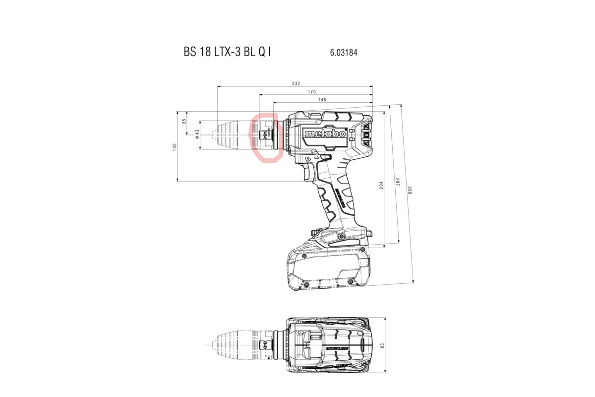

If you look at the following image you will see that the chucks are designed to sit on a shaft that has both a groove and dents for ball bearings.
The angle attachment doesn't have the ball bearing dents.
The following lead me to believe that all would be good
My drill is the LTX 3.
The chuck that you linked to (627240000) is listed as being suitable for my LTX 3 (quick) and the slower LTX. You are correct that it says that the
627240000 chuck is compatible with the right angle attachment- I just can't get my head around the fact that the chuck (you listed) will attach to the drill shaft and the right angle attachment, but my chuck won't.

My solution for mass drilling of 3in pitch pine joists a few years back was an 1100 watt Bosch corded drill fitted with a Metabo angle adaptor (at over £100). That particular drill outfit did all the holes for joist sistering on a project where we sistered over 6k joists (so over 25k holes, 14mm diameter, Hilti spade bits mostly). The only thing it needed was a dollop of lithium grease about half way through the job. That's why the big Metabo and Bosch adaptors are big bucks. You get what you pay for

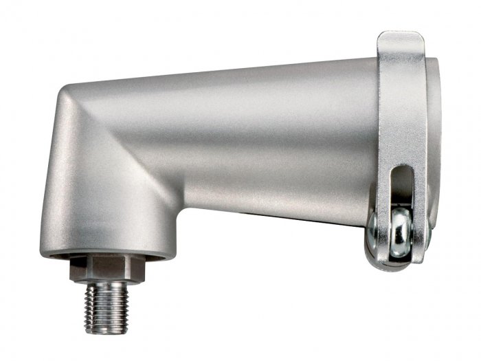

Did you use this Metabo angle attachment- the one where you fit a threaded chuck?
Frankly it looks very much like mine, but without the thread and your's has a very slightly lower Nm rating. Mine cost £17 though rather than £100+ that you paid for.
Both require drills with a 6.35mm hex recess and a 43mm collar.
I guess that I could use either on my drill. The only difference seems to be a hundred quid price difference and the need to use a threaded chuck.

My set-up utilises a 1/2in keyed chuck (in point of fact a spare DW unit I had) which threads onto the front. I didn't want to use the original Rohm keyless chuck off the Bosch drill because like all keyless chucks it is longer than an equivalent keyed chuck - and when you are side drilling sistered joists in situ you tend to need every millimetre of space you can get.
Err, nope. The one I bought requires a drill with a male threaded arbor mounting on the drill (1/2in UNC 20 tpi - the sort of de facto standard for 1/2in corded drills) and the drive is provided by a pair of hex nuts which need to be locked together on the drill's threaded arbor. It looks like this:

Having in the past snapped off a 1/2in square drive adaptor in the 1/4in hex chuck of my impact driver I am not in agreement with that. An all metal threaded chuck is a lot more reliable than a part plastic cordless chuck, and a 1/2in UNC shaft will take a lot more abuse than a 1/4in hex drive shank. The smaller item is OK for the occasional hole, but it won't stand up to the sort of long term abuse I envisaged our unit getting
