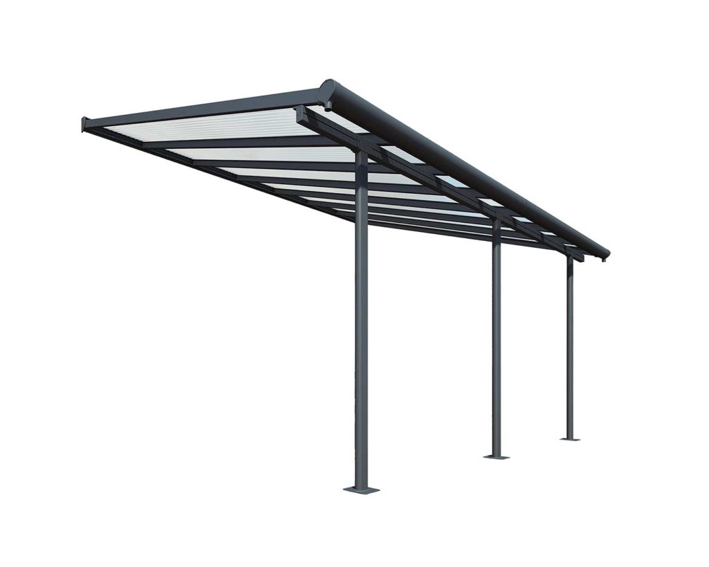

I am fixing a patio cover to the back of my house and it recommends using chalk to seal the bar that is fixed to the wall (see image of the unit) to stop leaks / water . what type of silicon/sealant should i use. I have used stuff in the bathroom but never bought for outdoor use

Acrylic tends to harden and crack. Definitely not chalk or even caulk.
Polymer or silicone.
I would be so tempted to not bother.
Limted amount of rain will go down that gap - same amount as is hitting wall now.
And if yo put silicon on your wall/bricks - it will perminatly stain them - to be considered if you might remove the patio cover in the future.
