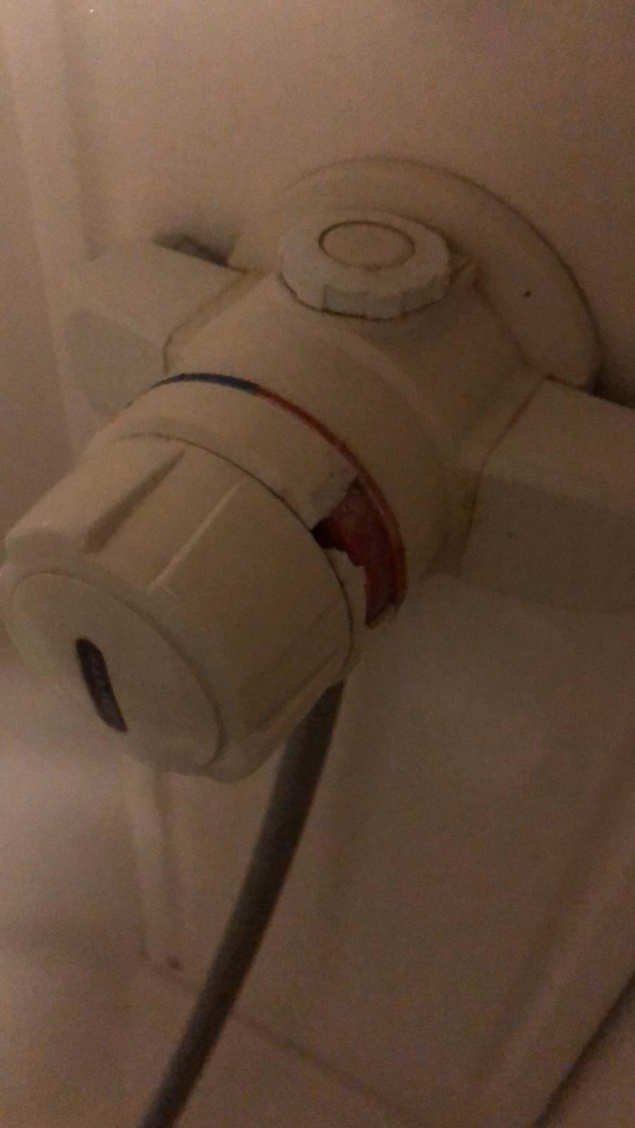

I contacted Aqualisa but they were not able to help which is a shame
I am after the model number of the following old shower to see whether i can replace the cartridge and the temp knob which is broken
The temp knob is stiff to turn
Thanks so much for anyone who can help!

I did look on that website but I still cannot find the exact model so that I can see if a part is interchangeable and can be replaced
how long would a plumber take to change the cartridge. Is it a 10 minute job or a three hour job. Those cartridges are £110 and I can’t replace the whole unit because it is using 22mm pipe work apparently!!
I have a couple of surface-mount Aquavalve, and they have an egg-shaped plastic cover, so yours must be older, though it is fairly similar. I have an idea mine have model numbers in the 400 and 600 range. I can't see if yours has a white plastic shroud or if it is painted white on the brass shell.

I don't see why a plumber couldn't change the fitting for a 22mm pipe. IIRC it has half-inch elbow connectors that can be rotated to fit pipes from above, below or behind.
If you take it apart, there should be a coloured ring on the old cartridge that (should) identify it, though I think Aqualisa now sell a "one cartridge fits all" type. What colour is your hot-water cylinder?
Hi thanks so much. I have not taken out the old yet but it’s so stiff I had to use pliers to change the temperature so I know it is the cartridge that needs replacing
I have gravity tanks in the loft and a system boiler so I guess the grey one is the one to go for. I don’t even need to check the old one right

ah, copper. That tells us you have a low-pressure system. I hope you have one or two red insulating jackets on it?

if you had the right part, less than an hours work. But there is some doubt so there may be additional tinkering.

If you are buying a new cartridge, look for the models that the cartridge fits, and a spare knob and lever for one of them should do. I'd fit the cartridge first, I think.
A toothbrush should get the dirts out of the casing, and lubricate the fitting parts with white silicone grease from a plumbers shop. Especially the gasket and "O" ring grooves. Just a fine smear. And on the screws.
