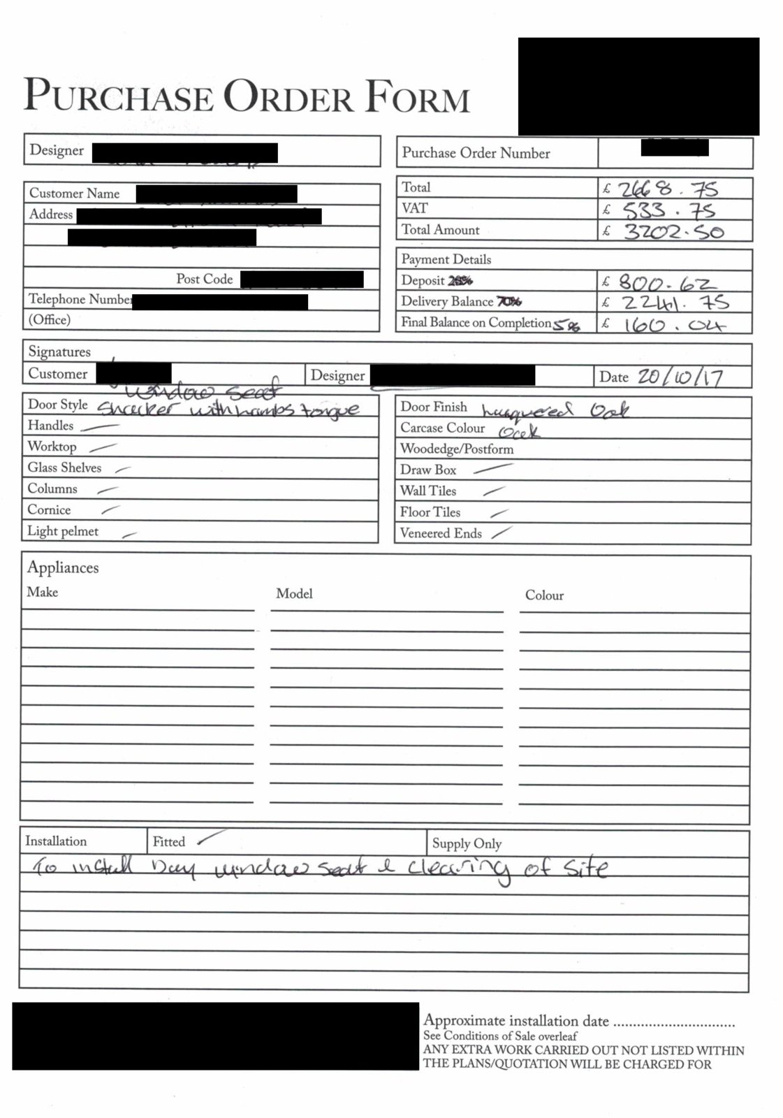

Hi folks, thanks all for your feedback. I balked at the quote but we were already "in", and I expected I would need to pay a high price in order to get nice materials.
I cannot tell whether it is true oak veneer or whether it is synthetic veneer, all I can tell you is there is a finishing strip along a cut edge and the grain of the finishing strip is 90 degrees to the grain of the veneer, so it's an immediate givaway. The representative came over and attempted to placate me but I'm unhappy about the outcome.
There is very little in the way of specification or "contract" one might say.
I have:
a) Quotation to supply and instal proposed Bay window Seat 1880*400*450 window seat with storage
b) Installation and clearing of site
c) Purchase Order Form - "door style - Shacker with lambs tongue" Door finish I think says lacquered Oak, carcase colour says oak
d) a drawing with no dimensions or notes on
e) my original email asking them to come over which indicates my expectations regarding the standard of materials
Nozzle
I'm wondering what the initial advertising says (wording) ie what you referred to when you were deciding what to buy. Definitely the order form is using manufacturers speak as mentioned in my previous post.
