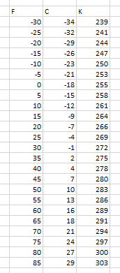

We do love a challenge but you skeptics make it more interesting by having your own version of "imperial" ... I've often wondered if that was just because you're being the belligerent upstart.
But -30F is what -35c? Fook knows, F was one of the few imperial measurements I couldn't get my head around at school. Otherwise UK imperial and SI I can happily swap around.

For clarity:
