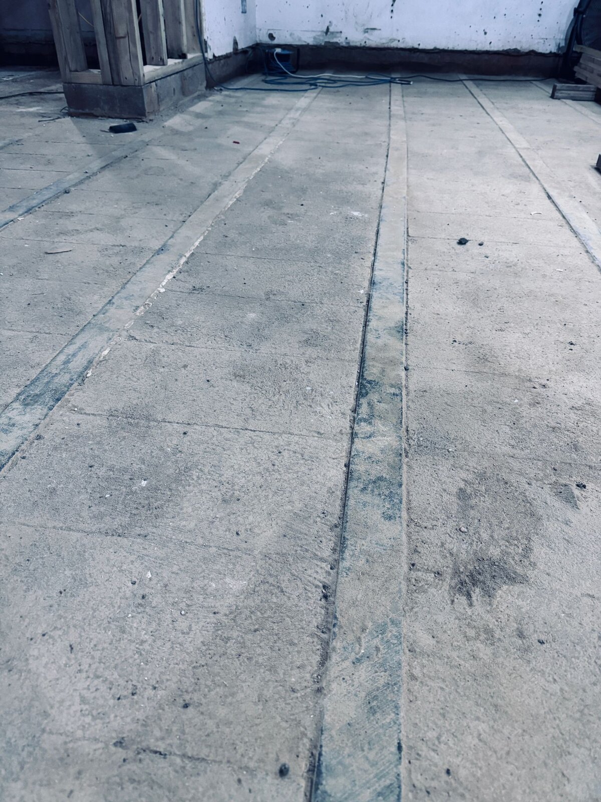

We have had to install a beam and block floor throughout the whole house on the ground floor. Despite having spread sand and cement slurry across it, in some areas the blocks sit about 1-2mm lower than the beams. Bearing in mind we have to lay PIR and screed - should I be worried about the insulation not being completely supported underneath?

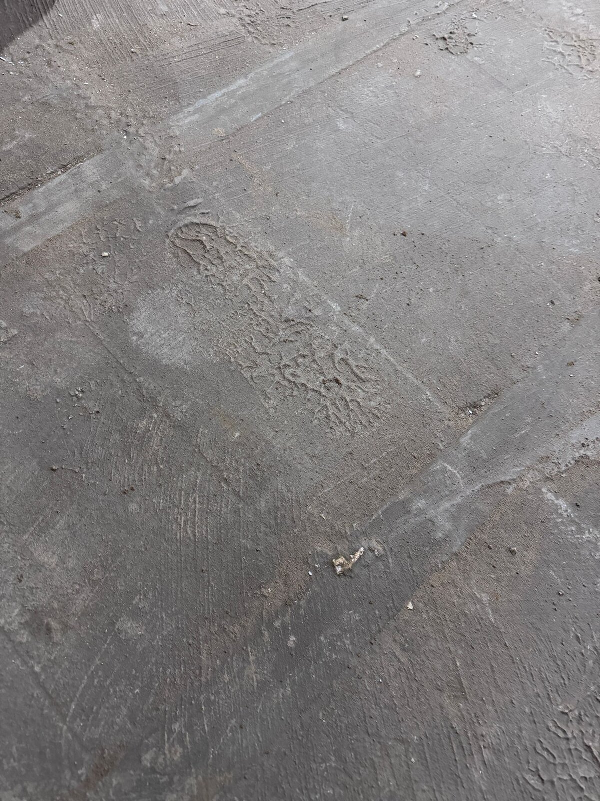

In areas there is build up from cement/ materials used to do other jobs - which is quite hard to remove. Should I try to remove this or not worry about it?

Minor discrepancies are not an issue no. Something as simple as building sand scattered about and packed in the hollows is all you need if you are concerned How much room do you have left for insulation and screed?

If you have the odd block 2-3mm low, anything above 50mm PIR isn't going to sink into it really. If you have mortar on the blocks, a hand grinding block is very good, but if its only slight it will just indent the insulation.
100mm floor insulation is likely plenty, unless you have a large exposed perimeter to outdoors. Not a huge amount if heat is lost through the floor.
Our screed is fibre reinforced
Looks like more than a few mm on the first pic. If it was me I'd probably throw a few bags of cheap self levelling compound at it for my own peace of mind.

So would you suggest putting sand down in any areas lower than 2-3mm but leaving the rest as they are?
Perhaps laying the PIR in a way that it doesn't over hang beams so there is always support at the ends?
No need, just scrape floor and put insulation down, your floor will not be level anyway due to the camber in the beams.
