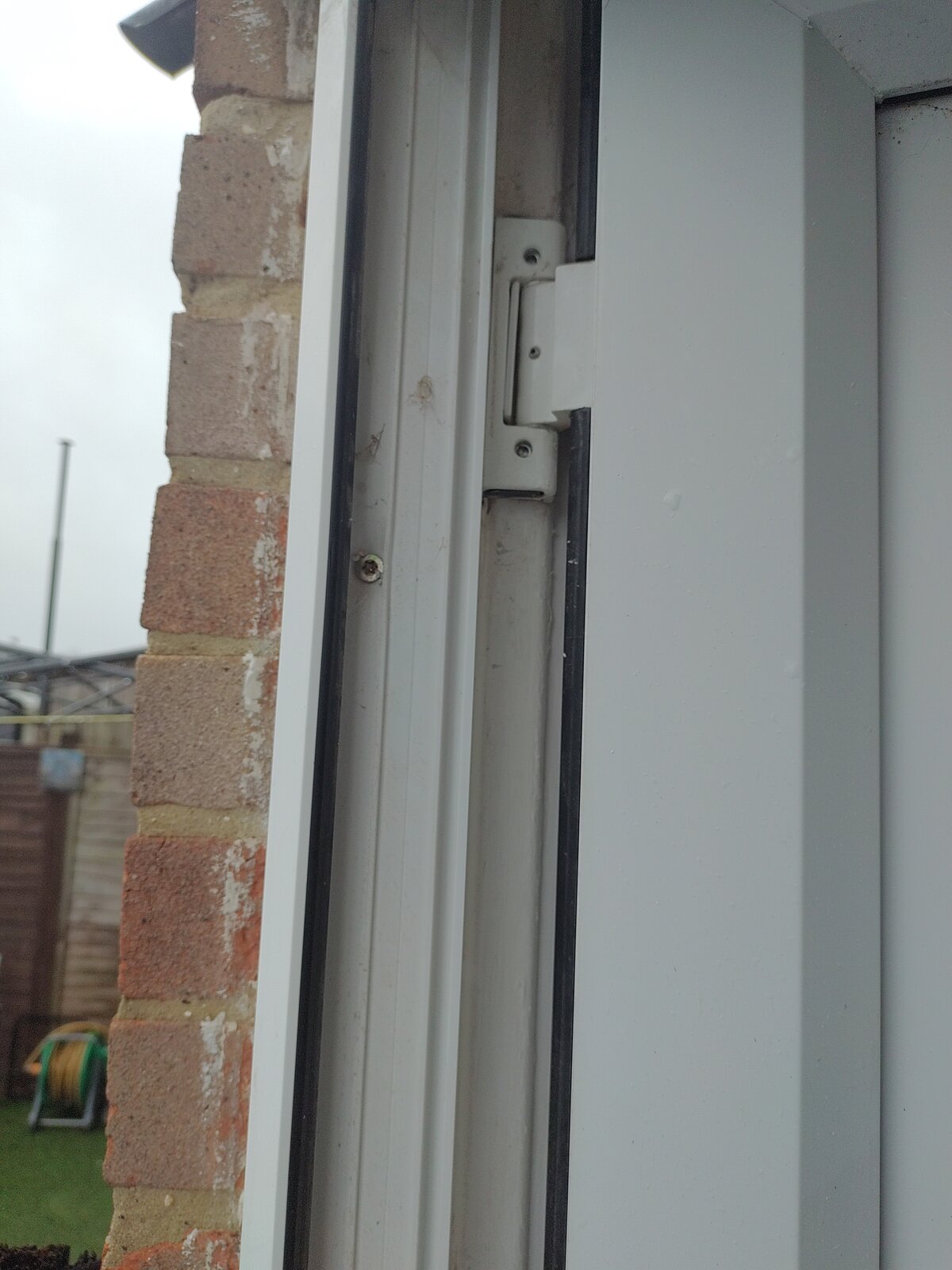

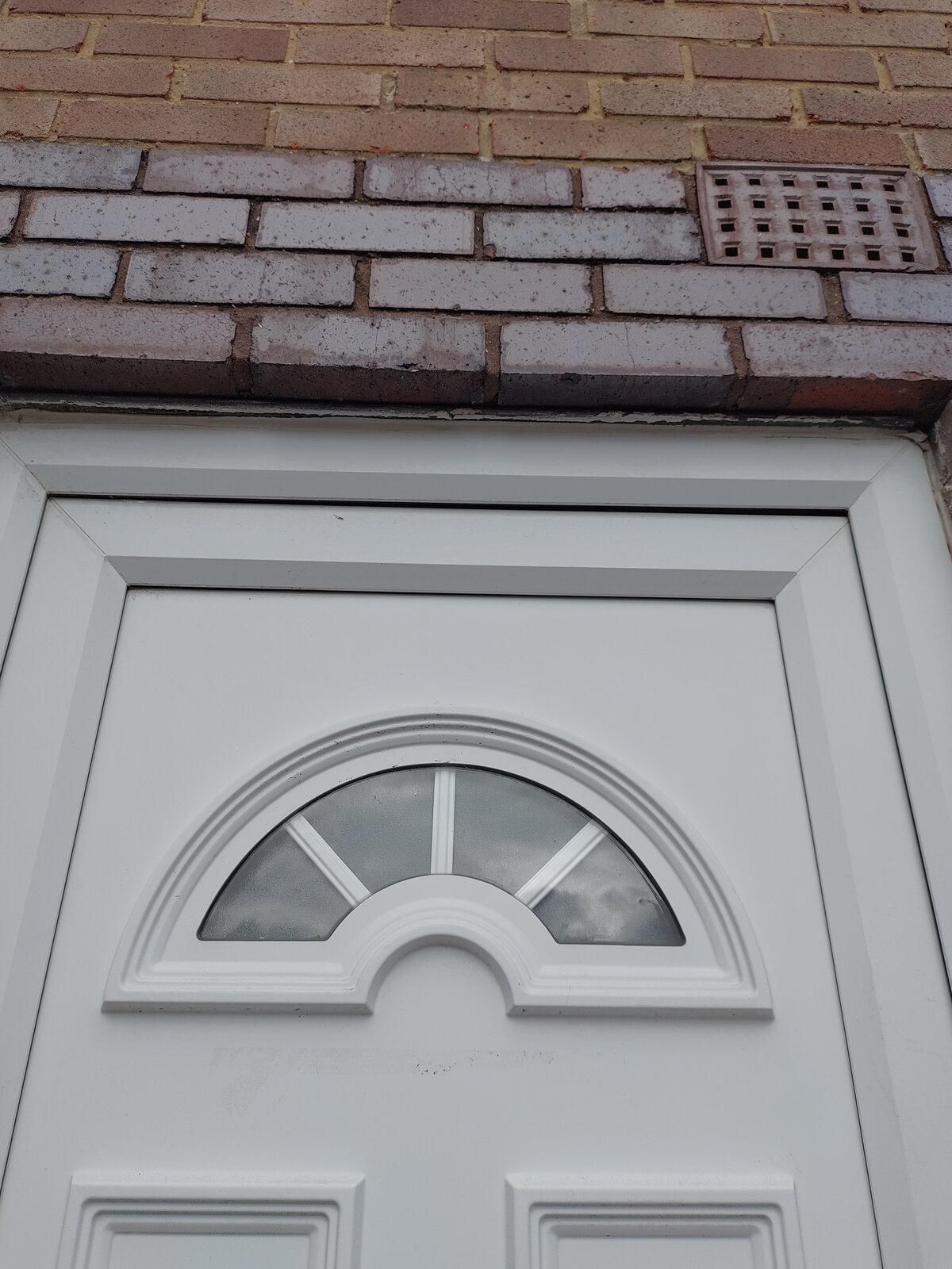

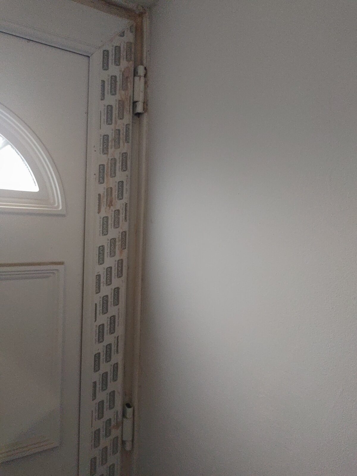

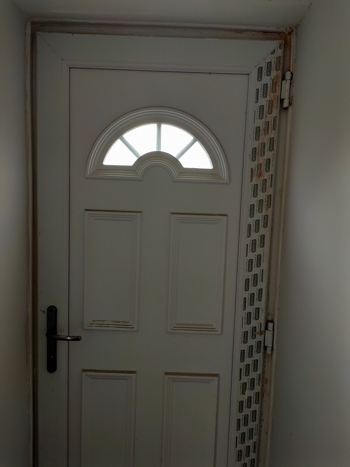

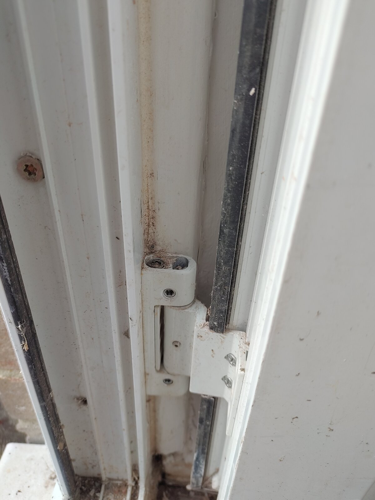

Hi guys. I'm going out of my mind. The door is letting wind in from the top right corner (looking from the outside) and I assume the hinge needs to be adjusted but for the life of me I can't adjust it correctly!
I believe then that this hinge can only adjust in one direction and I need to adjust in two directions.
Can anyone help me with this please?
Thank you.

There's usually a removeable plastic cap over the hinge which covers some of the adjustment screws.
blup
The hinges are adjustable but they won't give you the amount of lift you need, that door needs toe and heeling, basically de glazing and the door panel repacking correctly to lift that corner up, looking at how much its dropped I would hazard a guess that it's not been packed correctly from new
