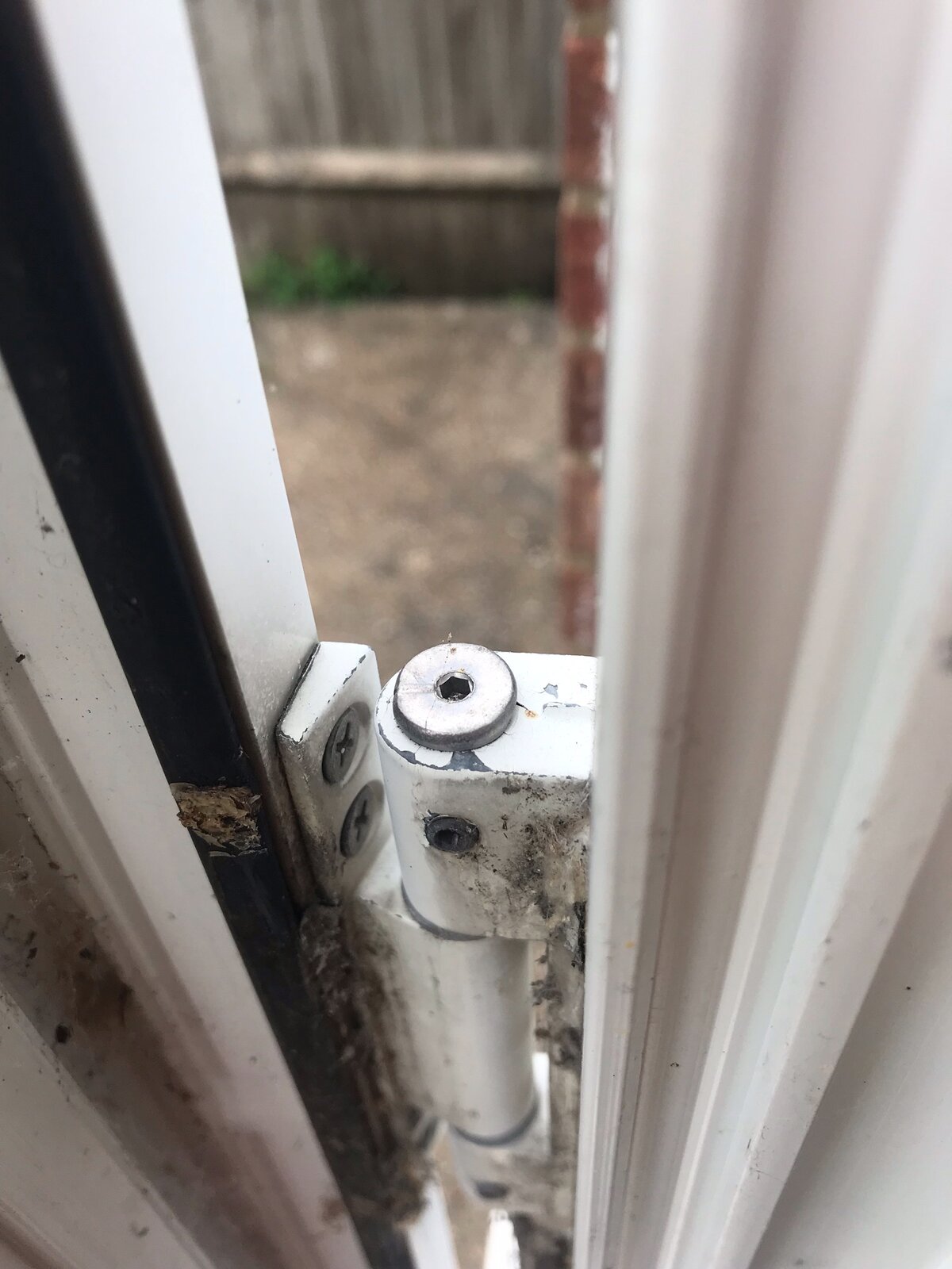

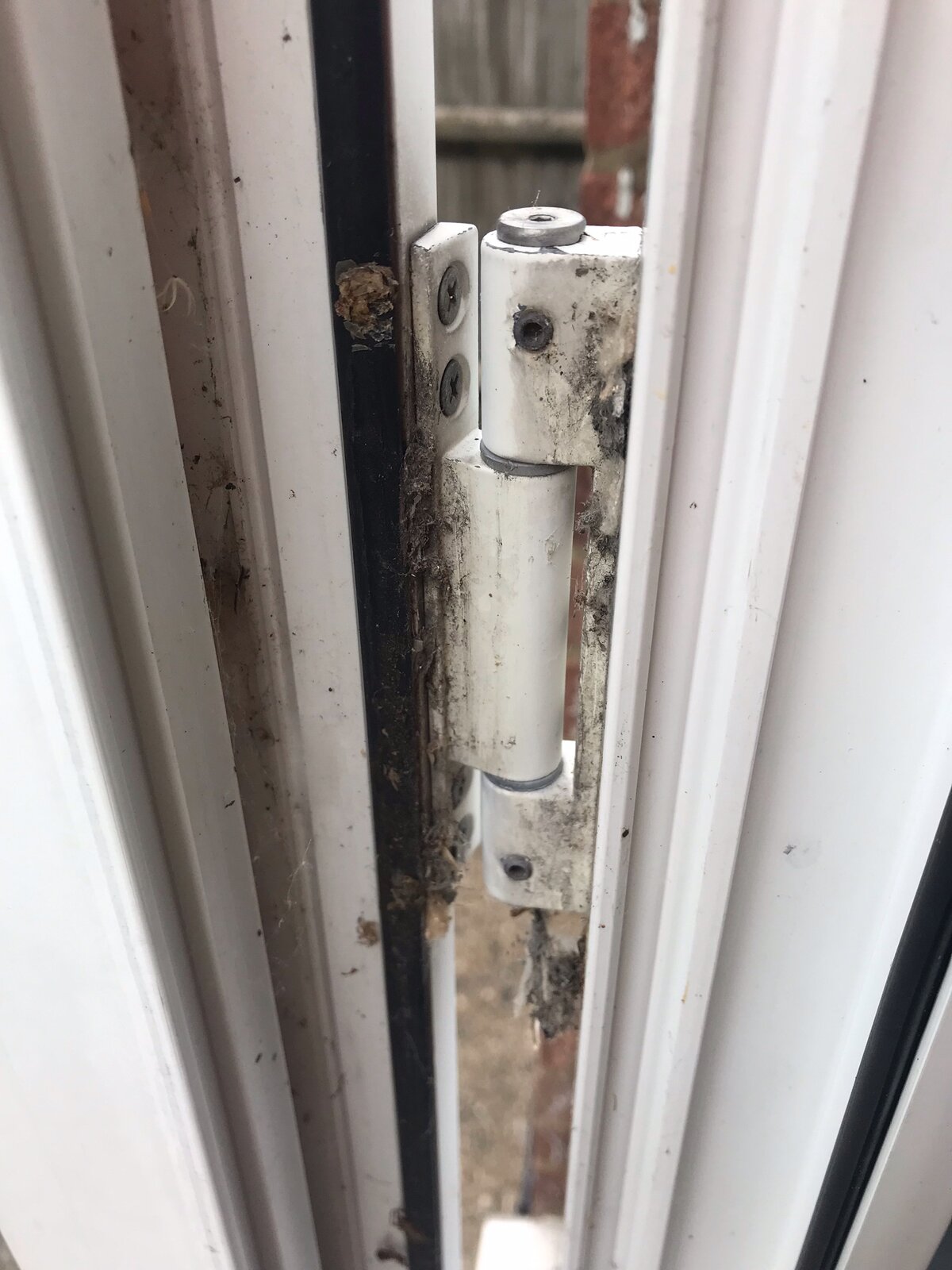

Hi there,
I have a question. The top of my French door is rubbing against the door the other side and I need to adjust the hinges. Can anyone tell me if the hinges pictured are adjustable and if they are how do I adjust.
Many thanks in advance,
Steve
Im afraid those particular type aren't. You could try removing the.glass and toe and heeling the doors, plenty of videos on you tube explaining it
