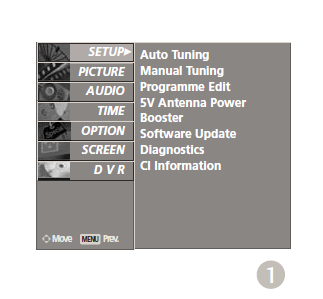

With my mothers TV and mast heat amplifier the power now comes from the TV, originally it came from a small power supply however this was auto shutting down after a short time, and reading the info on TV one could configure the TV to give out power on the aerial socket. Both TV's are LG. I can see some one else coming into the house would have a problem as not all TV's have a power output for the mast head amplifier.
Before setting the TV to output power often my dad would go to bed and switch everything off at the wall which would cause mothers TV to fail. I have never tested to see if the power is removed from mast head amplifier when in stand-by or non TV input. I know a Sky box still powers the LNB in stand-by in order to receive program changes. As far as I know this is unique to Sky, my free to air box on stand-by uses less power than I can measure so that does not power the LNB on stand-by, which is really better as it saves power. So I would expect when the TV is on stand-by then the power to aerial socket is switched off. Good reason to power with TV not a separate power supply.

The picture shows how to select power out on my mothers TV likely something similar on yours.
