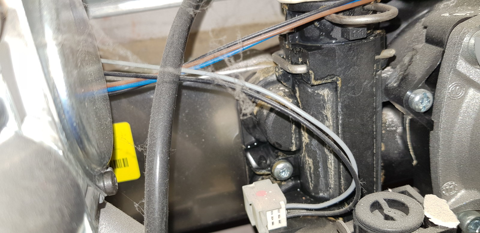

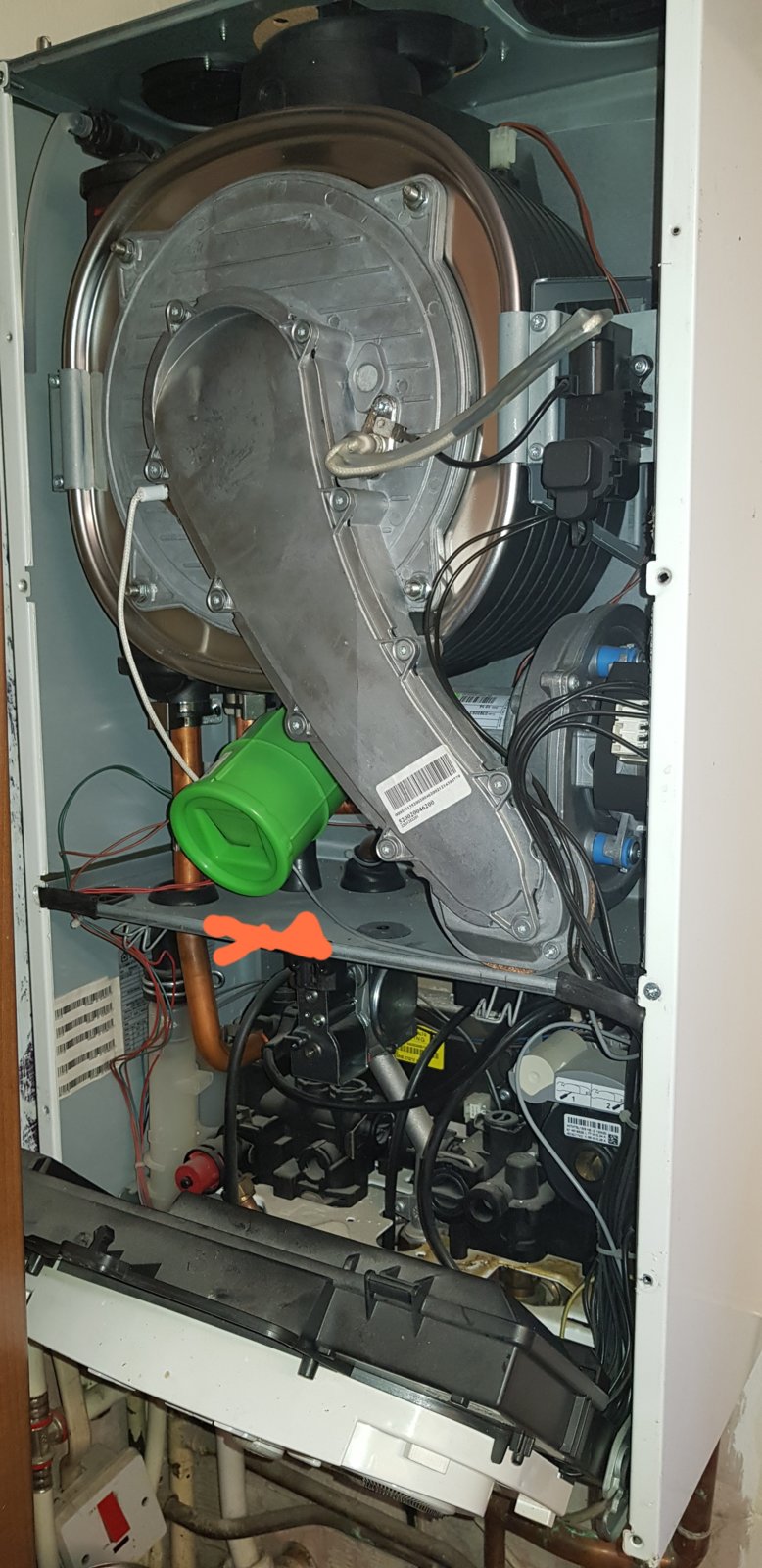

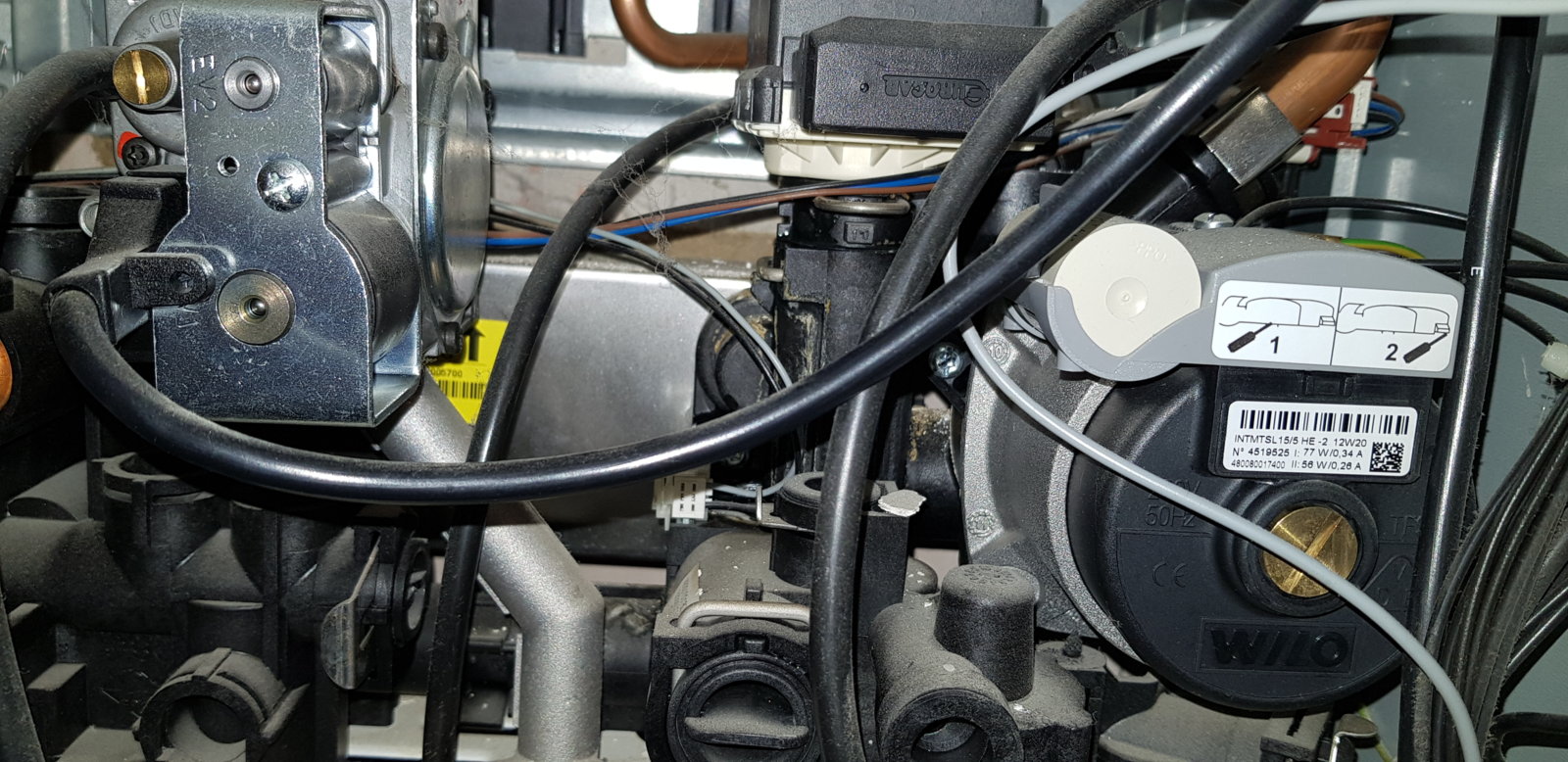

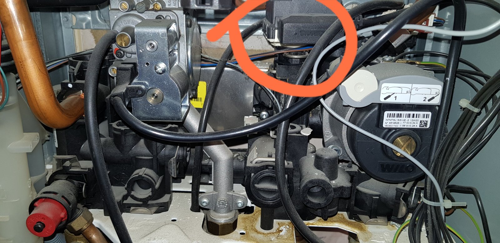

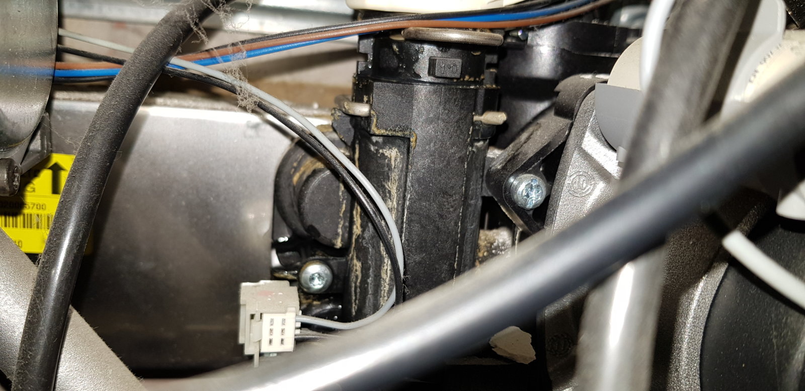

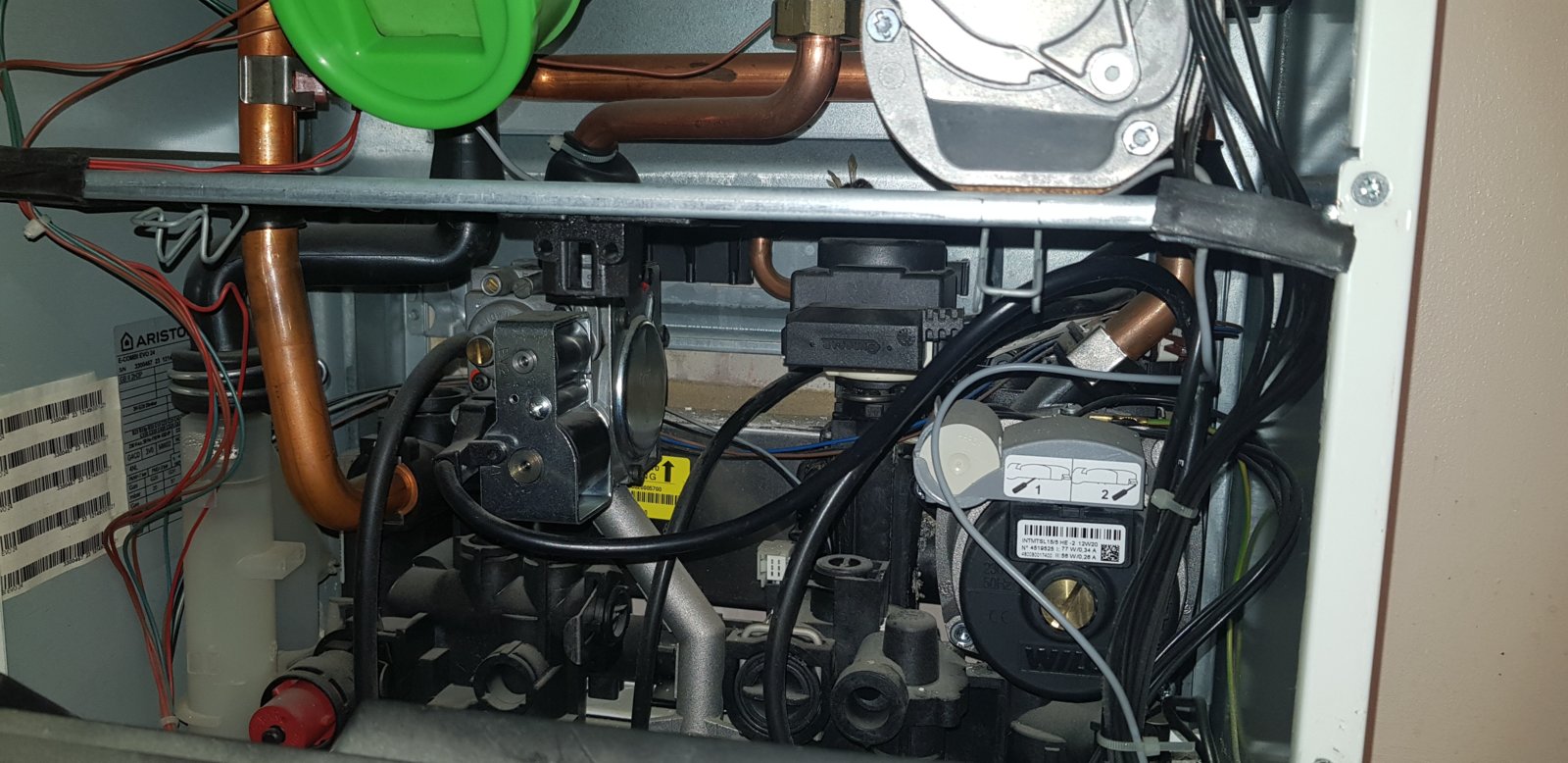

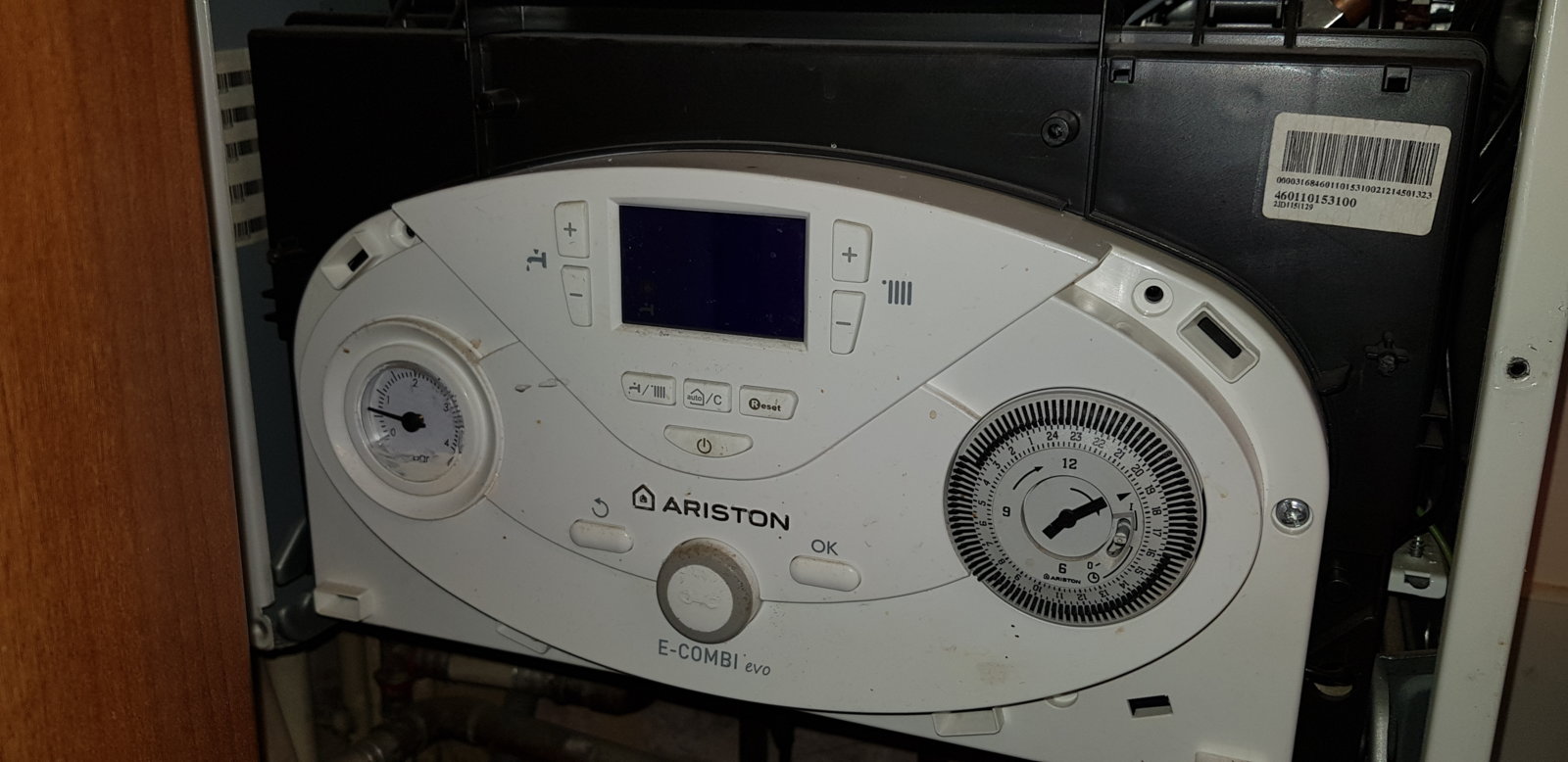

Hi, I have ariston combi boiler which is leaking water. I have attached some photo's and does anyone know what the parts is called and is it easy to repair or replace?

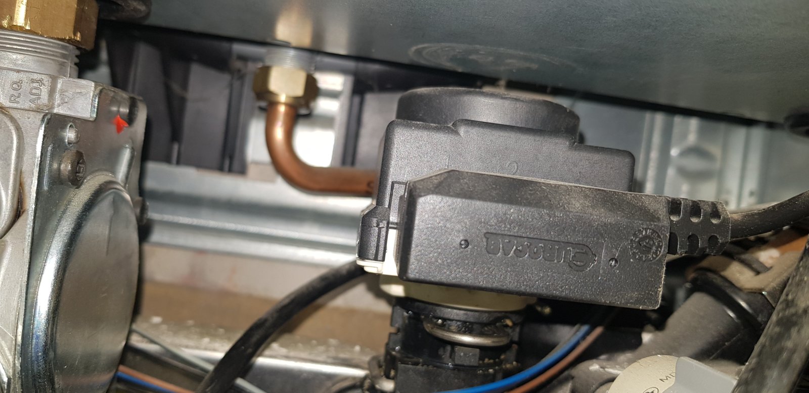

its called a diverter valve , if you are lucky it will just be the cartridge that is passing, but may need the complete assembly, turn the power off and remove the diverter valve motor its just a clip , no need to drain anything, have a look at where the valve pushes in a pin and if there is signs of water in there you should get away with just the cartridge
Hi, thats great and many thanks. any idea where i could get one and the cost. is it a really easy job to do?

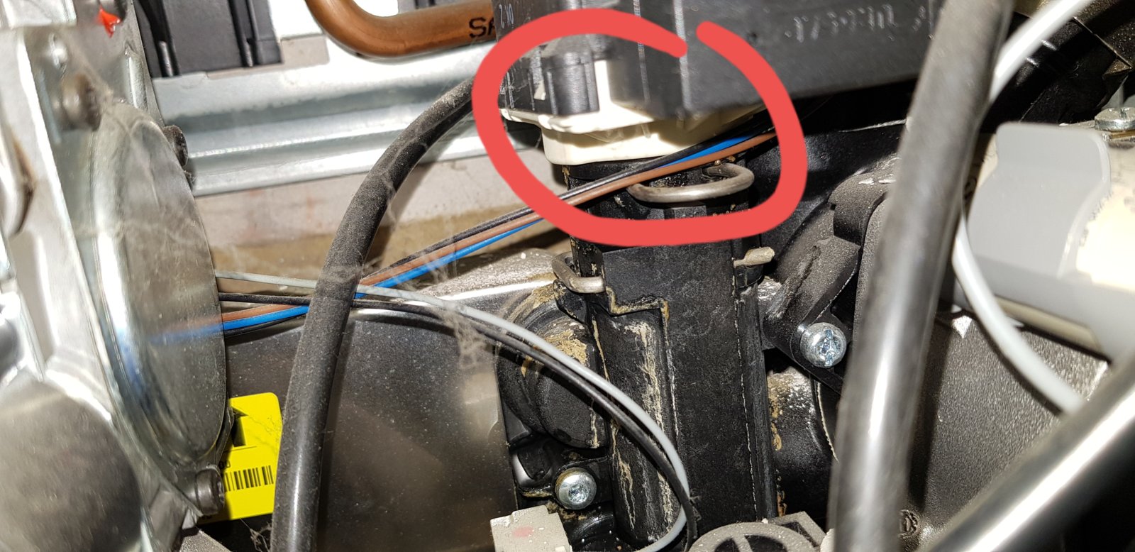

Hi, I went to replace the diverter valve which came yesterday and have encountered a problem and there is a metal plate in the way and can noot lift if far enough to get it out. I have attached the photo's
