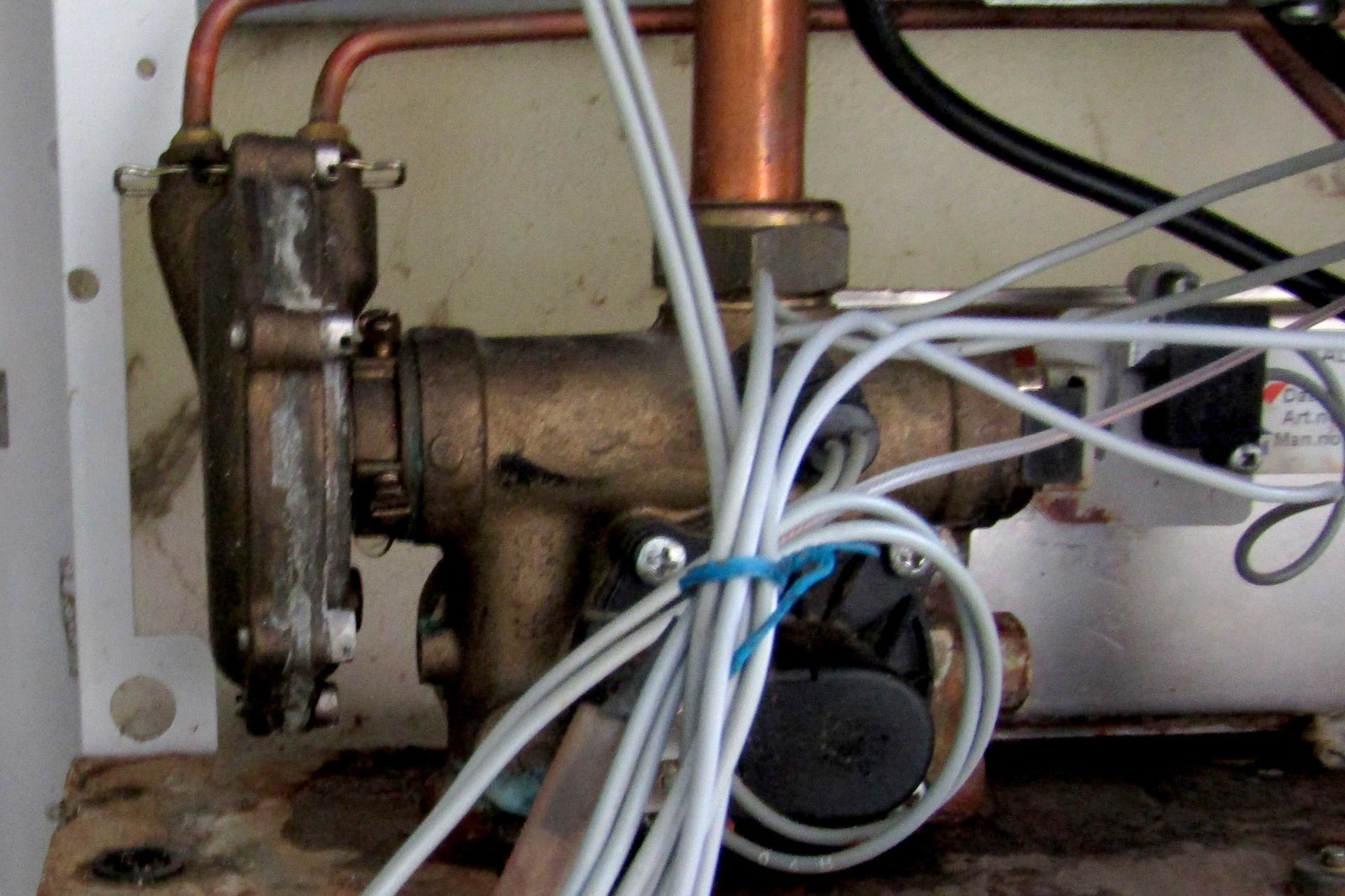

Hello all again.
Due to circumstances beyond my control, I have only just been able to fix the leak by replacing the part 362 (see page 1 of this thread).
Thank you all, for helping me sort the leak. (y)

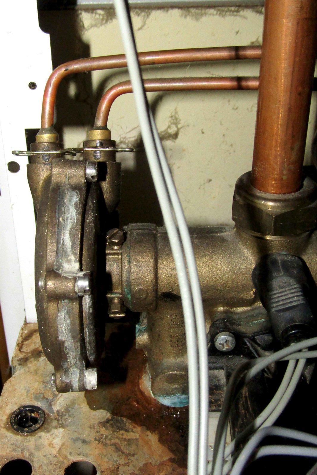

But unfortunately, there is a drip coming out the other side, where part 363 is, now!!
In the bottom picture you can just see a drop of water coming out. Just below the bottom screw.
If you look at part 364, the furthest right part has a thread one side and 3 screws the other end.
What are these screws for please?
Do I have to drain the system to remove the old part (362) to install the new part please?
No, I didn't as it wasn't suggested at all through this thread.
Please can someone instruct me on how to remove the left hand side so I can be able to replace the part 363, that is leaking?
Does the system have to be emptied before starting the repair please?
