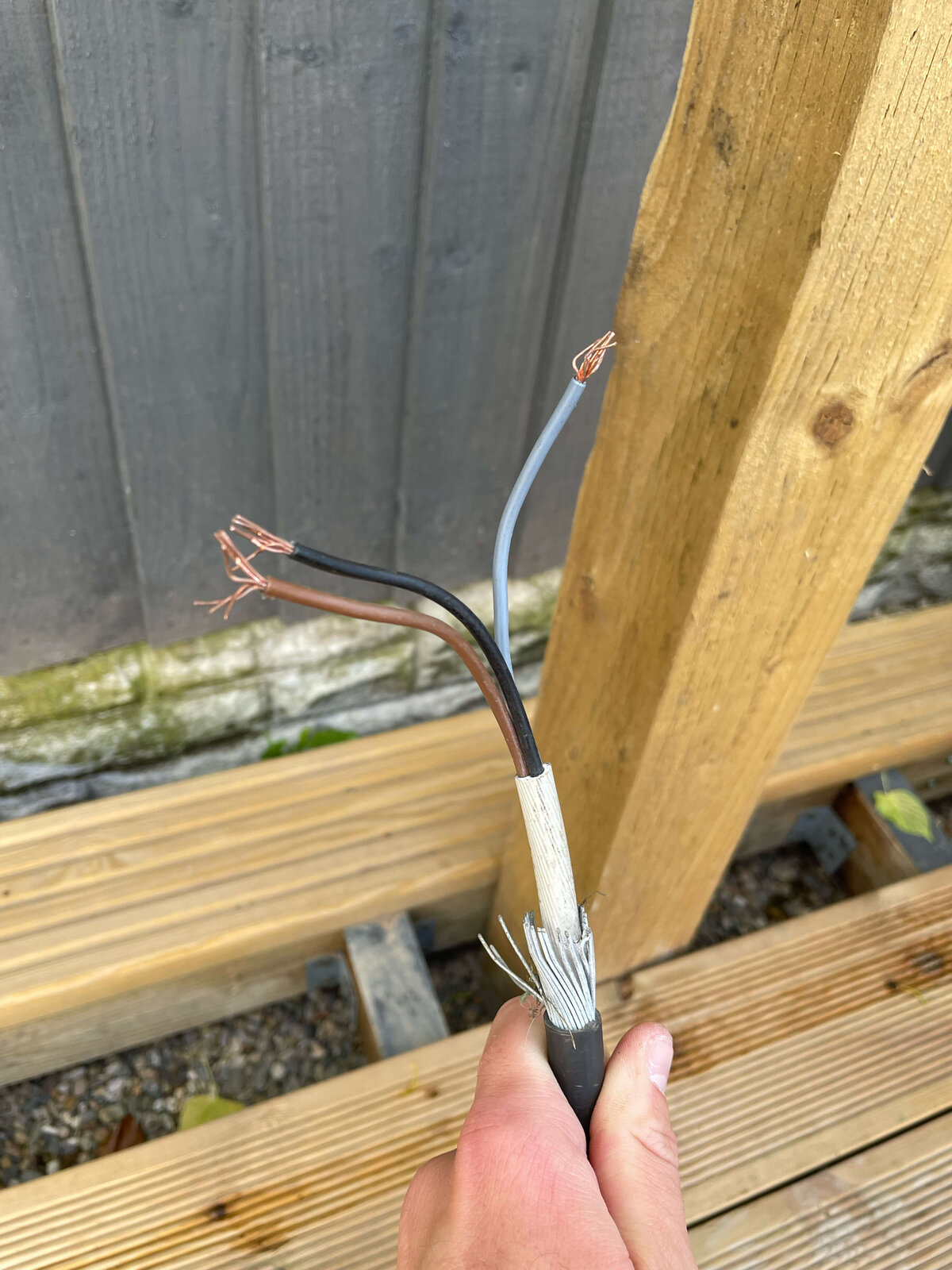

I have recently been given the attached armoured cable and I was wondering if you anyone can tell how many amps this will produce?
I don't know if this is a daft question and it can't be determined by the picture, but I thought I would try. If not, is there a way I can find this out myself?

You want to know how many amps the cable will safely carry, not how many it will produce. Cables don't produce amps, (current), devices such as washing machines, kettles, TV's etc are the things that produce current.
There should be some markings on the black insulation, (may be raised lettering/numbering). If you can find these then post what they are and someone may be able to tell you what the rating is. i.e. how much current it will safely carry.
I am guessing that is 2.5sq mm but could be wrong.

I ask this question because I want an armoured cable running up to my pergola area and I plan to have a hot tub running (13 amps). I do plan on having a few other things as well such as lighting and at times a heater etc. When I had electricians over to quote on the job (before I was given the cable), they mostly did this to cover the hot tub and general usage - but mentioned that if I had a heater going at the same time for example, this could be more than it can handle. So I ideally wanted to future proof things and have a cable capable of running those at the same time - but as I was given this wiring and it can save money, I thought it best to use it - but I just don't know what the cable is capable of producing - if that makes sense.

Also, how long is the run of cable, where would it be run from?

A close-up, well-focussed photo of a ruler against the cable might help us to judge the wire diameter.
Looks like 6mm to me depends on method of installation but roughly 40Amps

Have you checked the cable for markings and codes as @conny suggested? You might see something like 6943X which is the specification and easy to look up.

I have checked the cable and it says the following:
ELECTRIC CABLE 600/1000V BS 5467
Does that help? I am not an electrician (obviously an electrician will be doing the work), but I was wondering what the capacity this would be able to provide in terms of amps used from it?
