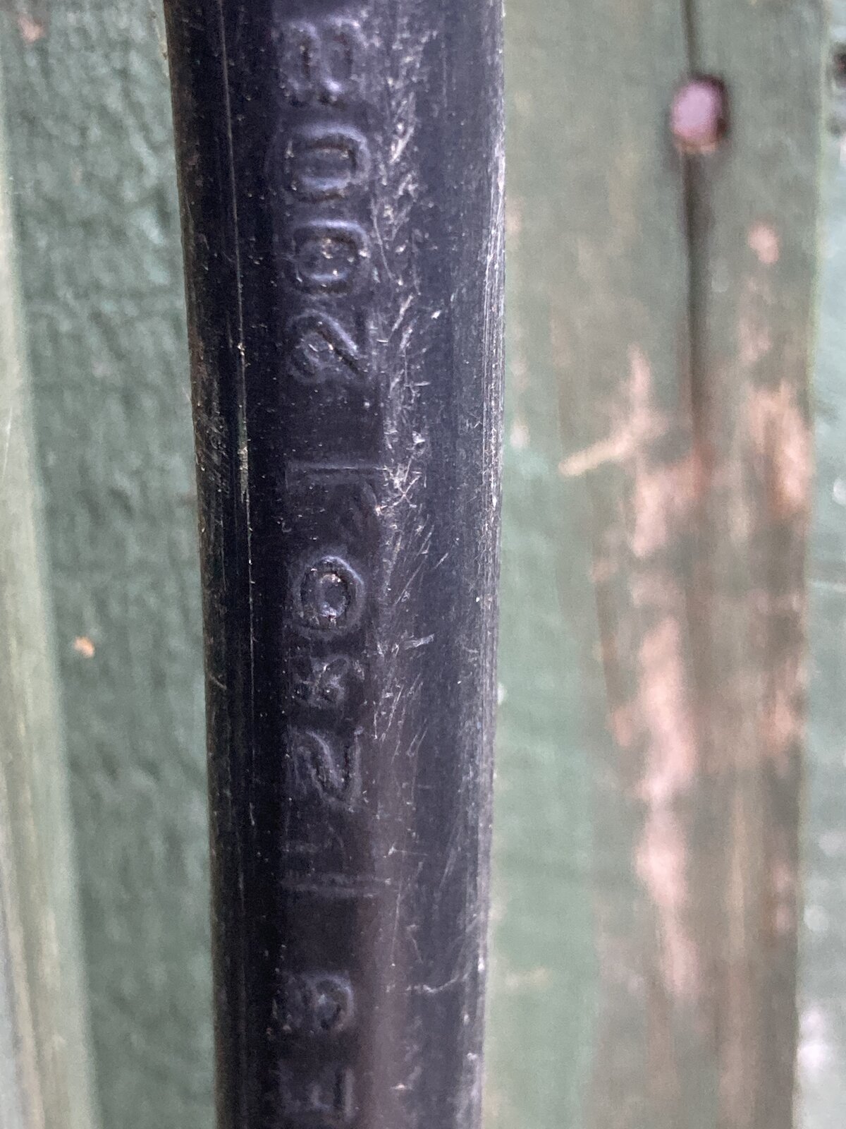

If you can measure the overall diameter of the cable, 15mm would be 4mm2, 17.5mm would be 6mm2 and 19mm would be 10mm2.
Current carrying capacity is dependant on how the cable is installed; cables heats up the more current they carry so it's all about how the cable can dissipate that heat safely. Electricians install fuses and breakers to limit (down rate) the current carrying capacity to protect the cables.
Ok, so you aren't able to find out based on the wording on the cable itself then?
There should be more lettering, maybe further down the cable or on the opposite side. We are looking for numbers something like
3 x 2.5
Often the embossed letters go on to say something additional
See my pic. This is 6mm, 2 core cable. The figures say
BASEC CABLES 2x6 2008
Look further, report back. Thanks.

Yes. The cable you have is 3core, 2.5mm²
Max current is about 30amp, assuming it is XLPE cable.

IIRC, XLPE 6943X. Should also be marked on the cable.
In any case 2.5mm will probably not be big enough for the loads you have in mind. There’s now no such thing as a 30amp MCB, so your max will probably be 25amp (if your cu has such a thing in its range). Or the circuit could be run from a switched fuse.
I’d be looking at 6mm for a run of 20metres or the distance will kill you with volt drop.
