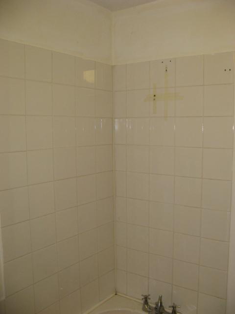

I have just been putting up a bracket for a shower curtain and I think I've drilled into something I shouldn't have.....!!!

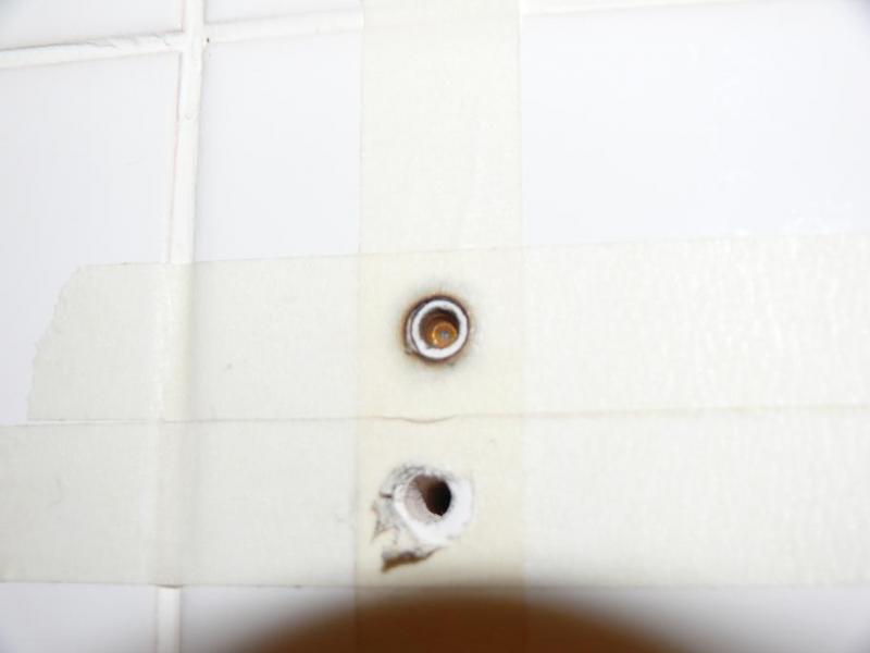

But I'm not sure what. Whatever it is is, it is pretty much immediately under the tile.... It's goldenish/copper, and made my drill bit glow red (and whatever it is was glowing red too)!
I've tried taking a pic to try and help...:

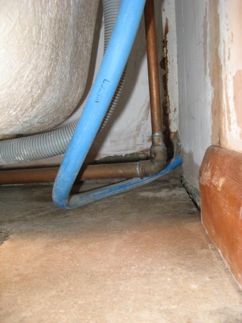

What I do know is that a blue water pipe comes down from the loft and out at the bottom of the wall to feed the bath tap. So I'm guessing it might have something to do with that.... However, knowing nothing about the construction of houses/walls (or plumbing) I really don't know what it is I might have been drilling into....

Here's a pic of the hole from a distance so it can be seen in context:
A pic of the pipe coming out of the wall beneath the bath

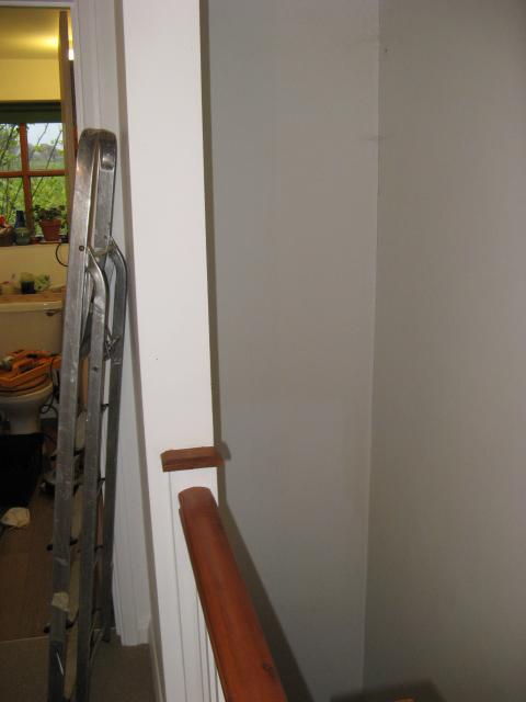

And here's what's on the other side of the wall (our stair well).

It does look like the copper pipe although I suspect the glowing was caused by the drill bit heating up when it was drilling through the tile.
What you need to do now is to remove the tile to expose the problem, which assuming it is a pipe is an easy enough fix for a plumber to cut the pipe at the damage an solder in a joint.

It could well be copper pipe. The things that made me think it isn't are:
1. The fact the blue pipe goes through the ceiling (from the loft) and blue pipe comes out of the all at the bottom. Would it be normal to have copper pipe in between? Incidentally, if I move the pipe in the loft the missus can see the pipe beneath the bath moving.
2. Would copper pipe be that close to the wall - literally on the other side of the tile?

Looks like you were lucky not to pierce it , seems to be just short of that. Although it looks like the centre is blue which might indicate the copper is just a protective sleeve put over the blue water pipe to protect it , in which case it's done it's job.

When you wriggle the blue pipe in the loft, is there any sign of movement through the drill hole? Could there have been a wall-mounted shower at that point in the past? You might have hit the edge of a brass connector.
Of course, the other thing made of copper within a wall is the electrics so I'd be careful what I poked into the hole until tested.

Timber stud wall with a cavity ;) . If it was glowing red - it aint a copper pipe - you`d have gone through it for sure - it`s probably a protecting metal plate :idea: so it`s done its job . I`d leave it all alone ;)
