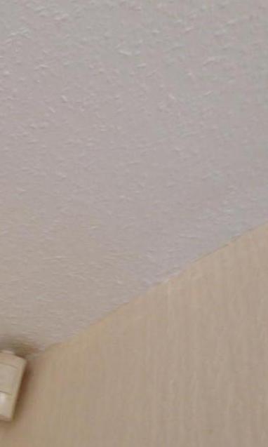

Also could you get a few pics of the room as it can help when giving advice
That on the ceiling looks like woodchip!
But anyhow if it is artex that's no problem to take of the peaks and skim
The walls look a big more work but it's hard to tell from the picture
