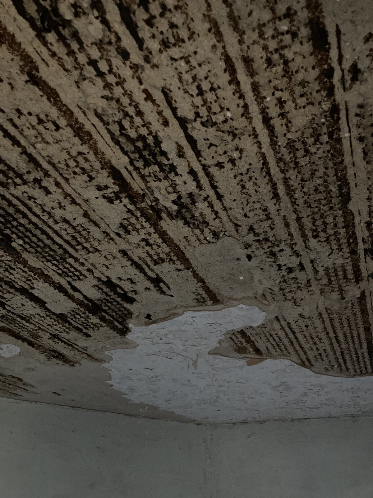

Hi, we live in a ex council house built late 1940-1950s. It has a coal shed/ toilet built on the side. The roof is flat, there’s no corrugated sheeting. The roofs been leaking and a huge part of the ceiling fell away It left behind what looked like a mortar mix and a metal grid. There was some visible white “hairs” about an inch long, almost like cat hair. The leak and the ceilings been fixed but since googling I’m wondering if it was likely to have contained asbestos in the mortar mix? I’m really worried as we did this ourselves as a diy project. I know it was a stupid idea.
Doubt it but for peace of mind a test is cheap.
It’s probably animal hair that was used for strengthening the mortar
Thank you, a builder came out last week and re boarded and plastered it. I’m worrying myself sick over it though I know there’s nothing that can be done
If it IS asbestos, (not likely) then it’s now enclosed.
No need to worry unless you drill into it and breathe in
This is the only photo I have of before which isn’t great. I’ve promised hubby no more DIY.

I’ve done some more research today and I’m convinced it’s asbestos. The white fibres weren’t clumped together like photos on google show for horse hair. I’m absolutely devastated

Same applies to asbestos. You’ve “done some research” and now you’re “absolutely devastated”. Sorry about that, but don’t believe everything you read on the internet.
You do still have the option of testing, if it would make you feel better.
FWIW, I very much doubt you have any asbestos.

You can't see asbestos fibres without a very good microscope.
In any case, asbestos was not used in the location you describe on council housing, and was not used in mortar anywhere.
