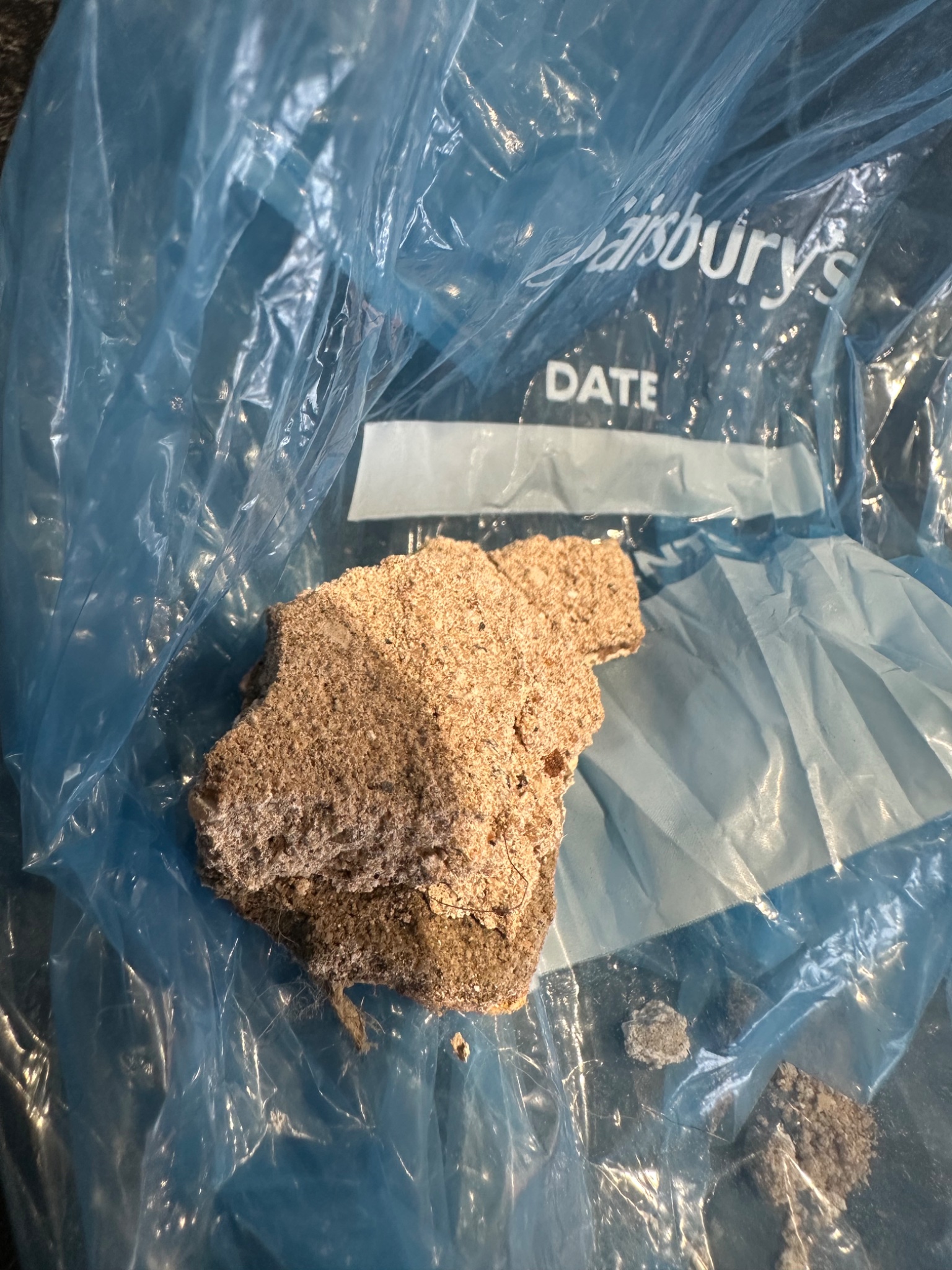

Hi, we have an ex council house built 1950-1966ish, it desperately needs replastering as a lot of the plaster has blown and is cracking. Reading on line it suggested plaster of that time could contain asbestos. Has anyone come across it? Of course I’ll get a sample tested before any is removed but was just trying to guage the likelihood of it.
We did have some plaster removed in a downstairs room last year which contained what looked like hair. I sent a piece of this off and it came back negative for asbestos but reading online has me a little worried other rooms could contain it.
Not my area of expertise... but... I thought it was artex which (once) had asbestos rather than plaster.
Thank you for replying. I’m getting very mixed messages reading online. The plasterer I’ve spoken to doesn’t seem too bothered infact he said don’t bother testing
Online research will usually be mixed, IME most tradespeople don't seem to care about asbestos. 'Don't bother testing,' is quite frankly ignorant advice.
Only an asbestos company can comment on asbestos. Getting someone to come round, take a sample and advise is worth it. I do that before every big job, following a very bad experience with a heating installation.
If your plaster has asbestos, it is most probably the low content type and only a hazard if disturbed. So just get someone to come round and sample it.
Thanks for the replies. I’ve sent this sample off to be tested. It looked like there was 3 layers yellow, grey and pink. The sample I had tested last year didn’t have the grey layer so I’m now a little worried. This was taken from a corner next to a chimney if that makes any difference? There was never an open fire in the room just a chimney stack from downstairs up into the loft

The original plaster on the wall is coming away so needs removing and re plastering. It concerned me there was 3 layers to this sample whereas the last one that was negative didn’t have the thin grey cement looking layer

I’ve had plenty of asbestos training and we have been told previously that it can be in walls/plaster. Only way to know 100% is to have it tested, although as per @Deluks it’s unlikely. I work in social housing and don’t recall it being in any of ours, some artex however does contain the material.
Just get a professional to come round, and give a full asbestos survey. Chipping off a bit of this and that, is just causing undue worry.
