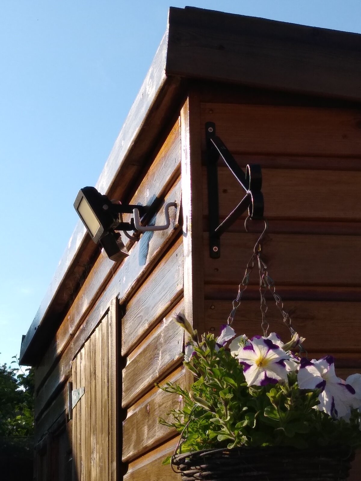

I want to put up a flagpole onto my shed. I've attached a pic of shed. I want pole to go vertical, so it will have to come a little bit due to roof. Is there anything that I can just buy off the shelf or not Regards Doug

havent got a clue but think things like
"cranked offset or extended flag pole brackets" may give you some luck
I have a 6m flagpole, the diameter is about 30mm at the lowest section. I think it is carbon-fibre reinforced resin.
I got some 32mm pipe clips. Readily available, cheap, easy to use.
To space it past the roof overhang, I recommend you bolt a length of fencepost or something to the shed, and screw your clips to that. It will be a better, straighter, more level and much stronger material than the shed cladding. Bolt it to the cornerpost or a stud if you can. You can get munsen rings at higher cost, but leverage will tend to rip them out.
If the pole moves in the wind, you can brace it with guyropes, possibly to the further corners of the shed.
