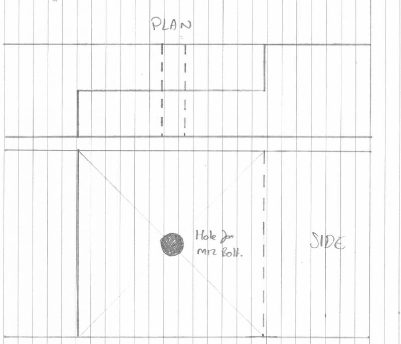

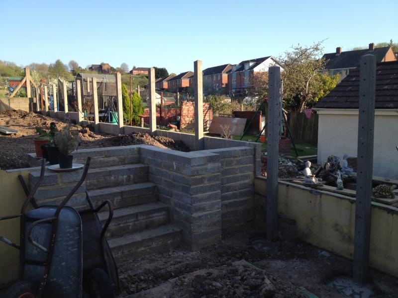

I intend to use a halving joint on a 2x4 rail and bolt this to the concrete fence post by drilling a hole for a bolt to go through the lot. I intend to use large washers to spread the load on the wood side. I have assumed an M12 bolt as the diameter for the holes in the post are 15mm.
This is the post I intend to use (universal on the left, not the repair spur)
This is the detail i intend to use
Any one got any ideas of how to strengthen this joint?
Screw the joint together using a few 1.5 inch wood screws? glue?
Should I go back to the drawing board...?
