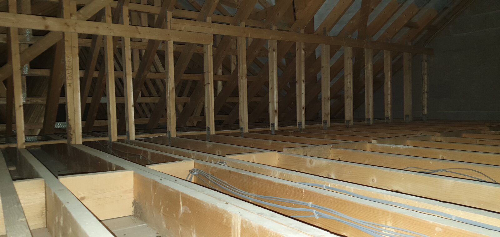

I'm looking to start to floor my attic for extra spacing. I've noticed that the house has a lot of bridges between each joist. The issue is a lot of them are higher. Some are a few mm, but others are 10-20cm above the joist. I've. Included a photo below.
What is the best way to get round this? I don't want to raise the floor as its a big area an the stilts and rails will be very expensive, plus it's only an area for storage not living in.
Cutting them will be fun at the angle plus the amount of them (they are 5 rows all the way down the full length) and the insulation was added before I started.
I had thought about trying to rotate them, but know will prob cause a lot of plaster board nails underneath to go leaving a lot of ceiling to patch up.
Any ideas on how to speed this up would be welcome

Lay / Cut the new loft board flooring around them.
OK, a trip hazard but it's a loft for storage.

Yea was a lazy finish. Would u just use a large plainer to get them down? Or would you saw them off?
Screw (nailing and too much vibration can crack the plaster board joints) 2 x 1 roofing laths on top of the joists and floor onto those. Sawing those flush will be a nightmare and a slow job with a multitool and not much better with a recip - planing them will be very messy. The longer you spend up there on your hands and knees the more likely it becomes you'll stick a foot through the ceiling or get sore knees

Are you talking about laying those on each joist the direction of the joints? Or over the top of them going direction the boards would be going?
Either way that's a lot of wood for the area
Direction of the joists I would imagine.
That’s what I would do, it’s not actually much wood as you would get 48 strips 8 feet long for the same parox weight of a sheet of ply.
quick to add as well, it just needs a couple of pins to hold each strip in place and the boards would screw through them.

Ok I would need x64 4.8m lengths.
I would also need to peal back a layer of insulation as one roll is laced over the top of the joists.

It's 2 x 1 slate lath, which is about the cheapest timber section you can buy. Bear in mind you stated 5 rows which is an awful lot of trimming in a poor working environment
Yes, but you will surely have to do that to get at all those noggins or place the boards, won't you? And if you have more than a few noggins to do, as is implied, the risk of injuring yourself or putting a foot through or whatever is a real risk.
So why don't you try planing a bit off one and try modifying another bit with a multitool. You can then gauge the amount of work involved working across noggins in a loft space and maybe some of the pitfalls
Or perhaps as this is just for storage board just up to one side of the line of noggins, then start boarding again at the other. If the noggins are in more of less straight lines you won't lose that much usable floor space
