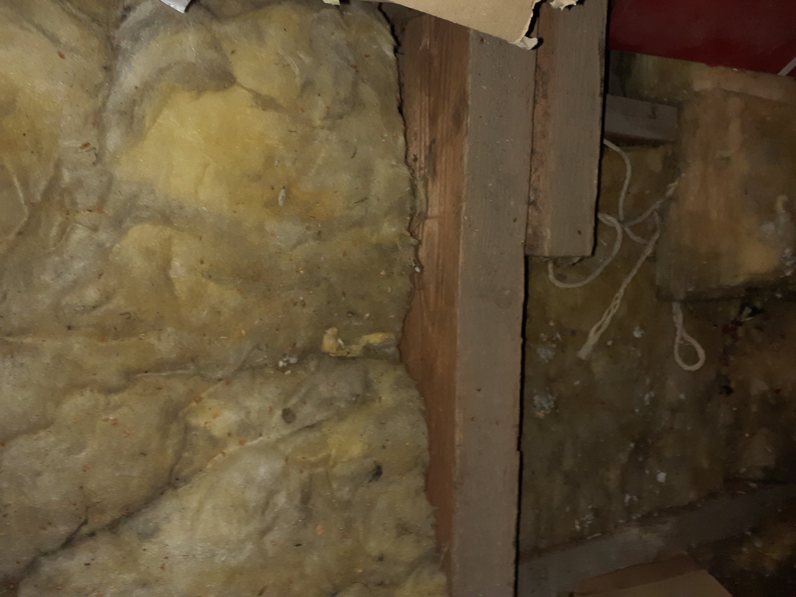

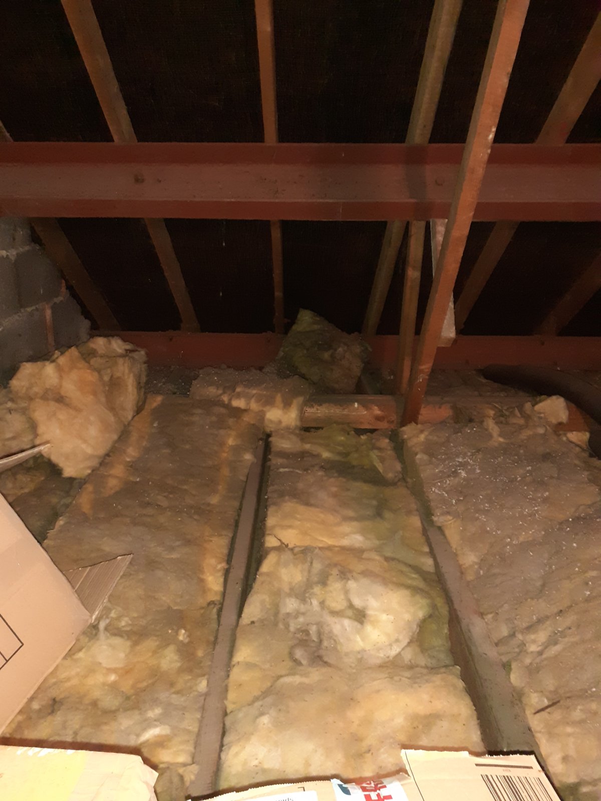

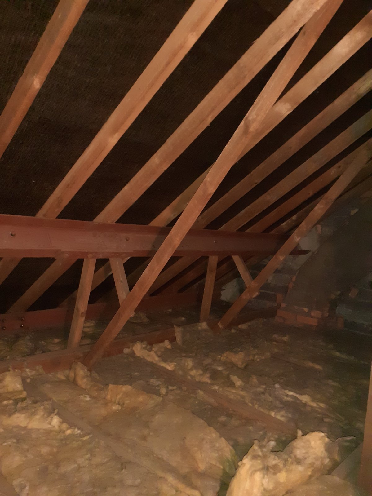

Hi,
I'm in the process of renovating my house which has meant I've started to accumulate a collection of tools. I keep some in the shed but I need to find a home for my power tools and tools I want to avoid rust.
I need somewhere to house them when I finish all the work I'm doing. The original plan was to build a insulated lean to shed onto my house which I could heat and store everything in there. Unfortunately to do this I would need planning permission as I live in a conservation area.
I started to think of storing in the attic but there are a few cracks in the upstairs ceiling where I've been up there to get christmas decorations etc. So I'll need to strengthen the ceiling joists and probably add some more insulation.
The joists are 4 x 2 and span approximately 5.5m. All walls upstairs are not load bearing so can't count on them for much support. I was thinking of gluing and screwing some 4 x 2 on top of the exisiting but the problem is I have what appear to be three strong backs (one either side and down the middle) running across the ceiling joists. This means I can't add new 4x2 in one length and no support would be added at the centre of the ceiling joist.
I was thinking of adding loft stilts and then 4 x2 along it so I could clear the strongbacks and then board but don't know if this is a good or bad idea.
I've included some images of my loft and any help would be great.
Jason

Have you got the headroom to create a superstructure with chunky timbers (possibly JJ Ibeams or similar) spanning between the gable ends (dunno what that span is so can't suggest what you'd need). First thing to check- could you actually get timbers the required length into the loft without major hassle?
How heavy are we talking 4x2" is massive in terms of ceiling ties, do you have a spine wall?
The overlapping joists in the first pic suggest a spine or supporting wall
Blup
Span between gable wall is about 5.8m. I should be able to get some new joists up there.
