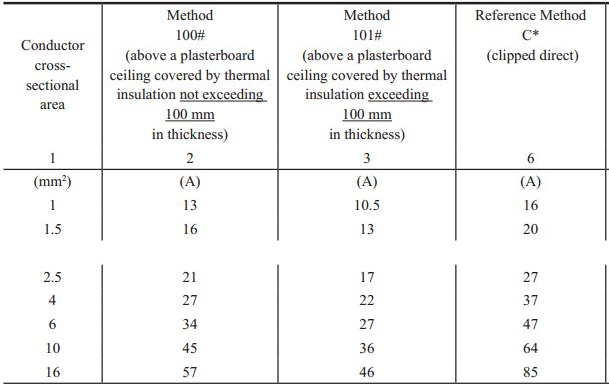

Hi all, I currently have 100mm attic insulation and would like to top it to 300mm in total. Problem is electrical cables are running on the existing insulation with very little slack.can the insulation be laid over the wiring without a fire risk. Thanks

Cables enclosed in insulation have a lower current carrying capacity, something that matters a great deal for a cable feeding something like an electric shower but a lighting circuit might be OK, are the cables clipped to joists or just sitting on top of the insulation and do you know what they're feeding?

Lift the old insulation and lie the cables directly on the plaster ceilings. You can put insulation over it if it is uninsulated on one side.

But take extra care with the shower cables as they carry a heavy load and will get warm. Perhaps put something rigid on them to ensure the insulation does not engulf them. If you have any downlighters coming through the ceiling you can buy hoods for them, or if you have plasterboard handy, make open-bottomed boxes to cover.
Lighting cables carry very small currents so not a worry.

I do think the showers details ought to be investigated before covering the cable with 300mm. of thermal insulation.
Laid on the top as at present being the equivalent of Method C.
