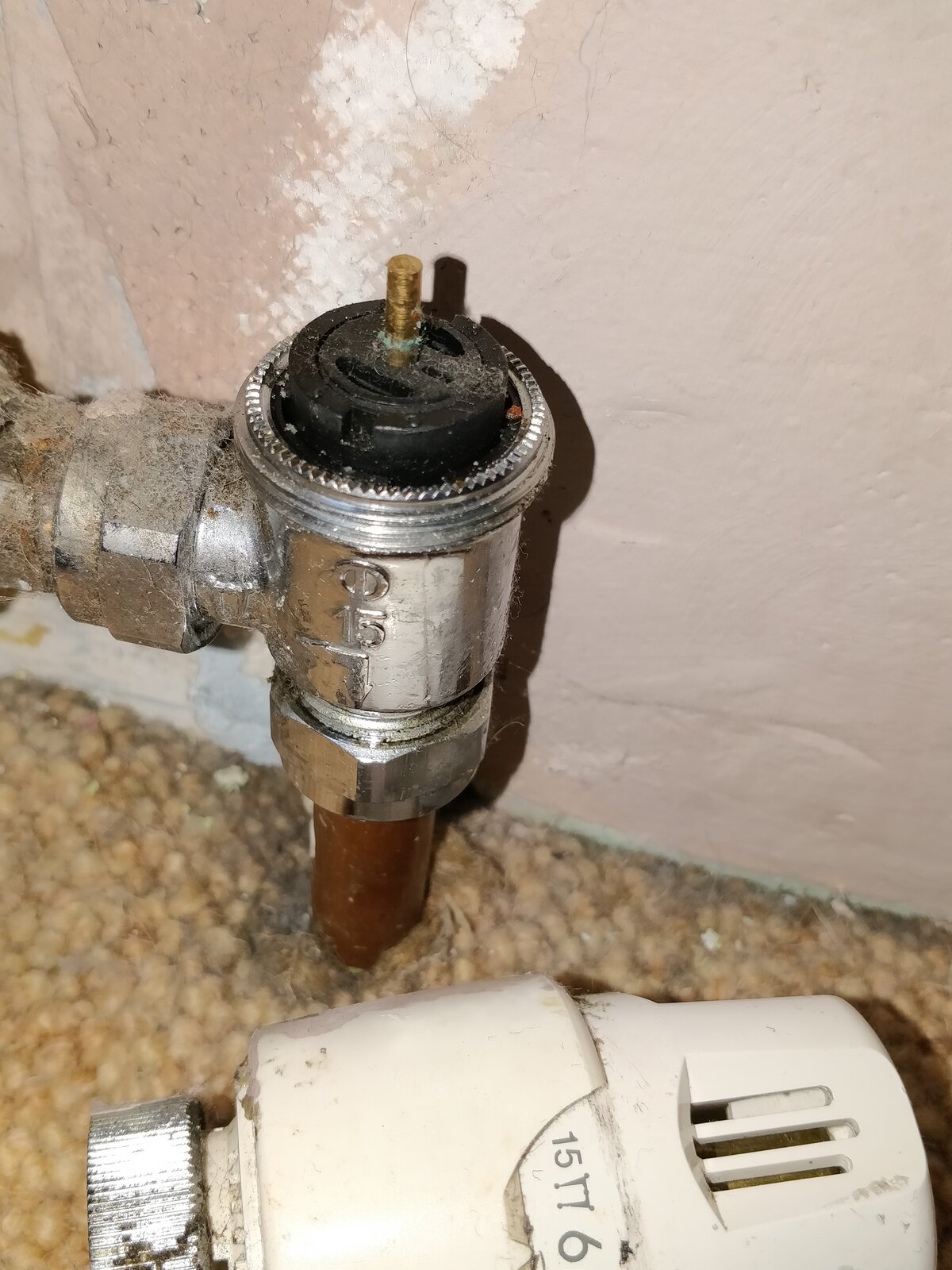

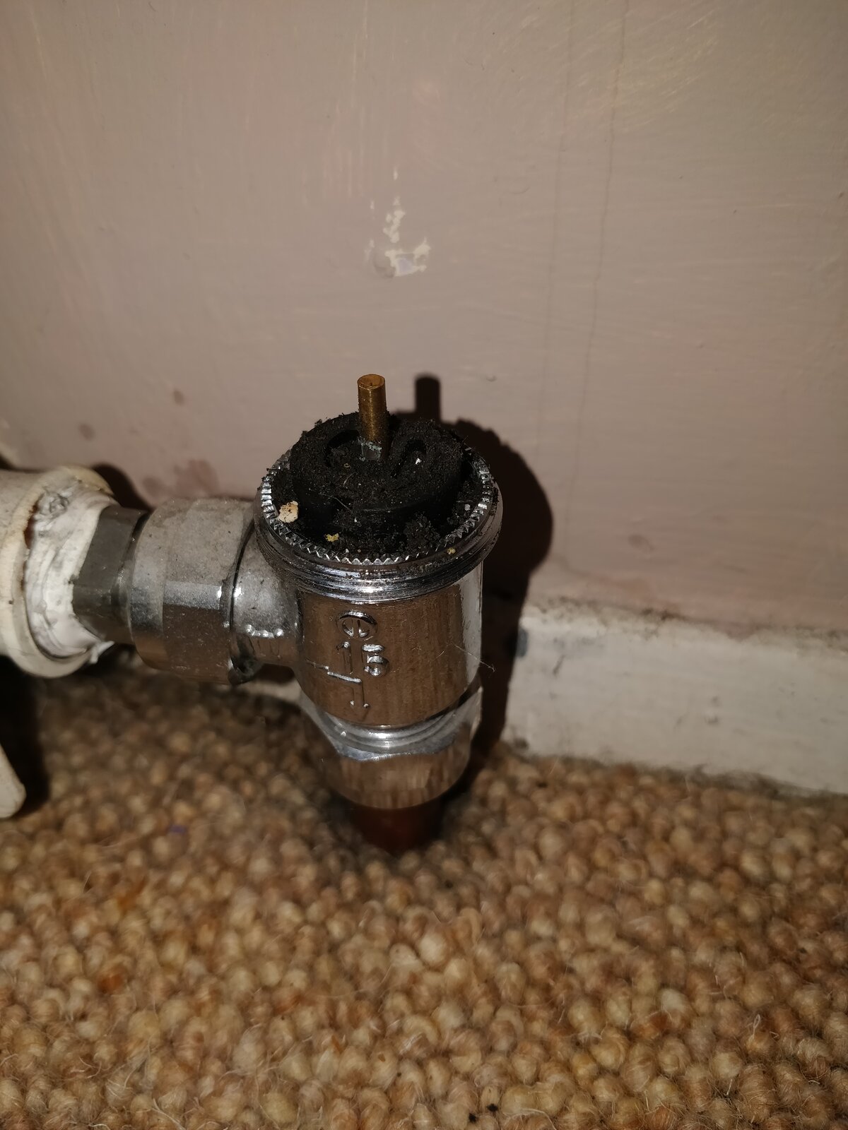

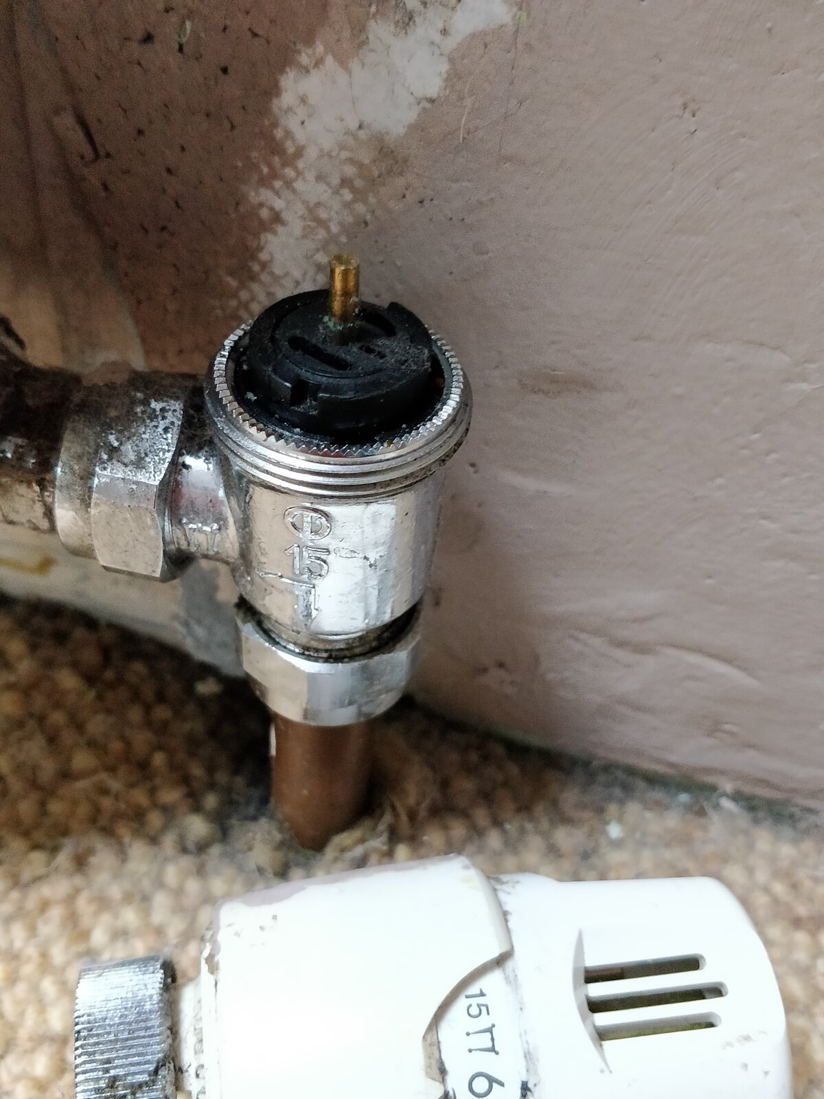

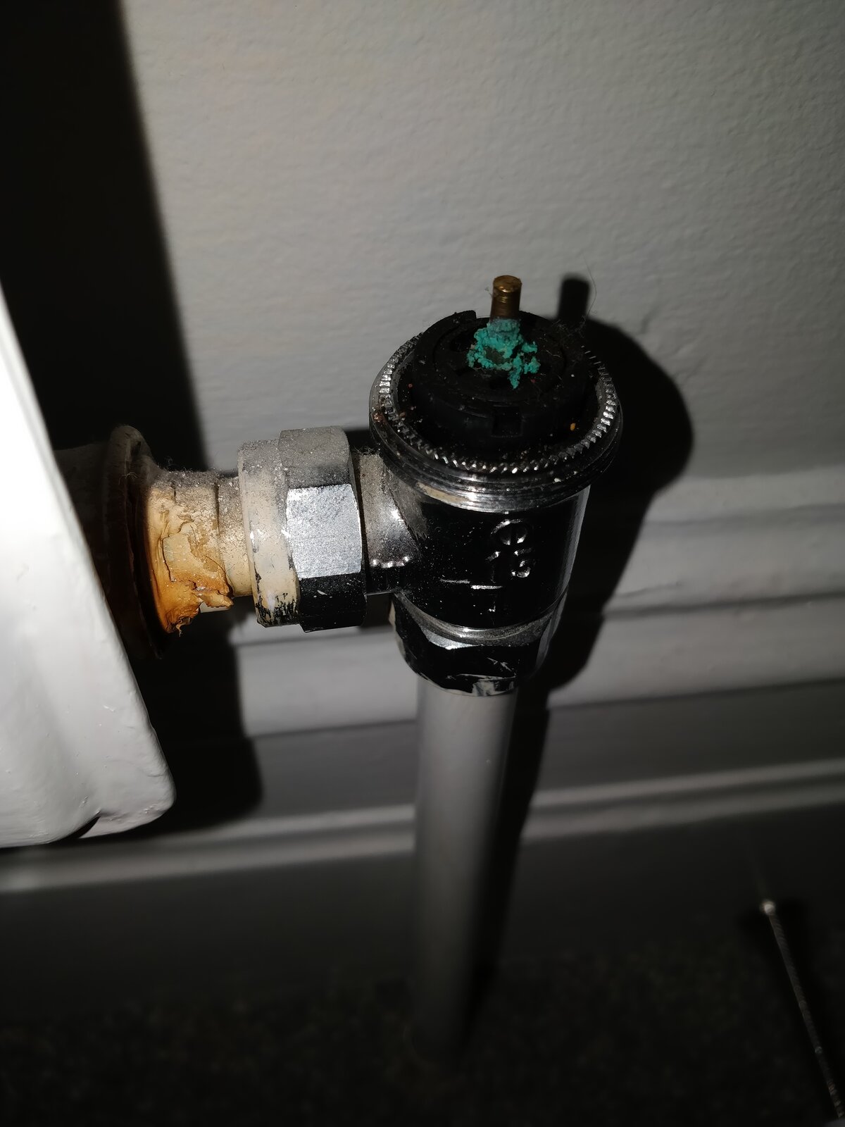

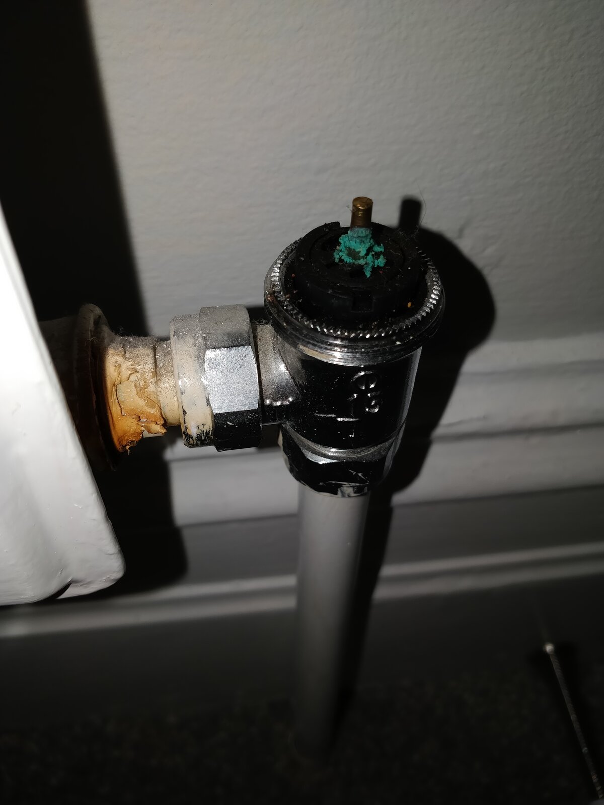

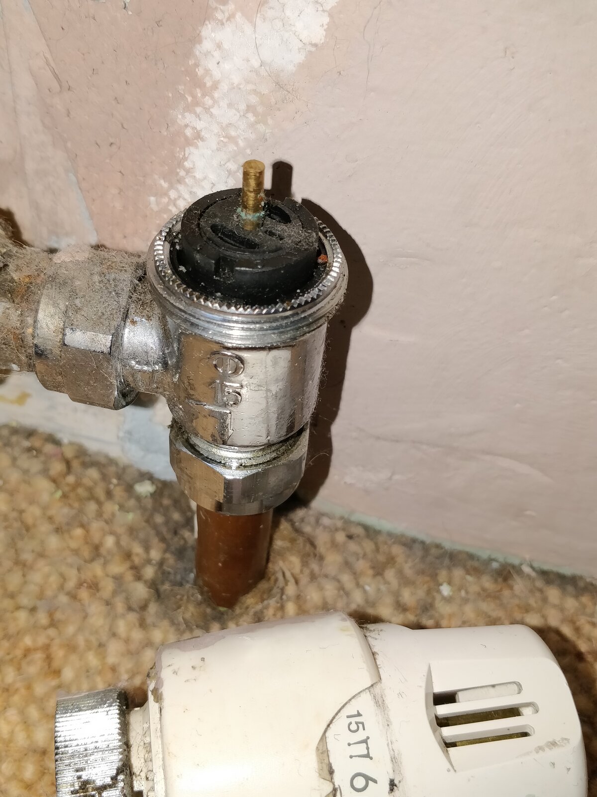

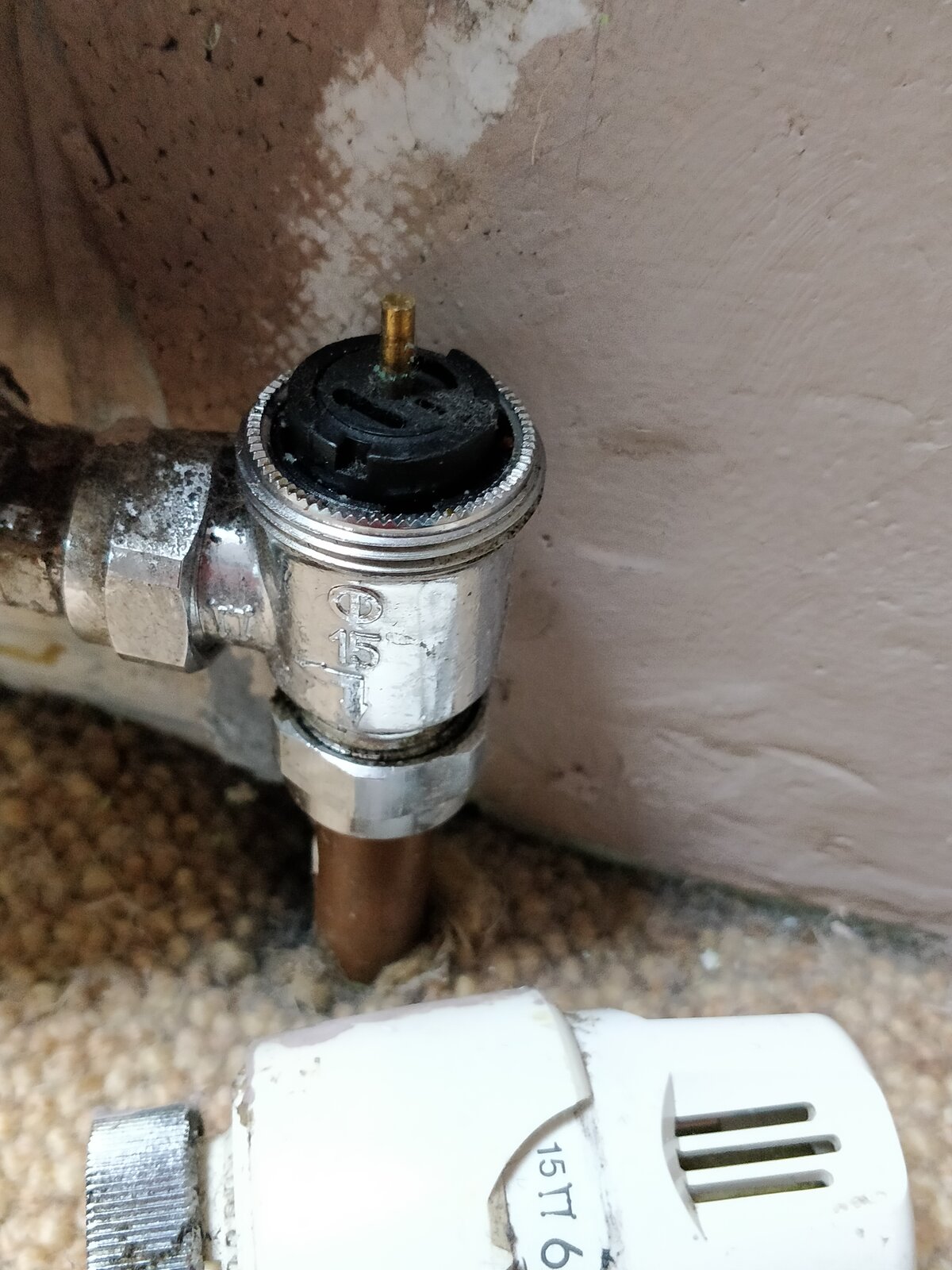

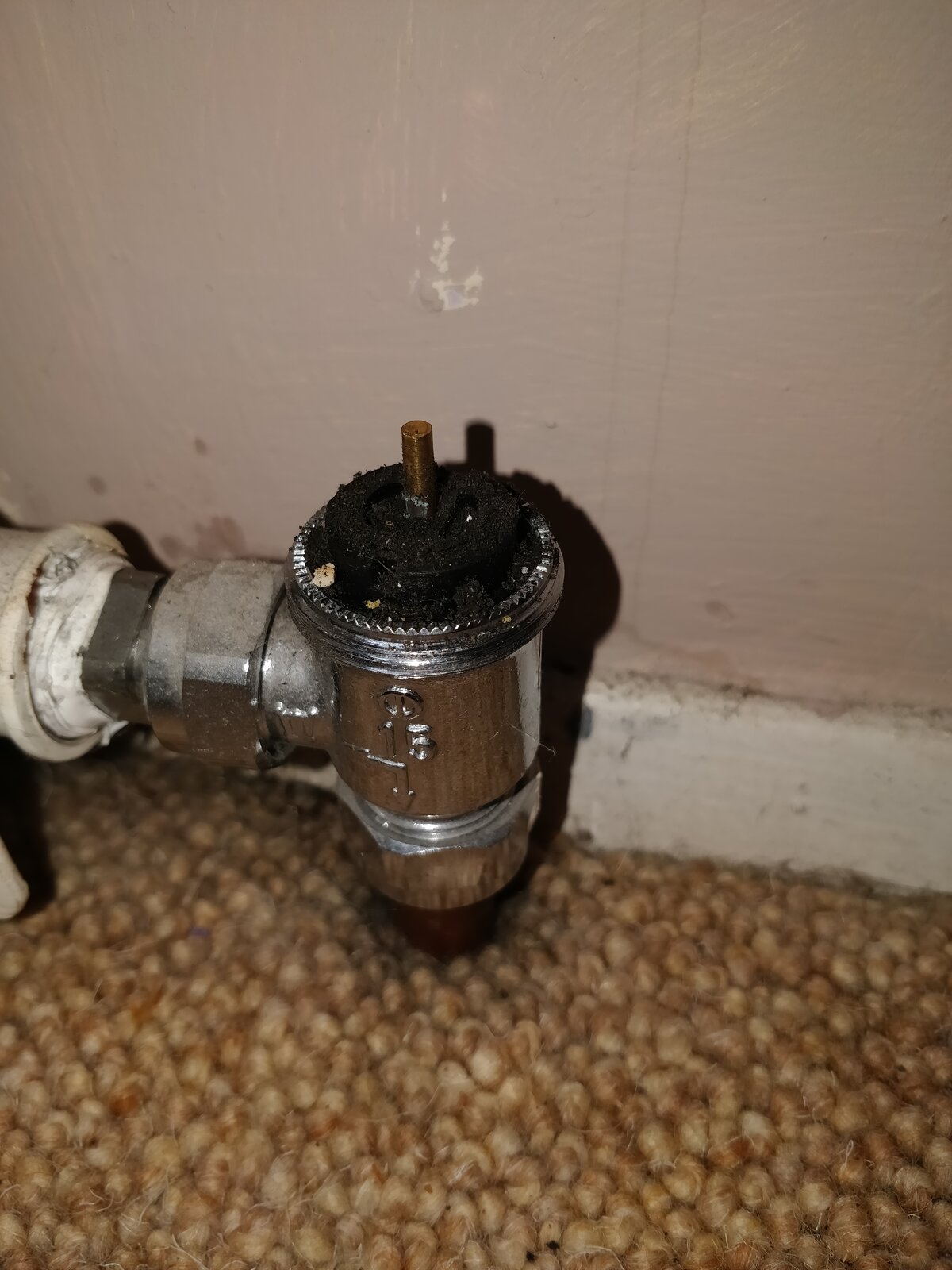

I have taken the tops of the TRV's off on the older radiators (dating from early-mid 90s) and I have noticed some oxidisation - could this be part of the problem? I have checked all visible pipework (in the cellar mainly, the rest is hidden under the floor) and no signs of leaks.
The ticking noise is highly likely to just be expansion and contraction of the radiators and may be related to the way that they are mounted and what they are mounted to. Are you sure that what you are bleeding is air and not hydrogen as others have suggested ? Is the water in your system dosed with inhibitor ?
I'm pretty sure it's not hydrogen, it doesn't readily ignite.
The system had inhibitor topped up in September 2020. The previous owners of the property had not maintained the system at all, however it was power flushed and inhibitor added when the new boiler went in last year.
