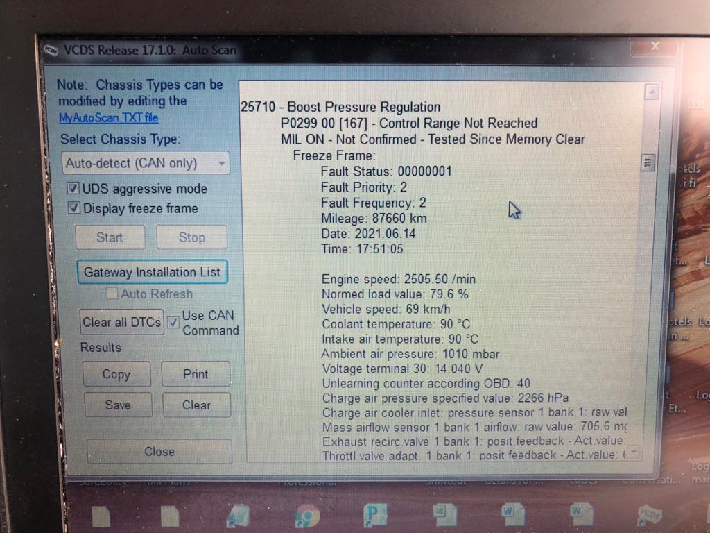

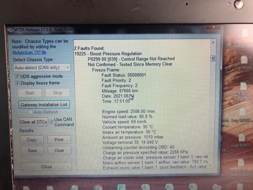

I have an Audi A5 2015 2.0 Diesel. It has gone into limp mode and Ross Tech Vag Comm gives the following error:-
019225 Boost Pressure Regulation.
The Car been to a Garage as it bought from a Dealer. The Garage say they replaced Turbo and cleaned DPF.
Upon driving it the same problem has appeared! Please see attached diagnostic photos. Anybody have any idea what the real issue maybe?
Many Thanks All.

As you have VCDS can you run a live log (While a 2nd person drives the car) choose "boost requested" and "boost actual" among the criteria to log. If the turbo has been replaced but is failing to boost this will show how much by. It is possible that the garage may not have changed the turbo actuator and it is also possible that they may not have cleaned debris from the intercooler if it was a physical turbo failure.
Other areas to check are boost hoses collapsing (delaminated inside), boost leaks and also make sure the EGR valve and the anti-shudder valve are not clogged with soot and operating correctly.
Was the replacement turbo a new one, or just a replacement?
I’d go for the large diameter air pipes from the intercooler to the turbo being adrift.....you can feel the boost pressure when you squeeze them.
Also look for the small air pipe going to the turbo actuator coming adrift or split.
