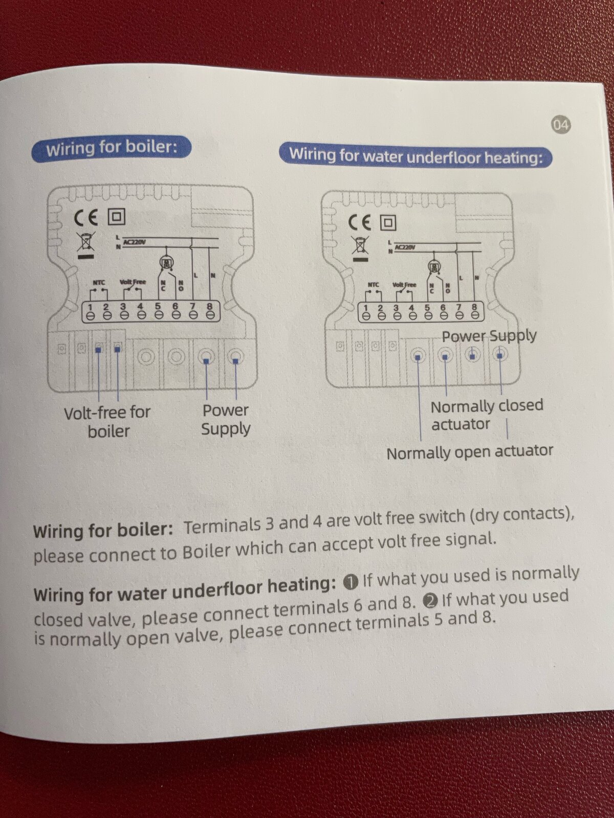

Sorry if this seems repetitive regarding fitting a Smart Thermostat but the examples I've found so far appear to be different.
I have a Danfoss RET 230P and would like to change it for an AWOW WiFi Smart Thermostat.
The wiring diagram on the new unit seems more complicated than ones on other threads.
Any help would be appreciated - I'm confused by the different terminology and labelling.
Thanks!
