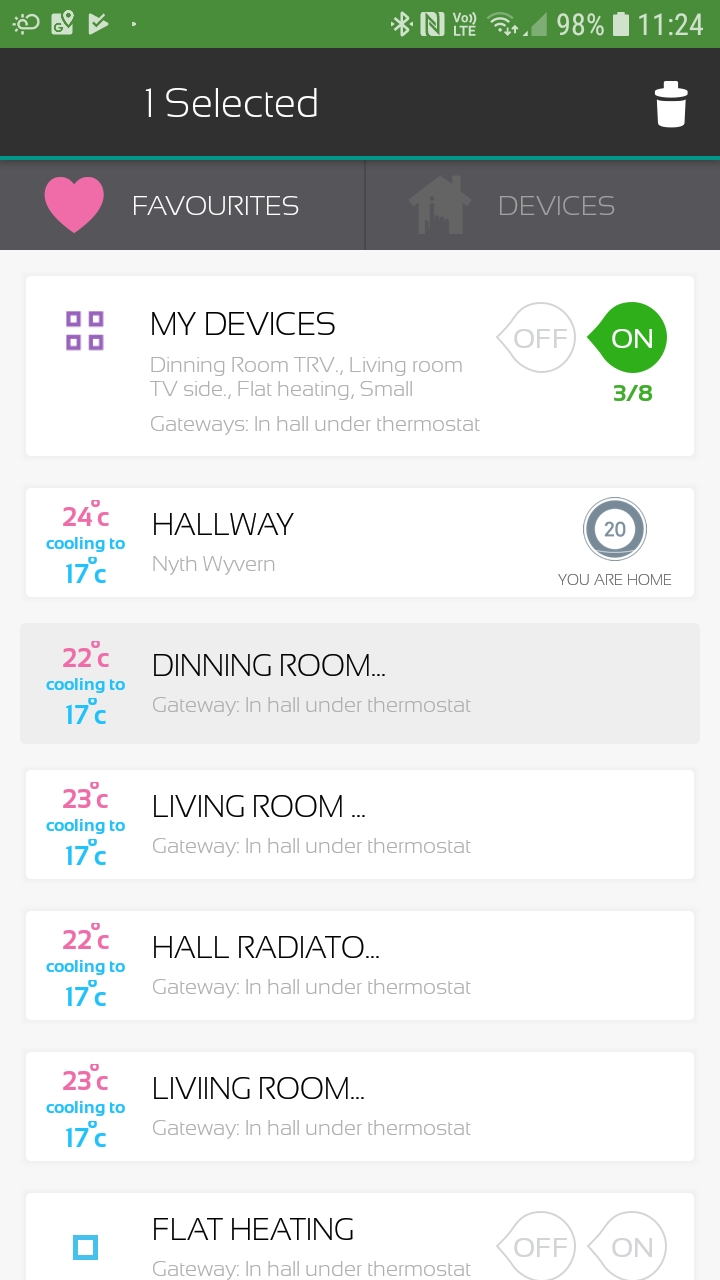

So with any old wall thermostat you can still control the home simply by altering the TRV head with phone/tablet/PC, at the wall thermostat does is stop the boiler cycling in the summer, so no wiring required, just replace the TRV heads, so you get something like this

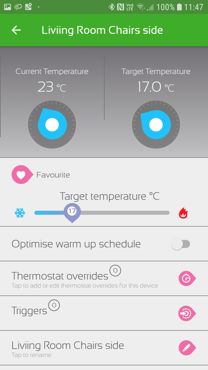

on your phone, the one that says "You are home" is the Nest wall thermostat ignore flat heating that is a socket, two radiators in living room that's why two you can see current in red and target in blue clicking on them allows you to set that radiator, and so that room, Screenshot_20190725-114727_MiHome.jpg thumb nail shows what it shows when you select, Nest wall thermostat can either be set with Nest software or the Energenie software. Yes with Nest I can change one which changes all, but without Nest I could still control each room anywhere in world where the phone will work so Nest is only really needed to turn on the DHW when I decide I want a bath when getting home.
