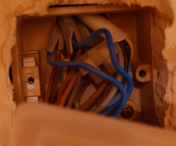

I possess a "Dremel" type tool, so would cut a slot right at the bottom of that lug, drill a clearance hole all the way through the back for the screw and glue a nut in the slot. If I didn't have a nut I'd salvage a lug from a metal back box (50p from Screwfix).
That would, indeed, be another way to do it. However, it would only really make sense if one felt (I would suggest 'pretty bravely'!) that one could get the tool in and cut that slot with all the wires in it, with the box 'in situ' without damaging any of the wires. If one felt (as I probably would) that it was only safe to do as you suggest after removing the box, then one might as well put a new box in! To remind you of 'access' ...
