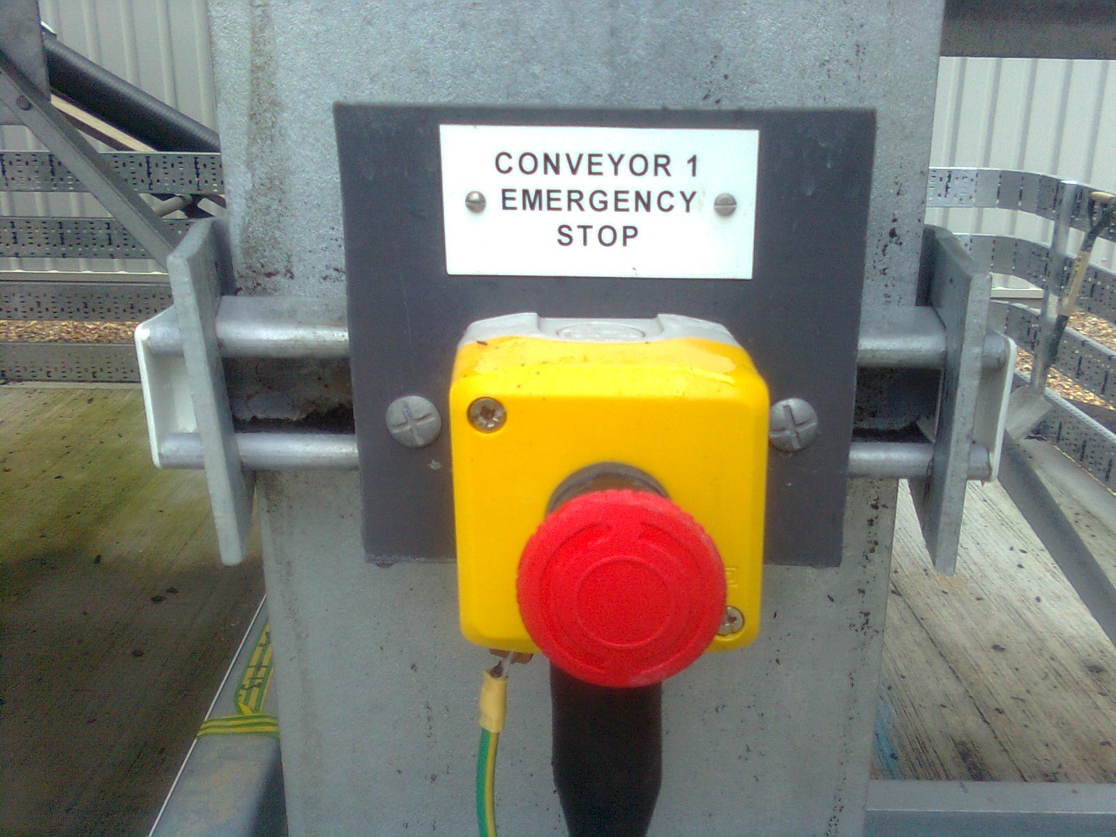

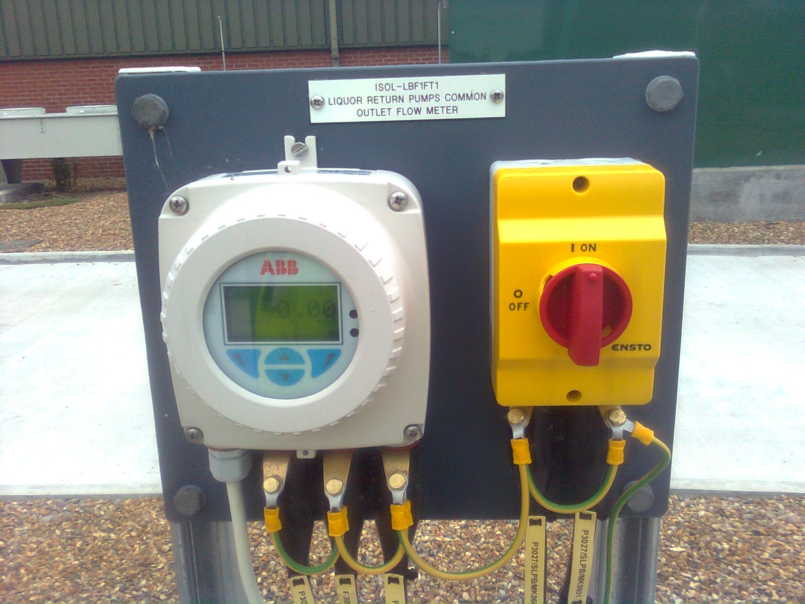

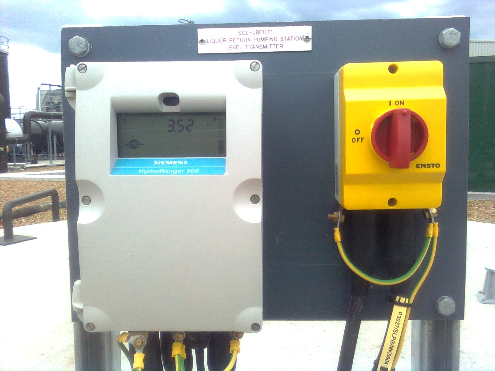

Some pictures from sites at work (not my pictures, found them in shared area)
All the same kind of board used.
None of it looks like acrylic
I've only ever seen it in that grey (as in the ATi example). I think its acrylic.
That example might be - none of your site photos look like it. I'd be concerned about the robustness of acrylic for your application. ABS might be ok
Can't you examine the existing stuff and see what it is/might be?
Liquor Return PS Level Transmitter
Liquor Return Flowmeter

I bumped into one of the contractors tidying up some bits and asked. Its PVC sheet. From here http://uk.rs-online.com/web/p/solid-plastic-sheets/7048217/
