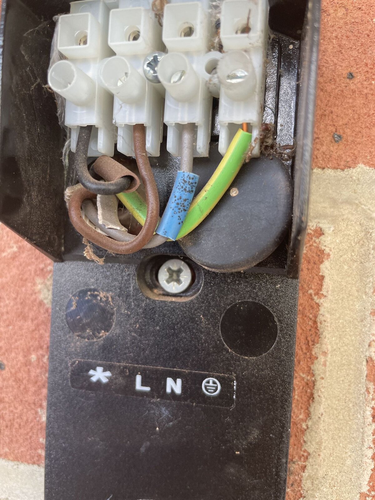

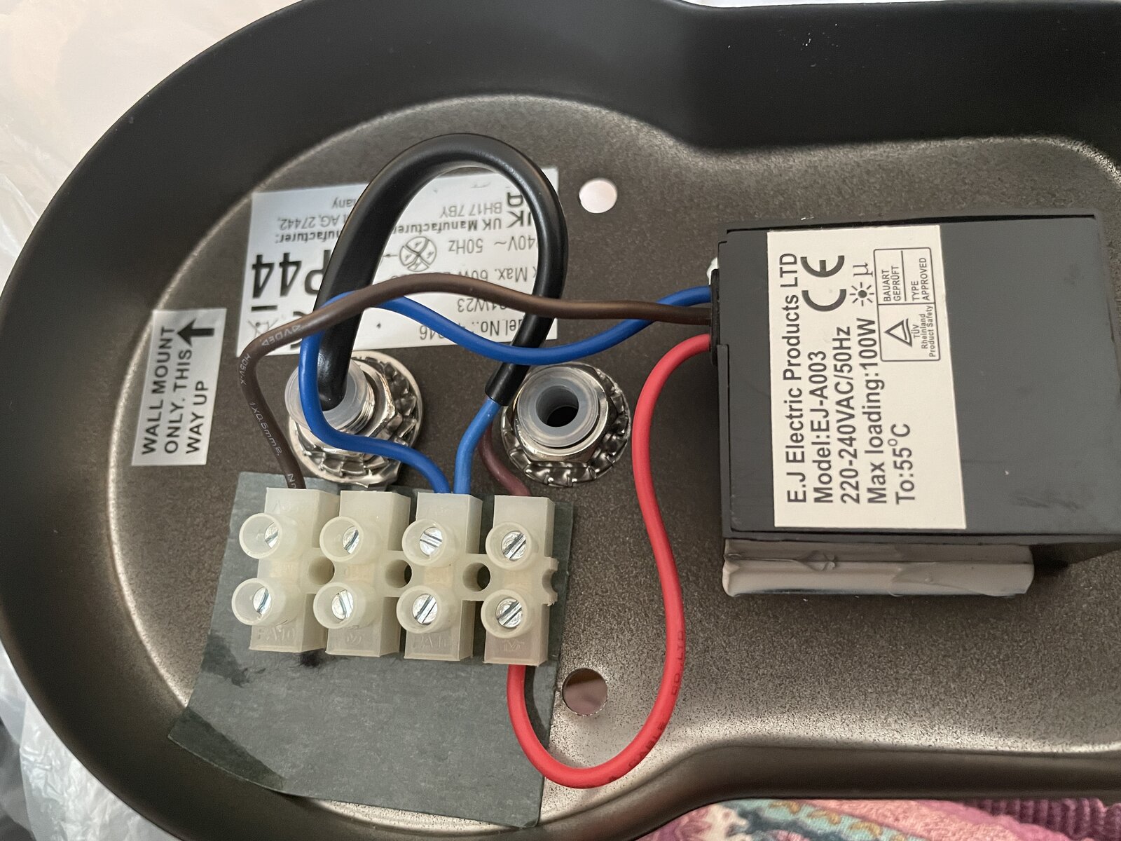

Hi,
I have an outside lantern which is connected to an internal fused switch. The supply wires are as per the image attached - there are 4 wires in total. I think the black with brown sleeve on the left is a switched live. The existing light connects to the connection block with 3 prongs (see image attached) so the earth is left unconnected.
The new light however only appears to have a connection box for 3 wires (See third image) and I’m uncertain how to connect my 4 wires. The second connection contains an earth connection to the adjacent fixing.
I’ve been advised the following…
from left to right on picture ( top to bottom as fitted on wall)
brown
green/yellow
grey (blue sleeve)
black (brown sleeve)
As the 4th terminal already contains two connections : red bottom (to the PiR) and brown top (to the lamp) do I simply leave them in place but share the terminal with the red wire inserting the black (brown sleeve)?

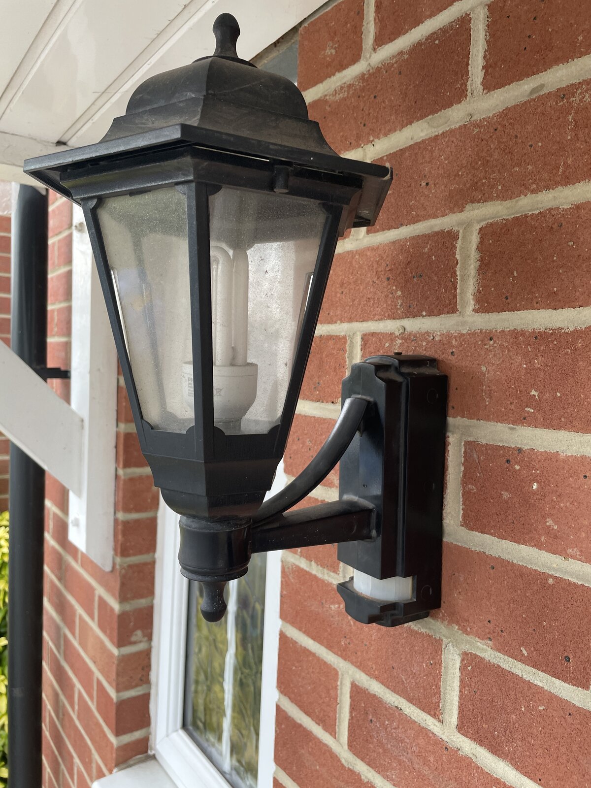

Thanks for the response. We moved into the property last year so the old light was already fitted.
The old light had a sensor (so Im assuming it was a PIR) but whenever I turned on the switch inside the hall the light was permanently on. This may have been the settings or it was simply broke.
See attached for image of old light -you can see the sensor at the bottom. Also inside the old light there is a box with 3 wires connected to it.
Im not aware of any other light being part of the circuit
It looks like that is the way it was wired so when the switch is off the light is controlled by the PIR - if it works.
If you want the same, then:

So the switch is only used to switch the light on permanently. When the switch is off the power is still being supplied to the light by the brown cable and the PIR is in operation?
Yes, it was. No permanently off.
Most PIRs nowadays allow permanently on by flicking the switch off/on once or twice - also allows the light to be permanently off.
What do the instructions say?
Yes.
A picture of the switch wiring would confirm for certain.
