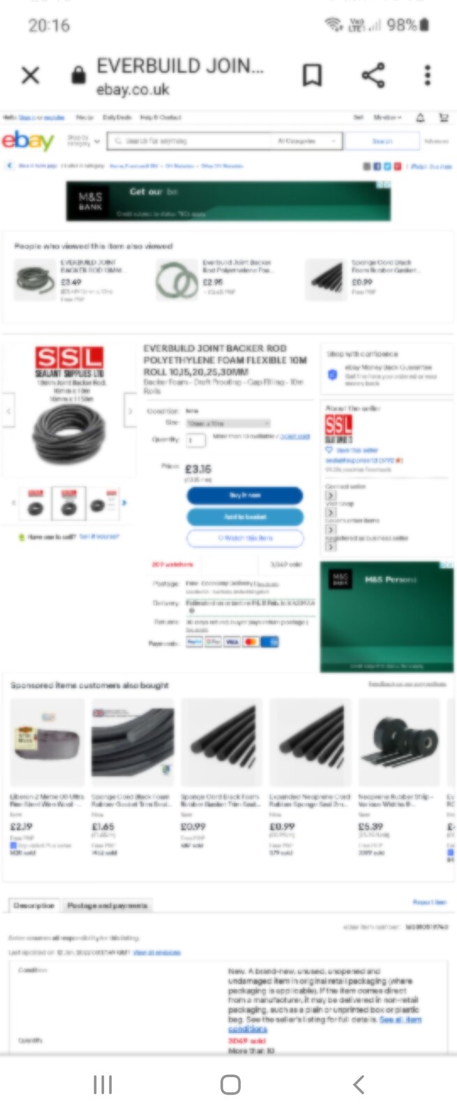

I am re-doing the silicone on my bathtub and upon removing the silicone, I have seen cracked or missing grout/filler behind the area where the silicone used to be.
After doing some research, it transpires that grout is non waterproof and should not have been there in the first place. So, I now intend to chisel away the grout and then squeeze in a backing rod and then apply silicone on top.
The problem is I cannot find backing rods in Screwfix/Toolstation or B&Q. Can anyone post links if it is called something else by these places?

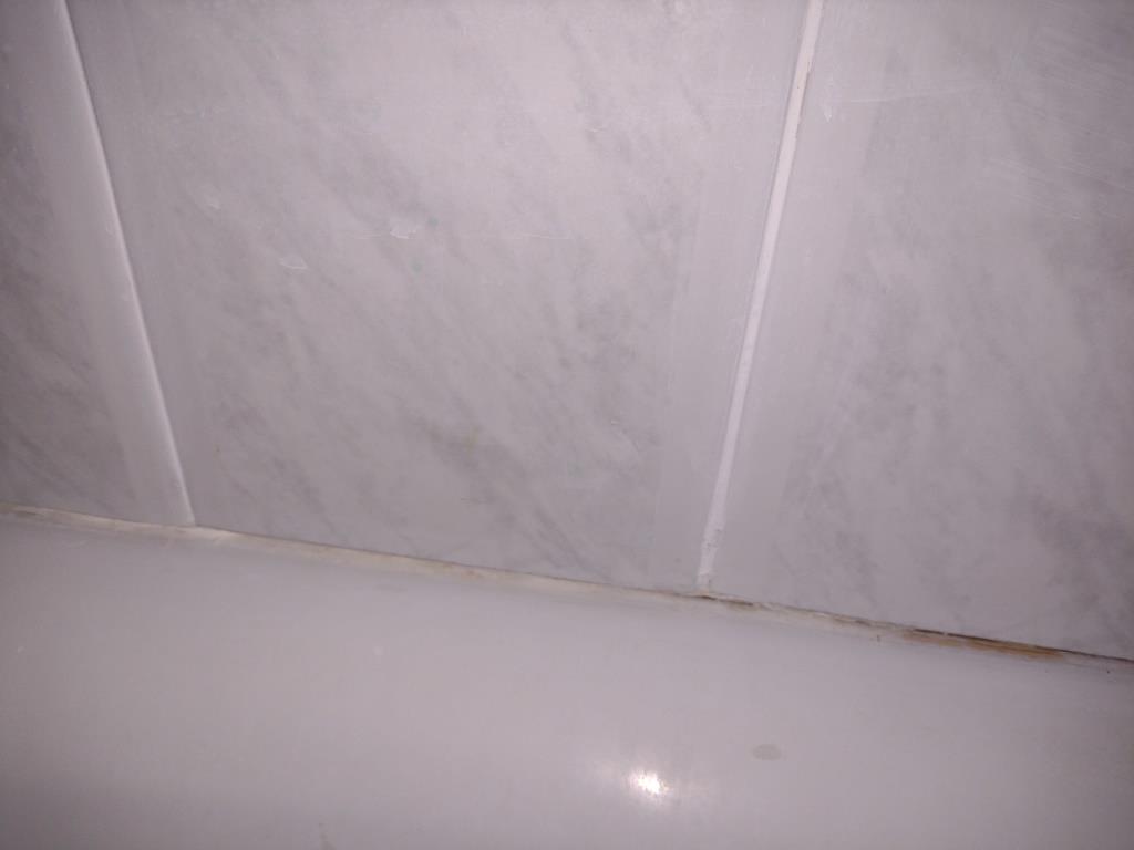

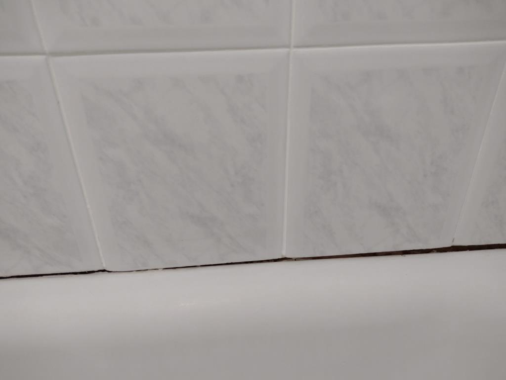

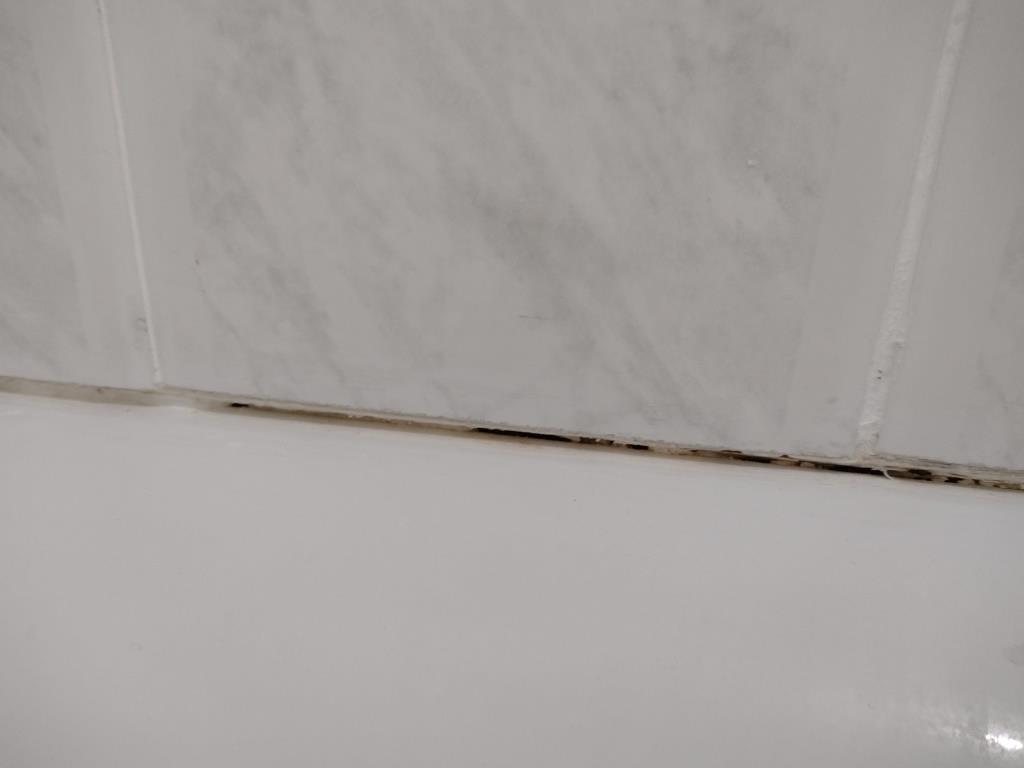

I have chiselled off the already cracked/mouldy grout.
I will post a pic to show where I stand.

There is half an inch gap between the tub and the wall and there is also the gap between the tile and the tub. This was previously filled by grout ( I think ) . The silicone sat on top of it.
Now, do I use tile adhesive grout or Easifill filler and then silicone on top ?
Which was why I suggested the quadrant moulding - it will hide and seal all of that neatly.
That looks like a metal bath, is it?
OK, the gap doesn't really look that big in the pics but anyway, there's nothing wrong with a big silicone seal it'll just take longer to go off and will take some more skill to make sure it looks good, you can use a backer rod if you really want to then I guess to prevent wasting silicone and it just being squeezed down the gap, the silicone quadrant just needs to lap onto the bath and the bottom of the tile by a mm or so. There are a few threads no here about getting a good seal around the bath which would be worth searching for, meticulous cleaning beforehand, some masking tape to get a perfect line on the tiles and bath, fill the bath beforehand, good quality silicone and a wet finger.
