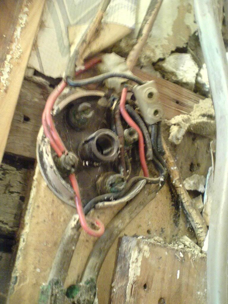

This JB was a disused one, left behied disconnected after a previsons rewire of the kitchen lighting circuit. The cables were VIR, & were: a feed to the JB, a SR, a feed off to another jb, & the feed to the kitchen light.

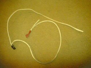

Bad Practices - Number One: Incorrct termination of conductor.
I would say that using a ring crimp would make a better connection.
Also on a side note, the brazing on that pipe looks poor. Is it a gas pipe :?:
