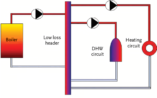

Do you have just one pump?
I have three. One to the right of the low loss header, flowing out of the boiler.
One on the return central heating pipe, and one on the return hot water cylinder pipe.
I have 20 rads in total spread across two floors, so I might need cp2 instead of one. I just don't know if I need that on both pumps or just one.
Ah that's a bit different, I don't have a LLH so I'm guessing that you have something like this (except with the pumps in the return instead of the flow).....
.....Which is a different beast. I'm not sure about the pumps here as have a very limited knowledge of this type of system. AFAIK, the boiler pump circulates water through the LLH and back to the boiler, so what isn't pulled off from the LLH by the HW and CH pumps goes straight back to the boiler return. So, if there wasn't much water being pumped away then much of the flow would go straight from the boiler through the LLH and directly back to the boiler.
If I had to guess I would think that reducing the CH pump would mean reducing the LLH pump too. But that's just my guess and could be completely wrong here. So I think you probably need a LLH pro. to advise here.
