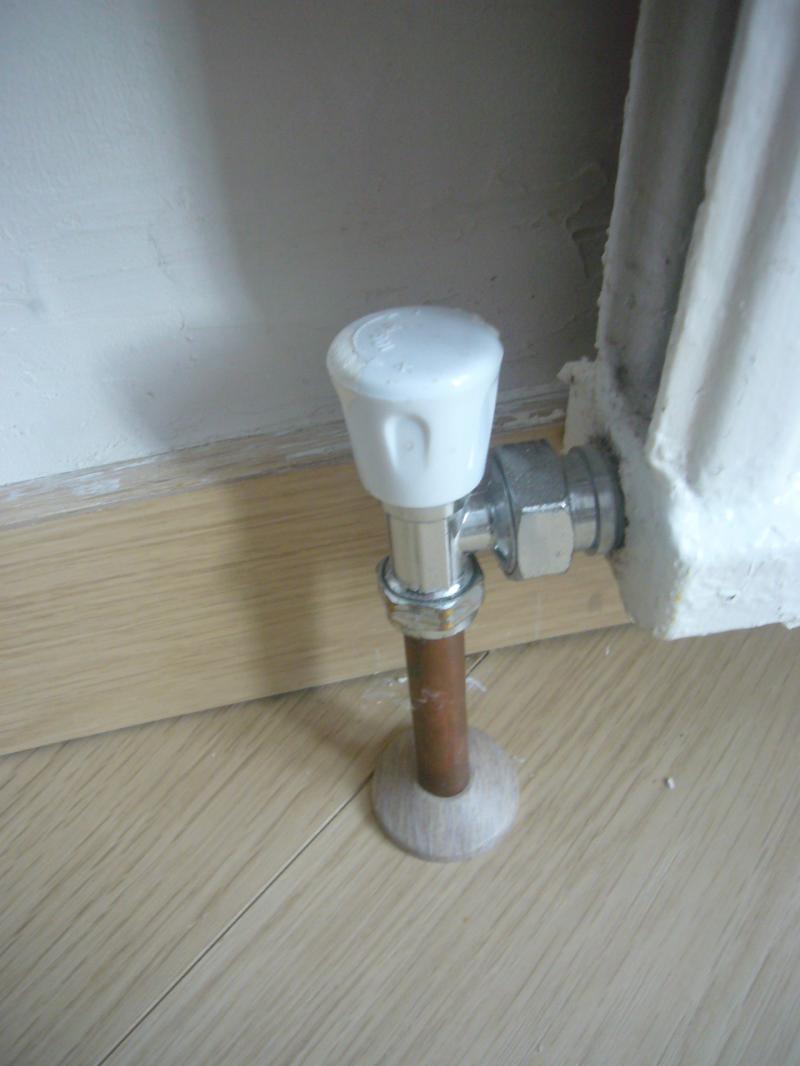

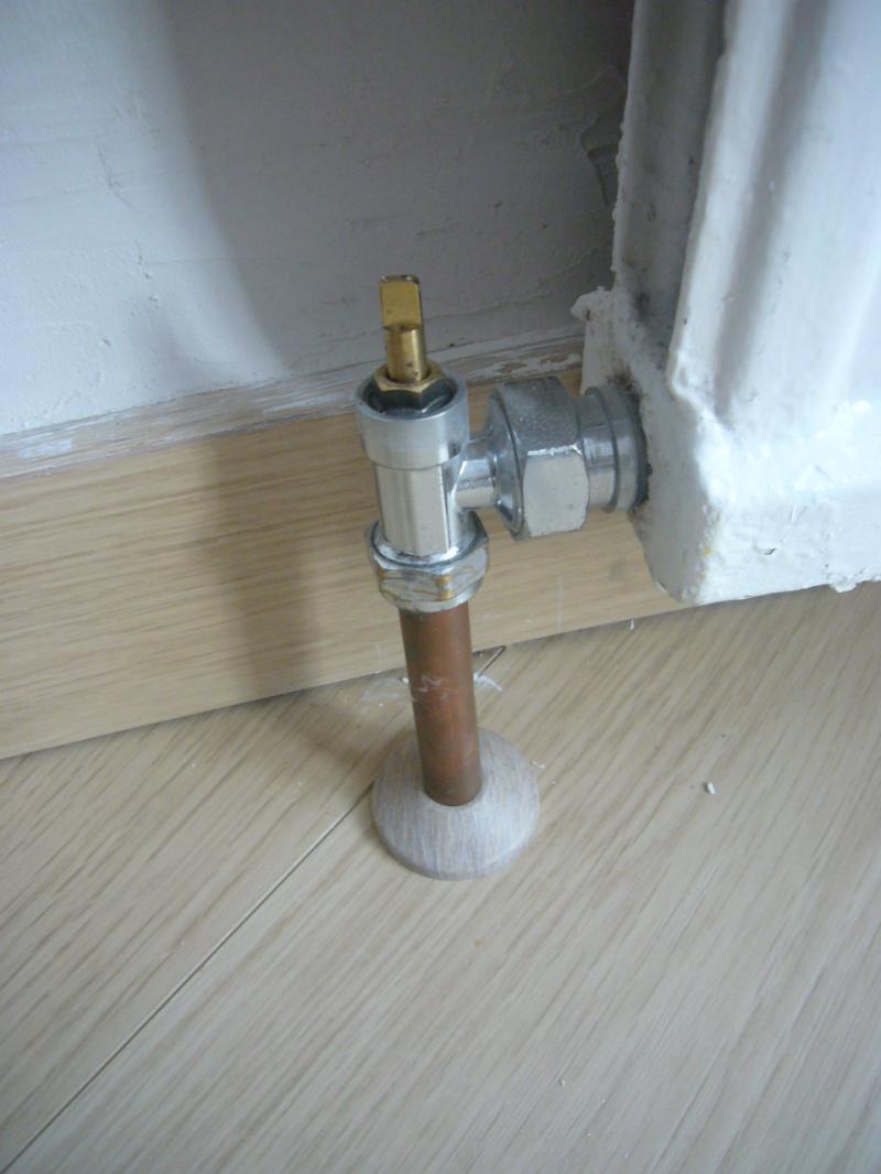

1. Do I need to remove the cap of the LSV in order to adjust it? A lot of articles advise to do so, but I can't see any point. The cap seems to adjust the valve fine.
2. Do I measure the temperature of the (vertical) pipework leading to the LSV/TRV - or the valve/pipework between the LSV/TRV and the rad?
Thanks.
Hi
If the other end of your rad has a TRV on it then that is not a lockshield valve
(well it is but it has the wrong top on it)
it should look like this
what you have at the moment is a lockshied with a manual adjuster on it, so as you have said,no need to take it off to adjust, you should try to get a proper cap for it though
you measure the temp on both sides of the rads (pipes) and note the difference
