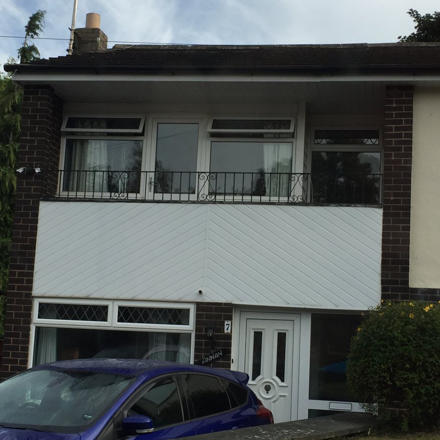

I say beam I'm hoping there is some kind of support under the White upvc cladding. This may help, we want it to look like the right hand side of the house, pic below
So we want the cladding/railing/Windows/door removing. We then want it bricked up (block will do) then rendered over and a similar size window to what's on the right hand side.
What I am curious of is what's under the cladding sitting on if there's only standard lintels can I use them?
The structure is obviously designed to take a live load, and not holding up the front part of the roof, but as to whether the glazing is structural to the roof is another matter. You would probably get a better idea by looking in the loft, but the step in the glazing would suggest it probably isn't. You could probably infill in timber frame off of what you have there.

Appreciate the advice. Yeah I've been in the loft via advice from the neighbour whose a retired brickie (there is a beam full length spanning from pier to pier (which holds the roof I assume)), also picked his brains as he was around when the house was built, he seems to think if remembered correctly there is 2 lintels which both rest on the middle pier and obviously span retrospectively over the door/window and dosent see any reason why they won't hold the load above? I did look into doing it with timber but would rather do it in block (also thought it would be warmer?) as we want it rendered and unsure what to fit onto the exterior to render over?
Wont make a difference to the insulation, in fact you could probably acheive better u-values with timber frame. You can render over it too. But whether the balcony floor can take the weight of a cavity wall is unknown until you open it up.
Wont be that difficult to span a beam between the two piers though. But would add to the cost.
Again what the lintels over the glazing are holding up is another consideration
