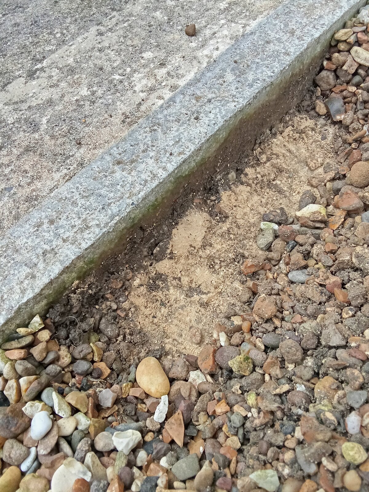

I have never done paving before... but it doesnt seem to be a difficult job. I have a few simple questions and I hope I can get help here.
It is a very basic project (front yard of around 10sq meters) currently covered with gravel. Thinking to remove the gravel and lay slabs.
1. Can I compact the sub base somehow manually without a plate compactor? Simply because it is just 10sq meters... I don't think it is necessary to hire a plate compactor, also, it is very low traffic front yard (only humans walking through it occasionally), and also some of the bits would be hard to reach by a compactor (like corners and around the drains).
2. If I go with slabs, can I do so called dry laying? I have seen projects done without mortar... sub base being mot1 or sharp sand. If so, what sub base would be recommended in my case?
I attach the photo of a front yard as it looks currently and what is beneath the gravel, beneath the gravel (that I am going to remove) there is solid/hard soil. I dont know what is it, but this is what the builder while building the property did spread the gravel on. I dont know if its a natural rock, or some type of base used and compacted by a builder.
Many thanks for any advice.
You need to uncover more , the small area against the curb is going to be cement base holding it, may be totally different elsewhere .
I have uncovered different areas in my front yard before (when I was doing the edging around its perimeter), to me it seems everywhere under the gravel there is a solid material.. as I mentioned to me it seems whether a natural rock or compressed sub-base.
at this point whats the best advice regarding my previous questions please?
If it was compressed hardcore it would by liftable (slowly) with a garden fork, if it is mortar/concrete, then it will not be able to have pieces lifted out with a garden fork. Try using a wrecking bar pointed end first to see which it is, it will become obvious very quickly with one of those.
