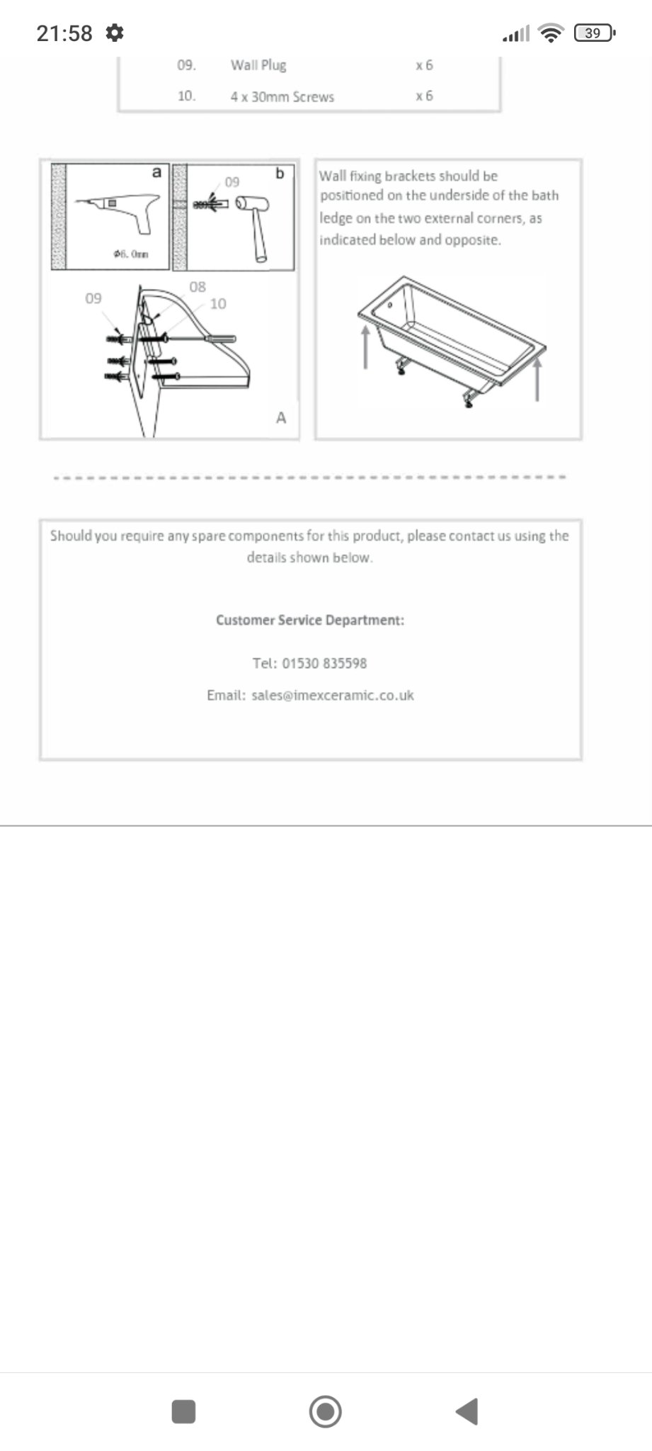

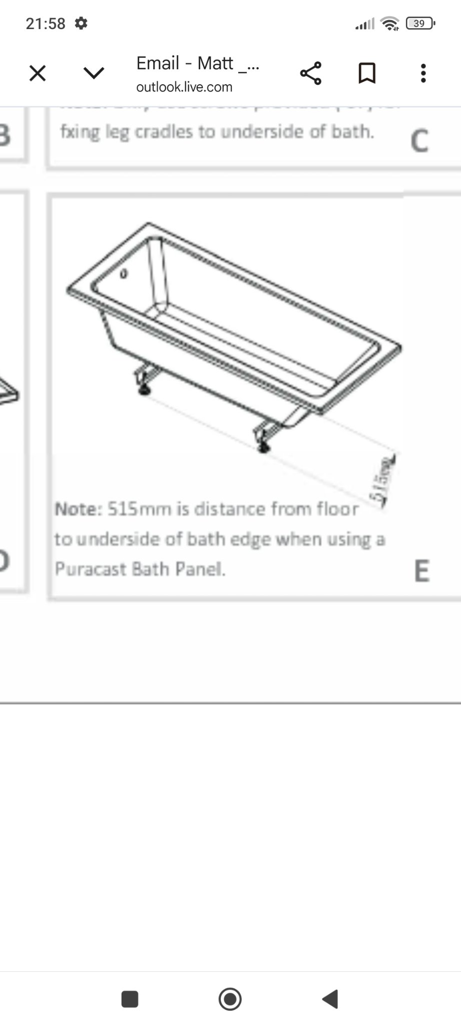

Anyone fit a bath with this type of brackets before? Do you drill the wall, plug and push bath in the screw clip to wall, if can reach in ok?

Fit the clips then lift the bath onto them. You could do it the other way, they are at the front corners, easy to reach.
If fit the clips first would there be enough players for the bath lip to push down on to them? I see what they feel like
They look similar to Twyford ones I’ve fitted previously, I just usually drilled them in place afterwards, never had a problem.
Thanks did you use a timber batten screwed to the wall to support the rest of the bath? Stopping the batten to give enough room for the clips at the ends
Not a full length of timber no, just a certain distance, thus allowing the clips to be fitted.
Thanks yes that's all I was planning on doing using a shorter piece of timbre so I could still use the clips
Never use them, just baton the bath along the long back wall and any wall it touches on the short ends, paying attention to the outside corners, leaving enough space for the bath panel.
