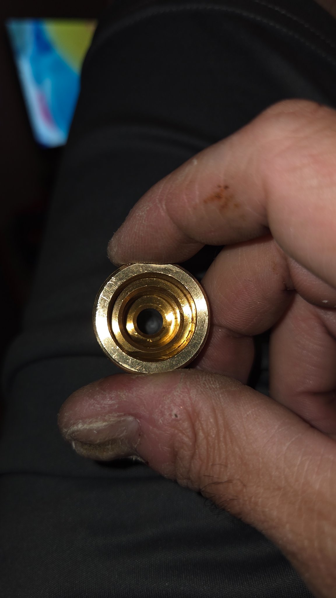

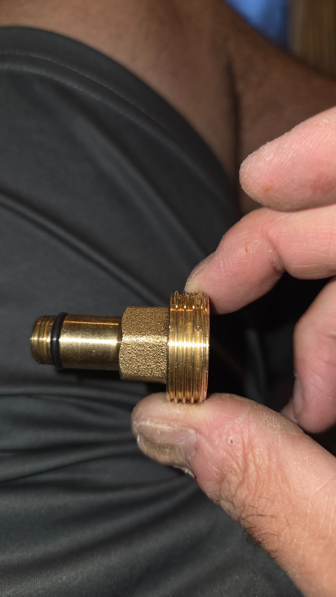

I have a bath filler and im really not sure its going to be decent enough pressure for filling a bath.
Its a scudo with valve. Lots of other oems using this design as well if it helps.
https://www.britishbathroomcompany....CAiD42nNu452Mj9p0VrKjbyW-sjHXt5N0mHOlFlQrE3d8
The pressure is slow and very poor on the cold feed with cold on 22mm dropped to a 15mm run with pegler isolator and then into a 3/4 15mm tap connector.
My gut here is the valve then has these on the connector with 8mm bore.
Am i on a hiding to nothing with this valve?

This is where you need to know your water pressure and water flow rate.
There are digital water meters but they aren't cheap.
You could fill a bucket and time it for flow rate.
