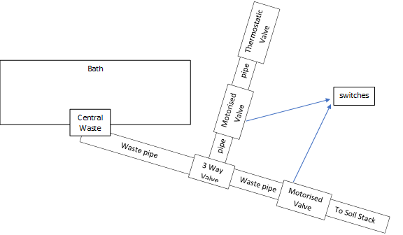

Hi all,
I have just purchased a new freestanding bath and am looking at filling & waste options. I have had a bit of a weird idea and wondered if someone could tell me if it was possible/sensible. I basically want to use the bath waste to both fill and act as waste (to minimise stuff in the bathroom.. i.e. floor standing filler/spout). My thinking would be that I could connect it something like this:
I know you can use the overflow as a filler, but you still need to get the water to that, which would be visible in my case (which i want to avoid).
Would appricate thoughts on whether this is possible/sensible. Im not sure of any back pressure issues that need to be considered.
The filling of the bath via the waste pipe will push the remnants of the last bath out of the U bend and into the bath.
Hence not sensible

Yes Danny Boy I am aware there are special "waste pipes" that are designed to fill a bath with clean water as well as draining it. It would appear that the OP is not thinking about such a device.
Perhaps you could be really helpful to the OP and provide details of the device in the video you posted

Been looking for that too... cant seem to find it anywhere.
Perhaps you could read my second post?
It is the Whisp, but not sure if it is discontinued. I might be minded to part with mine though as I do like my bubbles and there is only so many baked beans I can consume.. :D
