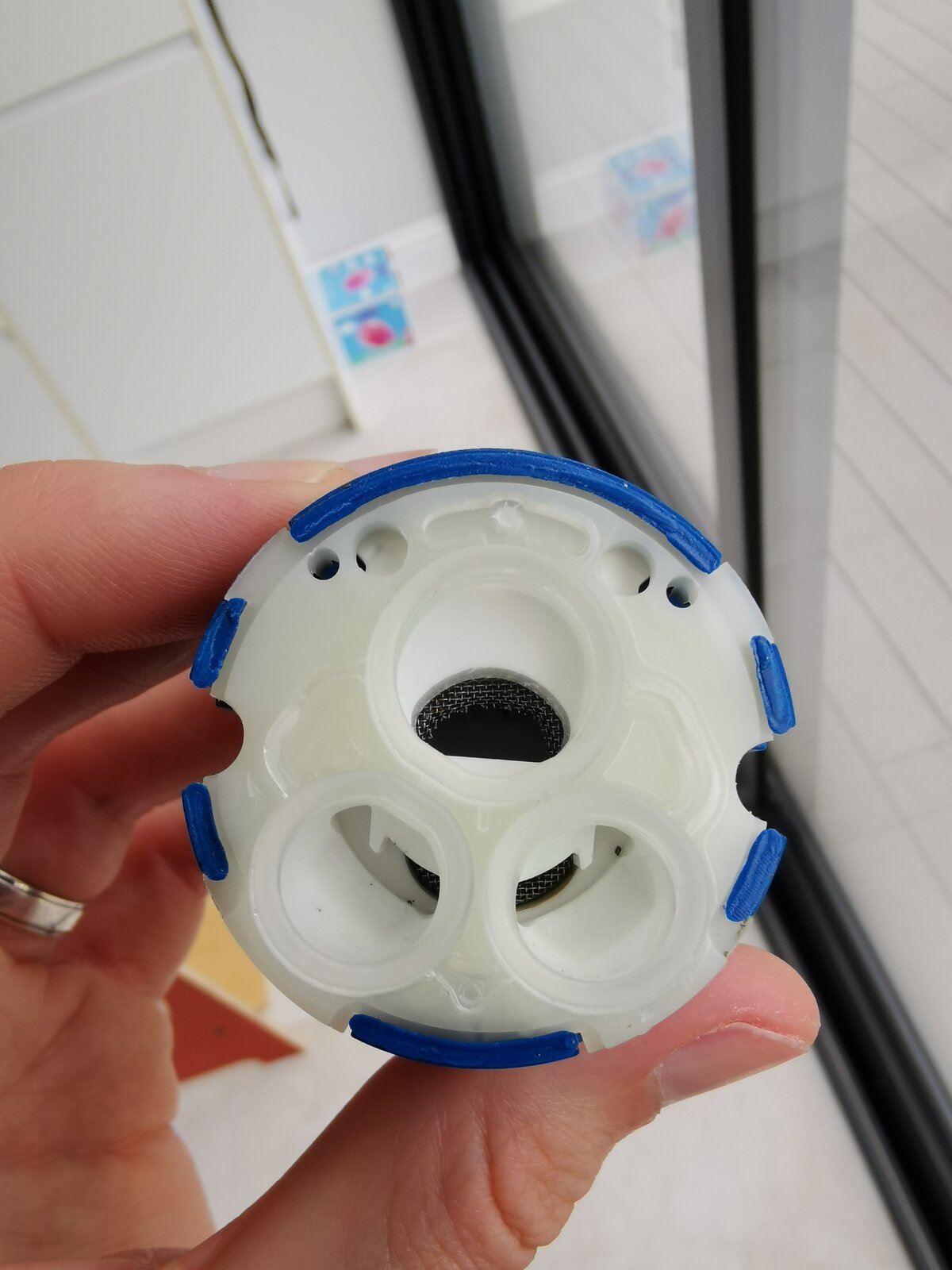

I took the mixer apart and checked the cartridge and it was all clean. The bathroom is less than a year old so wasn't expecting it to be that.

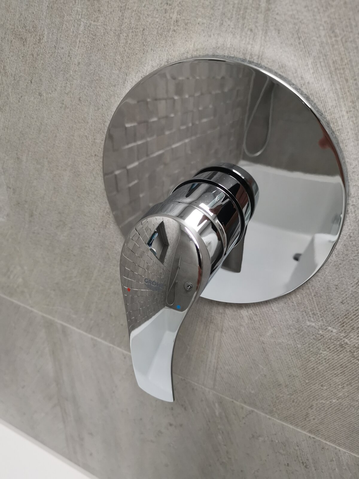

Ok and bath tap isnt ,that would be indicative of an issue with the bath tap. Is it a thermostatic mixer tap ? Show us a pic of it.
Below is a photo of the mixer. It is a Grohe 33963000 Concealed Mixer. It's not thermostatic. I took it all apart and there wasn't much crap in there just a few tiny bits of black stuff.

Does the concealed mixer do both the bath and shower. since its non thermostatic then possibly the cold water pressure is higher than boiler HW pressure and possibly reducing its flow rate although it would have to restrict the HW flowrate to a very unlikely < 1.5LPM to cause the DHW temp to rise to 80C assuming the boiler is modulating down to say 6kw??, if for some reason the boiler isn't modulating then the flowrate would only have to fall to 8LPM to avoid reaching 80C.
There should be non return valves installed at the mixer hot & cold supplies.
