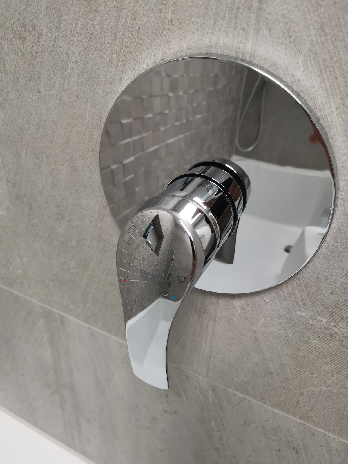

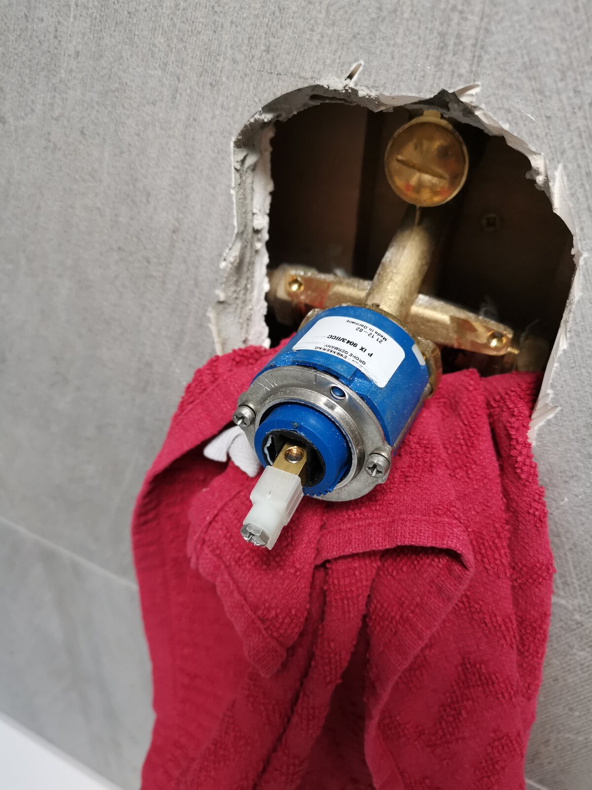

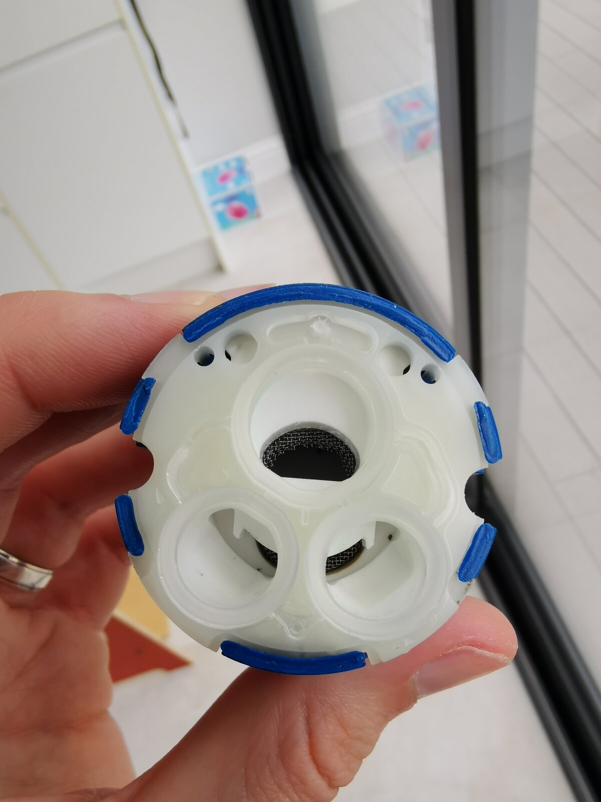

Below is a photo of the mixer. It is a Grohe 33963000 Concealed Mixer. It's not thermostatic. I took it all apart and there wasn't much crap in there just a few tiny bits of black stuff.
View attachment 311289View attachment 311290
I replaced all of the showers in the house with these simple mixers. Cartridges always fail and can be very expensive. I use a continuos water heater for the showers so we tell it what temperature it should be and it will never go higher or lower (flow rate might change)
